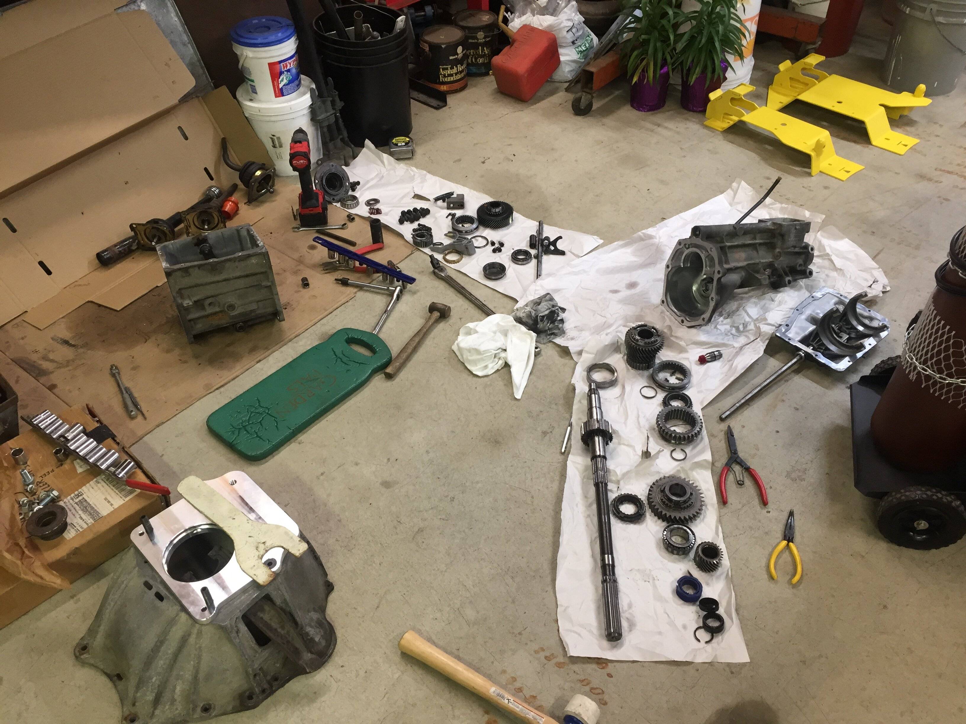

So here's the documentation of the weekend.
The unit is back together now, and apparently back together correctly. Fingers crossed. It took a day longer than expected. I started in earnest at about 8:40am Saturday and finished putting tools away at 8:20pm Sunday. I followed along with youtube videos of Paul Cangialosi with Eric the Car Guy, Paul Cangialosi's rebuild using G-Force gears, a digital copy of his rebuild book, and referenced Tremec's manual at least twice. I'll slap up some pictures and describe them:
Tear down was fairly easy. This was my second time having the box apart and my first time stripping it entirely. Never mind the big flat white wrench which went unused.

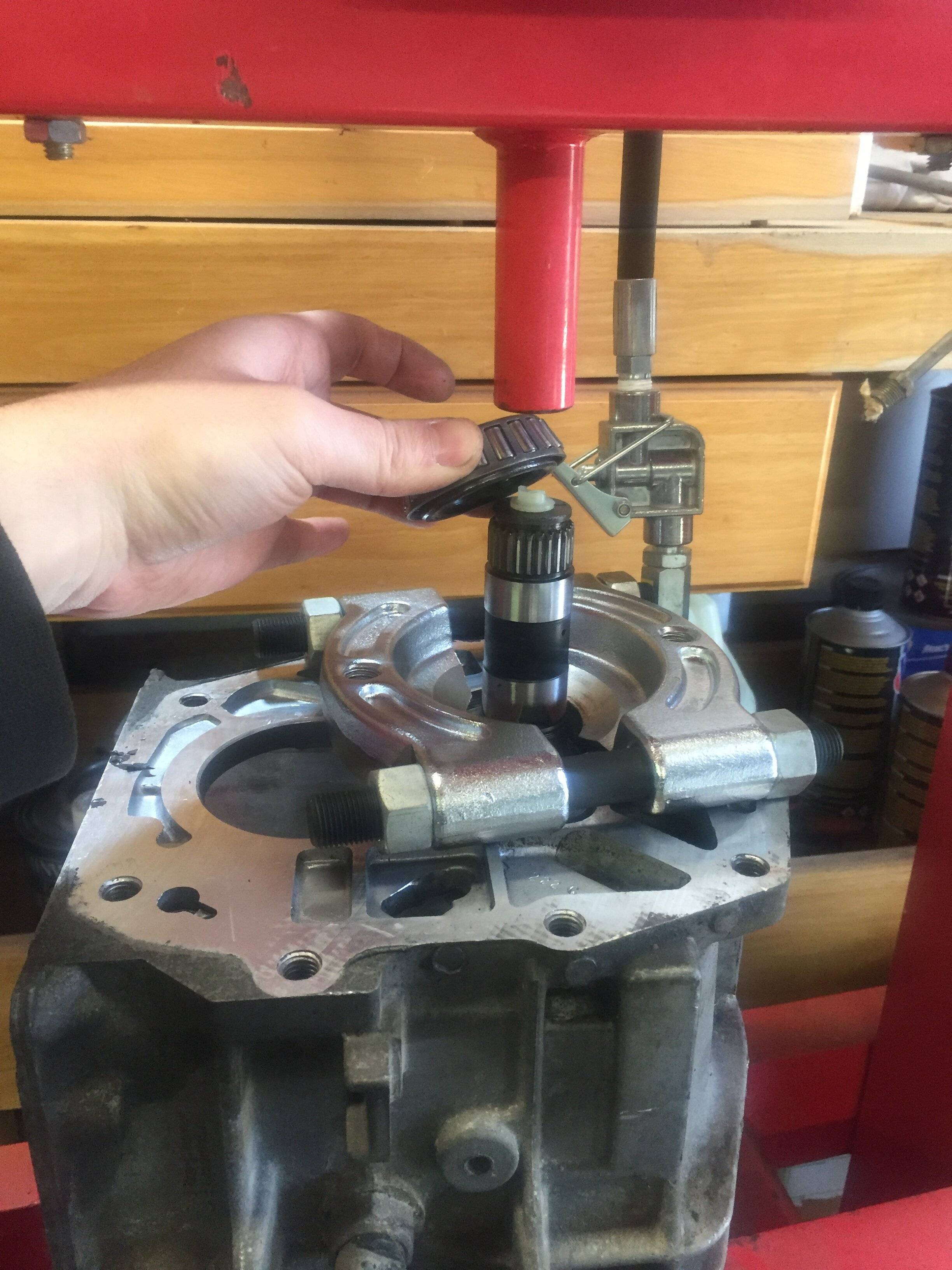

Having a press and a splitter is near vital to the process. I used it many times. But luckily even the tricky parts can be done by yourself. I won't go too far in-depth since there is good material out there for most questions.

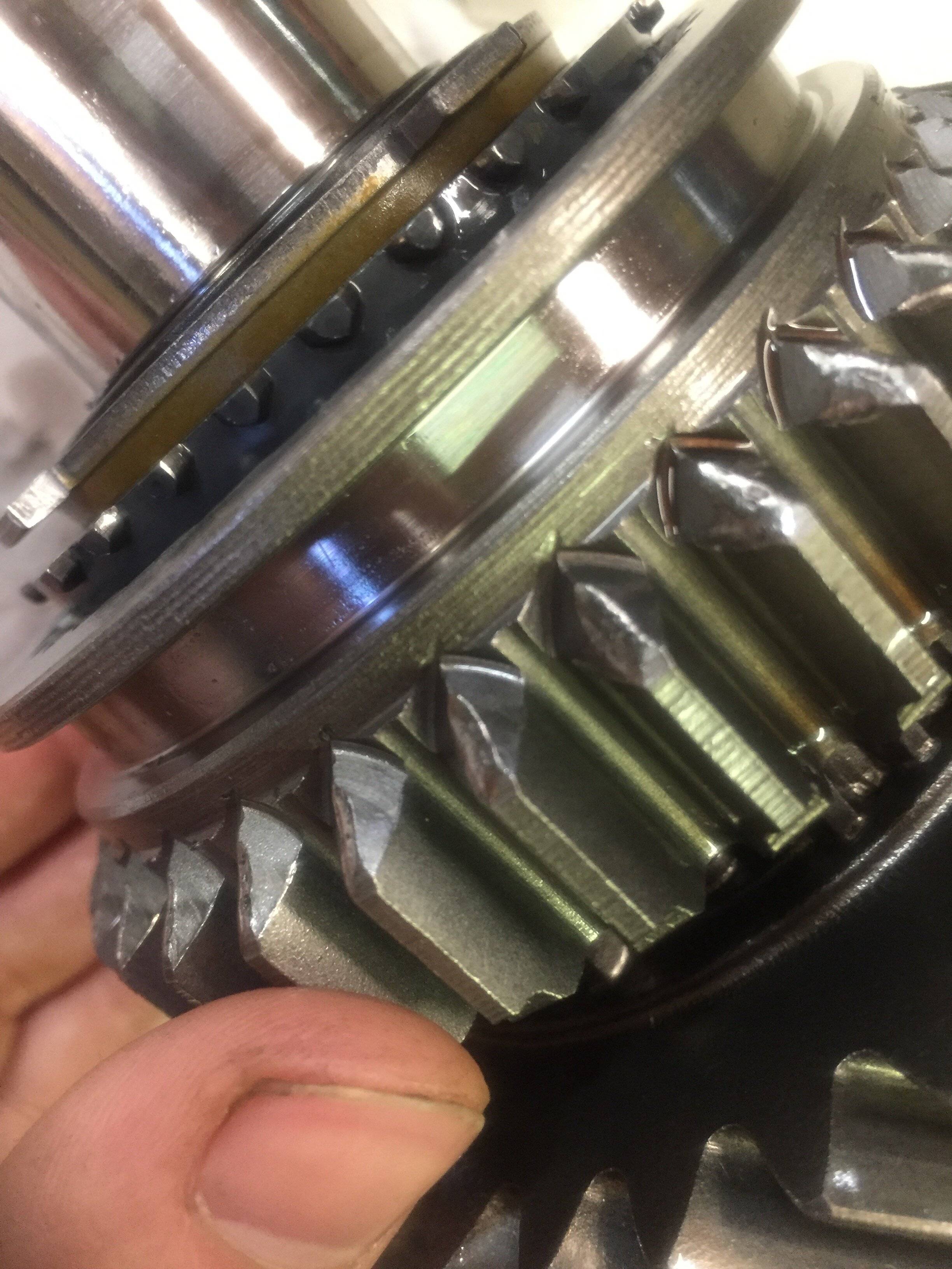

Really, the only thing beat up in this unit was the reverse gear, which is also the 1-2 slider. Hopefully I can get by with this. All other gears were fairly good.
View attachment 173631View attachment 173632

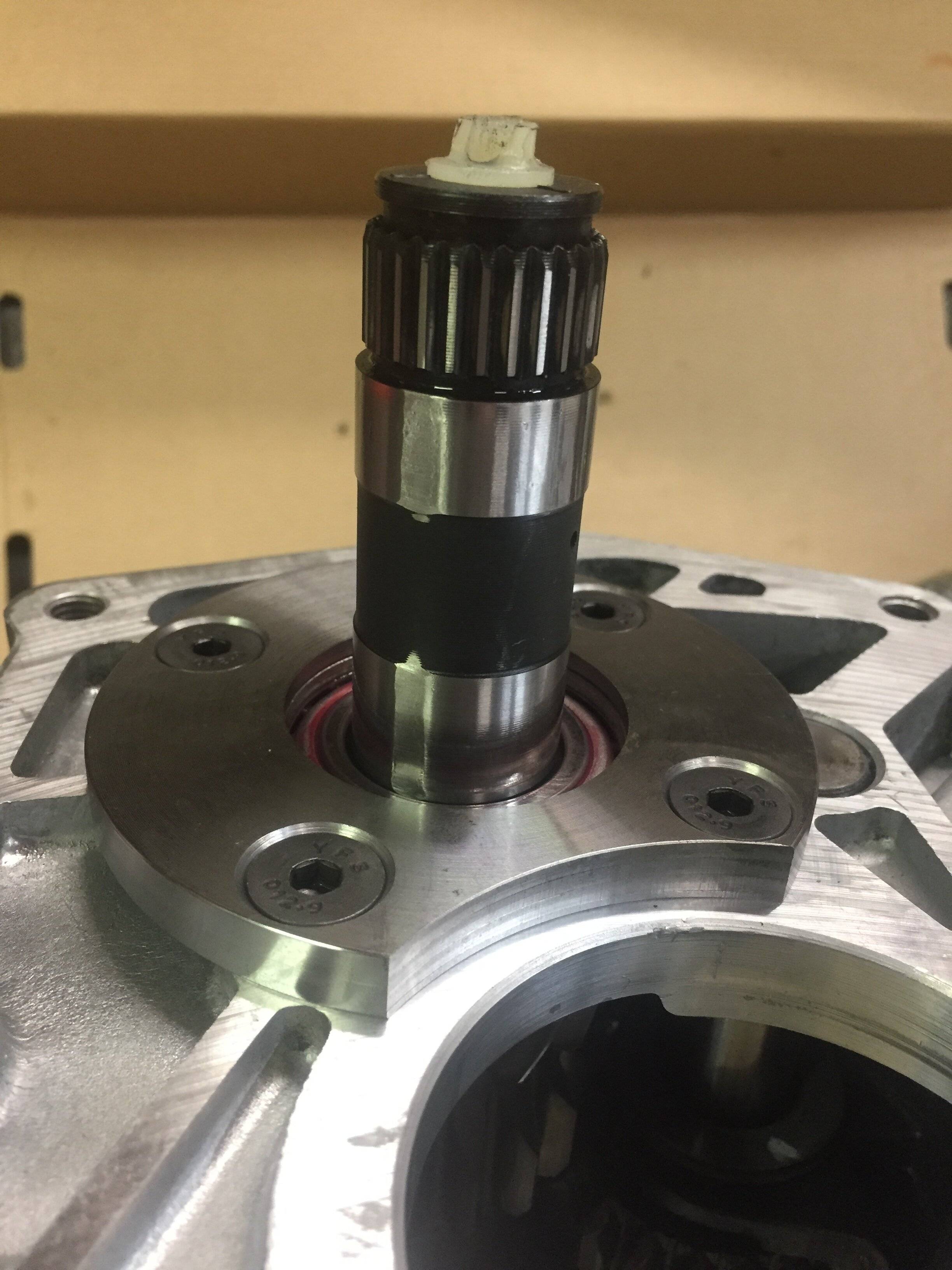

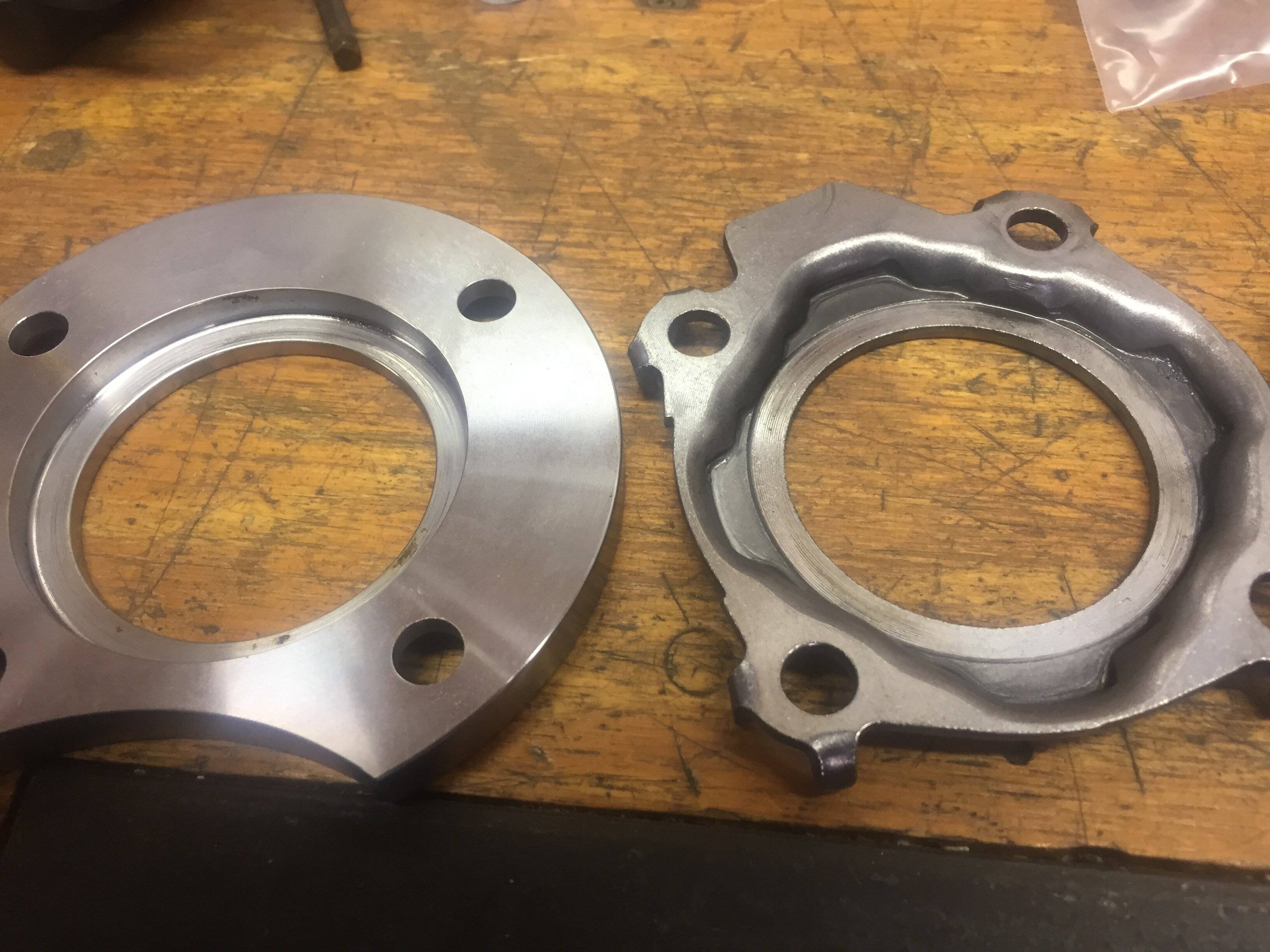

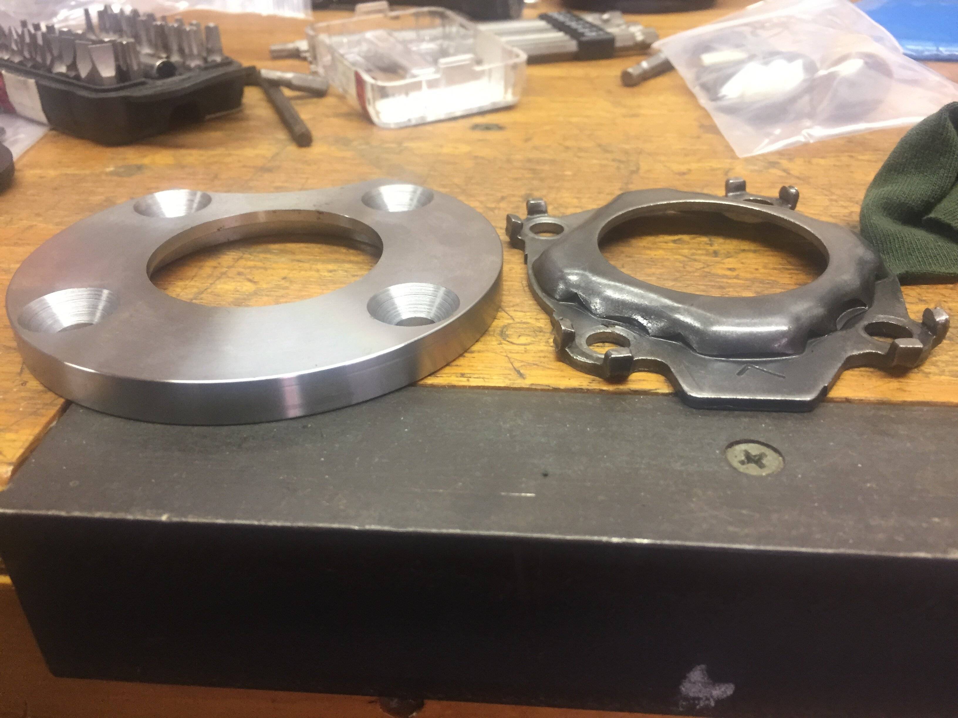

I did decide to get just a little fancy and go with a cluster gear support plate from Super661. It's steel and does a better job of supporting the rear bearing for the cluster gear.

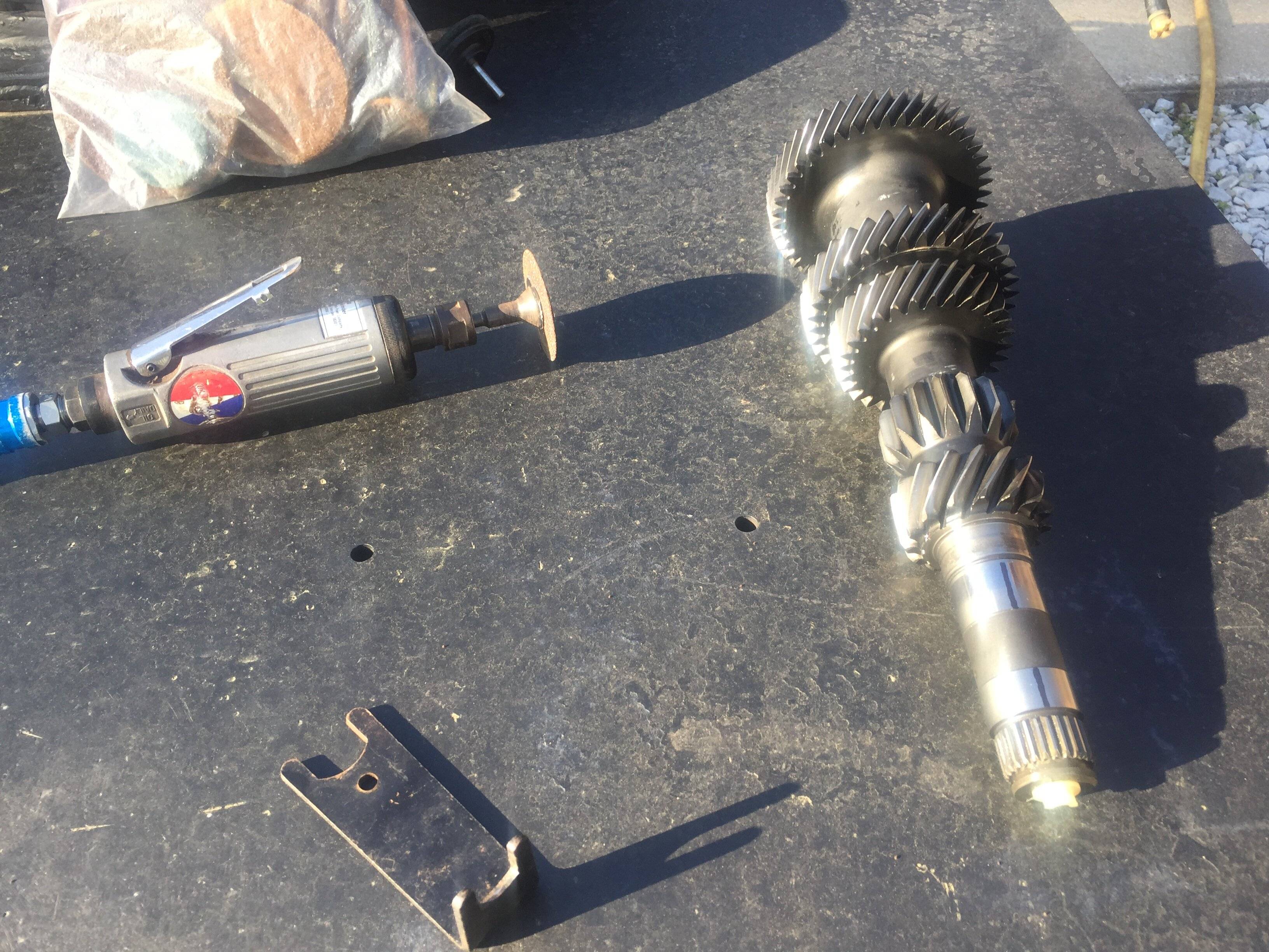

I got maybe a little too fancy and ground flats to help lubricate 5th gear, as seen in Paul Cangialosi's G-force T5 build video. These were done free-hand and on opposite sides, so 4 total.

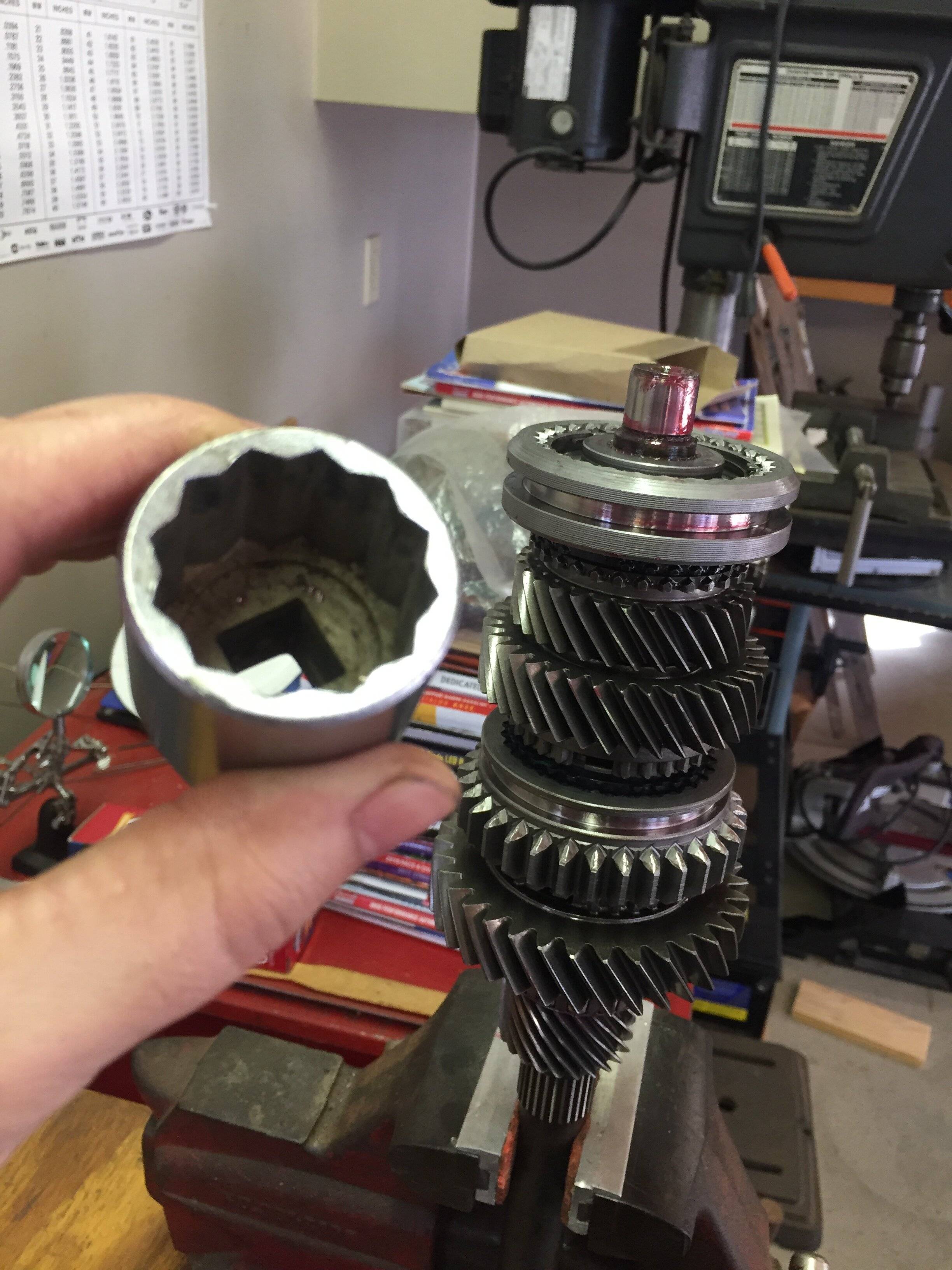

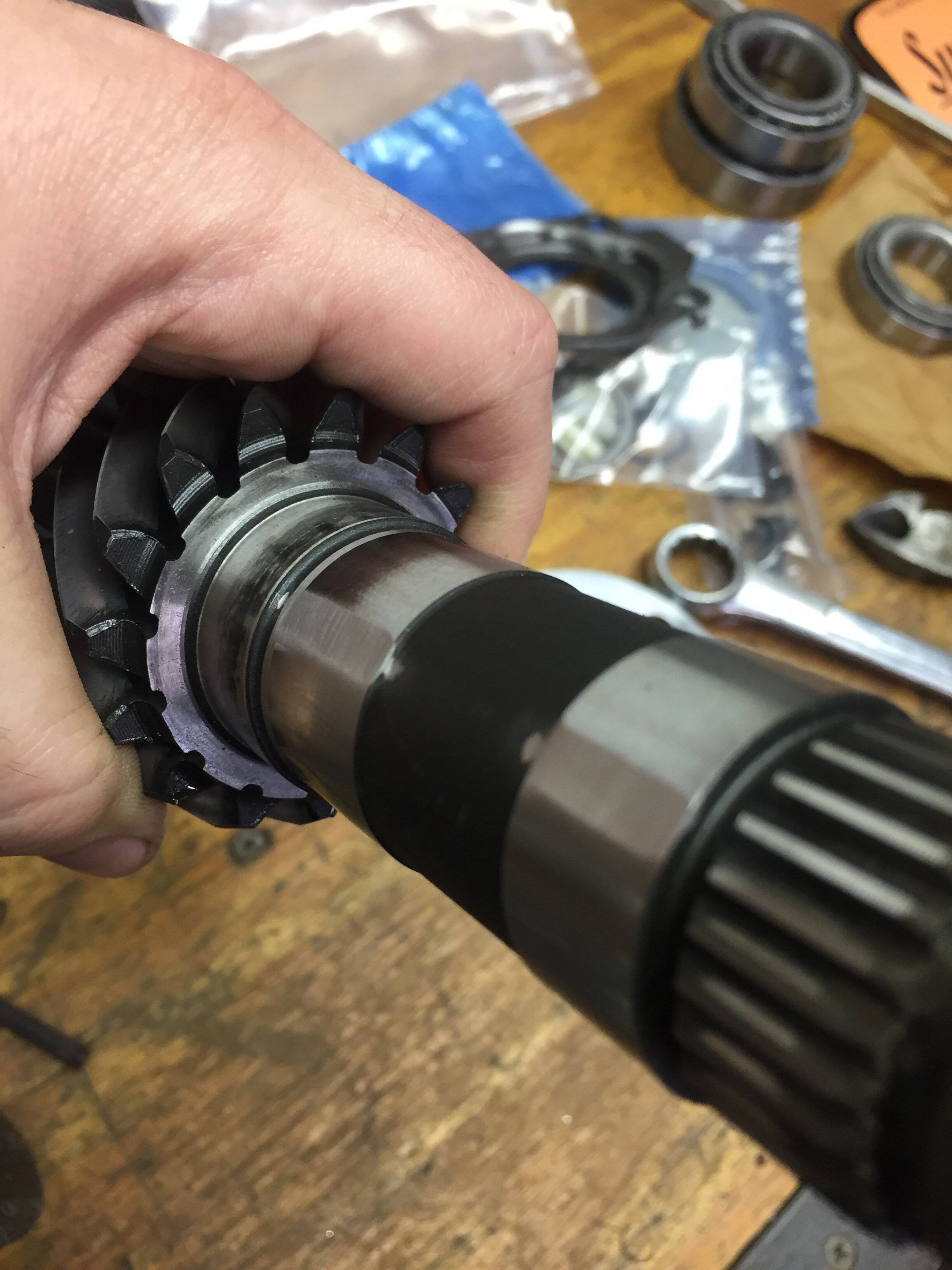

This is the only hang-up I had. My socket bottomed out on the shaft before seating the 3-4 slider, which I didn't find out until the trans was almost completely back together.
