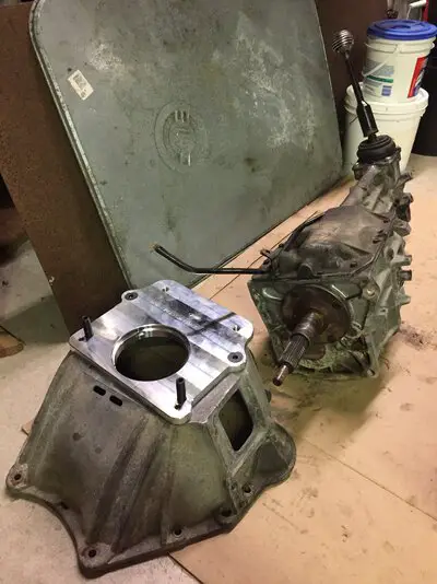

Slowly moving along in the afternoons. Got the flywheel back from the machine shop tonight. Freshly resurfaced. Yesterday afternoon I received my Hot Rod Works adapter plate and started installing it on my Firebird bellhousing which has been sitting around for years now. I cleaned the mating surfaces and made them smooth again, as well as cleaned the threads. Unfortunately, I had to clean up the adapter too! It's a great looking billet aluminum piece with included hardware and thorough color-printed instructions. But there were a couple burs in the threads that needed to be chased out, and one of the two 3/8 studs had to be run through a die due to bent threads binding in the aluminum. No big deal if you have the tools. Looks great. I need to clean up the transmission's face and mounting holes now so I can finish test fitting. Thus far no modifications have been needed to the input or bearing retainer after all. The instructions had stated these modifications, but I believe these are for non-GM units. (My unit is from a '94 Camaro.)
I'm going to try to give this trans the best chance of survival possible, so I'll be centering the bellhousing on the engine block when the time comes. As some may know, that involves a dial indicator connected to the crank. You run the gauge along the circular opening in the bell by turning the crankshaft, and check for differences. You split that difference using offset dowel pins on the engine block, and your trans should then be centered better.
So considering that process, I'm guessing I should do all of that with the adapter attached. You can't see it in my picture, but the engine side of that adapter actually has a circular flange that inserts into the big bore on the bell. So instead of the dial indicator riding on the bell, it'll ride on that circular flange of the adapter.

You hit the nail on the head about correctly indexing the bellhousing/transmission.
When I first bought my Monte,it was always known as being hard on clutches and the Doug Nash 4+1 5 speed.
I found this out after loosing an almost new Centerforce clutch.
Then I found out about how to index the bellhousing.Let me tell you this made a huge difference in longevity of clutches and parts !!
The same LuK clutch has been in use for app 15 years now and still looks good.
