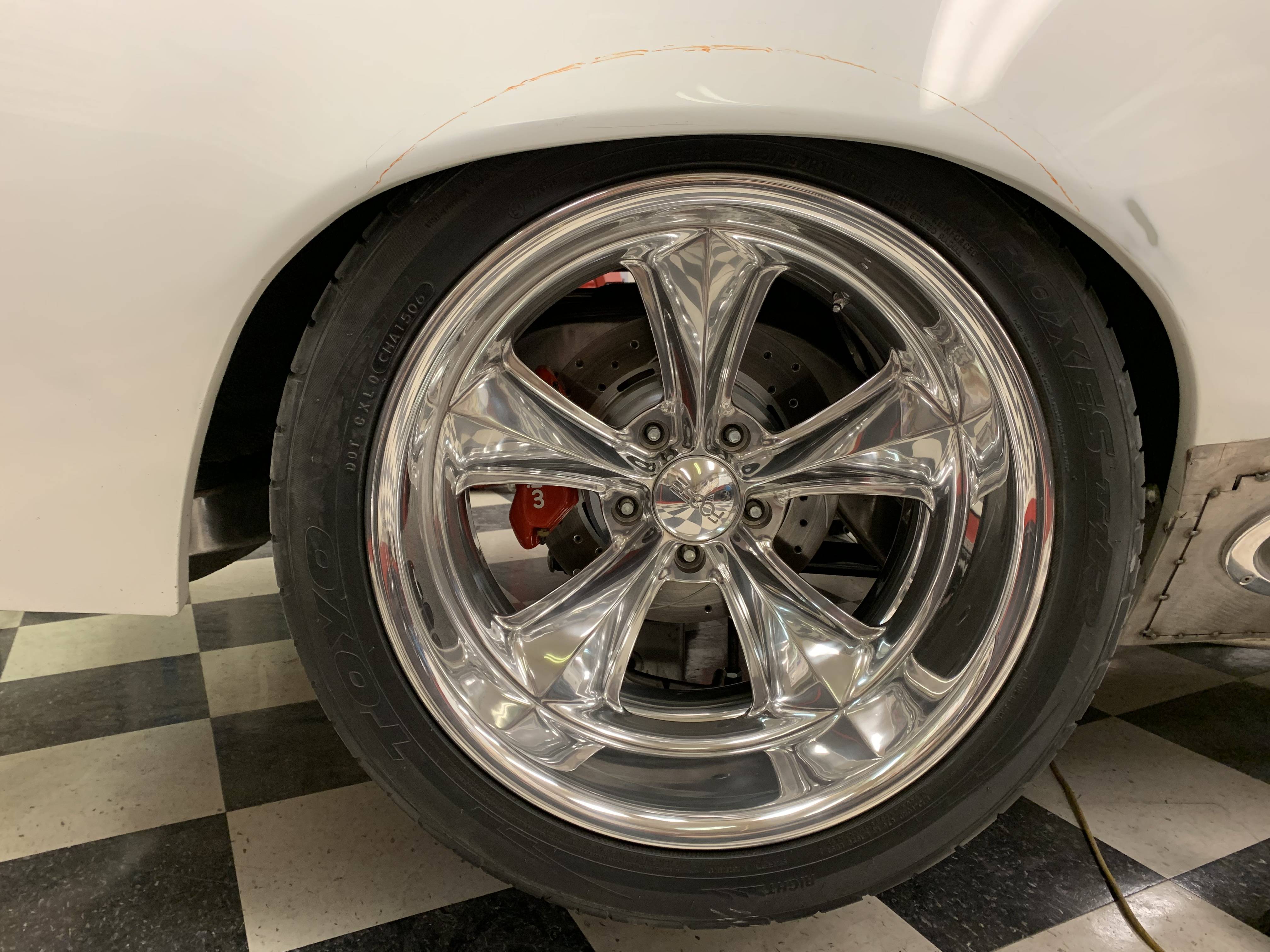

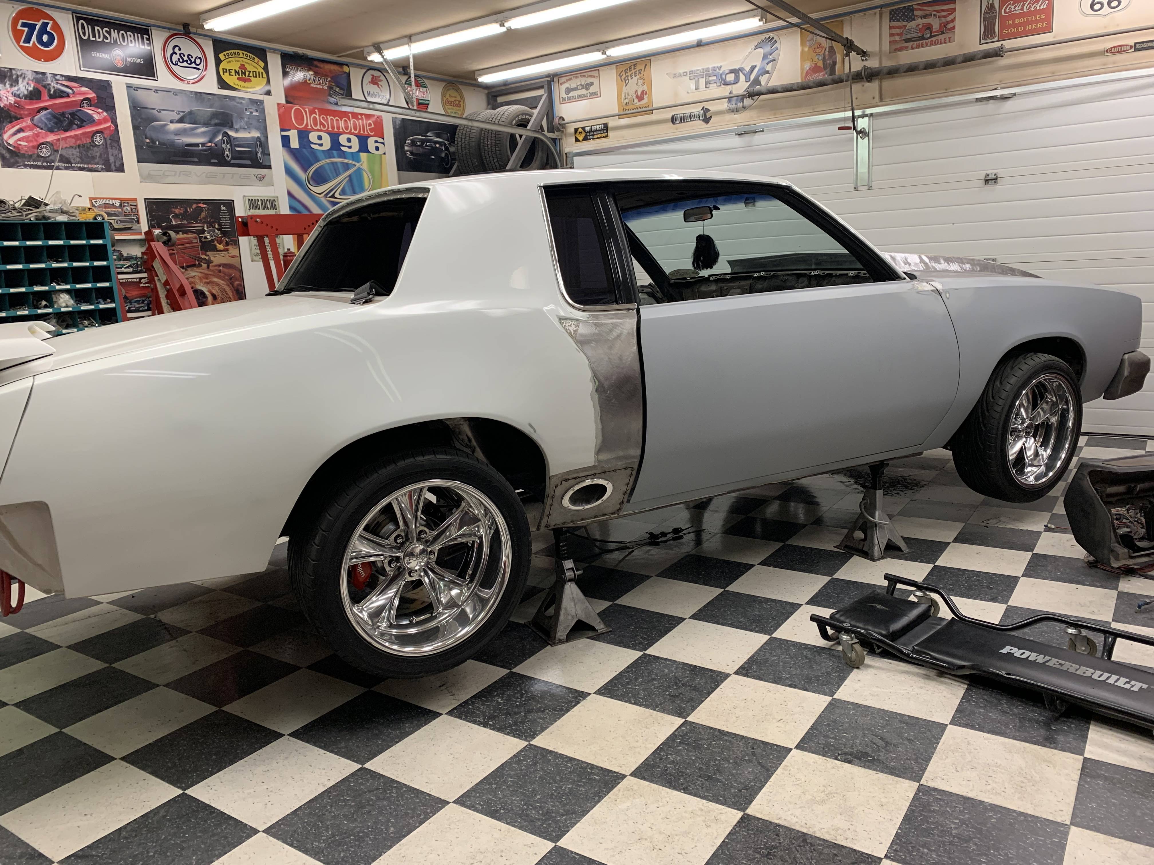

After removing the ‘bags and jacking the diff up as high as it would go and then setting it down on stands under the axle, I only gained maybe 1/2”, if that. So no, spending $1150 USD on rear Shockwaves to gain 1/2” lower is most certainly not worth it IMO. Good news is, now the axle sits on my cut-down bumpstops. So what I’ll do now is pick up another set of bumpstops and cut them down a 1/2” less so that the axle rests on them instead of the ‘bags. The rear wheels sit up in the quarters about 3” as seen in this pic with the outline traced on the quarter, that’s enough to tuck almost all of the tire when viewed from the side.
I still have lots of room inside the wheelwells height-wise to go lower, about 3” with my current wheel and tire combo, but far more things are going to start hitting other things long before that becomes an issue. No, we’re going to start getting into diminishing returns for the amount of work and cost required to get much lower. I’m only looking for a cool stance when it’s aired down, not a “laying rocker panels on the ground” lowrider.

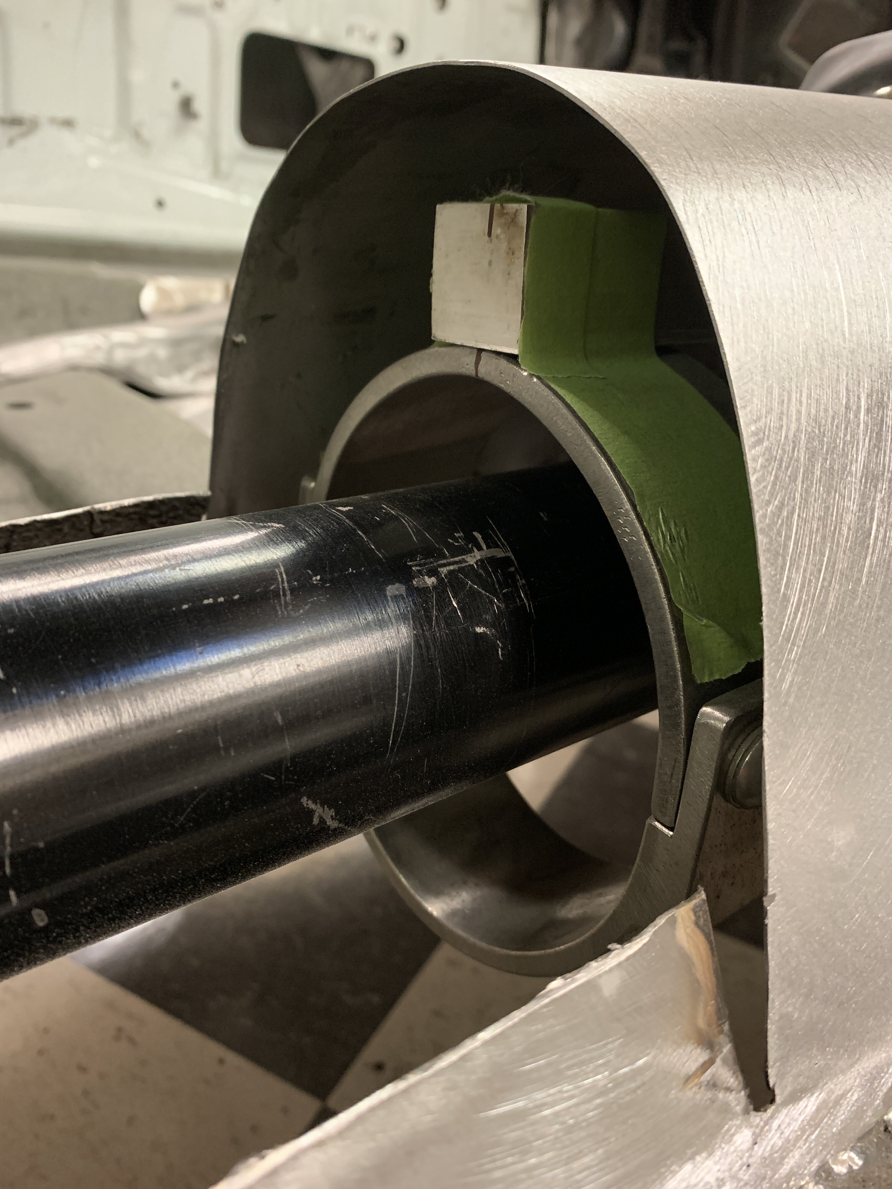

So yeah, that’s the rabbit hole I quickly went down investigating driveshaft clearance. Speaking of which, I am going to have tons of clearance at my rear firewall keeping the stock portion of it from the floor brace back. Even with as large as a hypothetical 4” diameter shaft. (Which I won’t need, looks like 3 1/2” will be more than adequate according to driveshaft critical speed calculators).

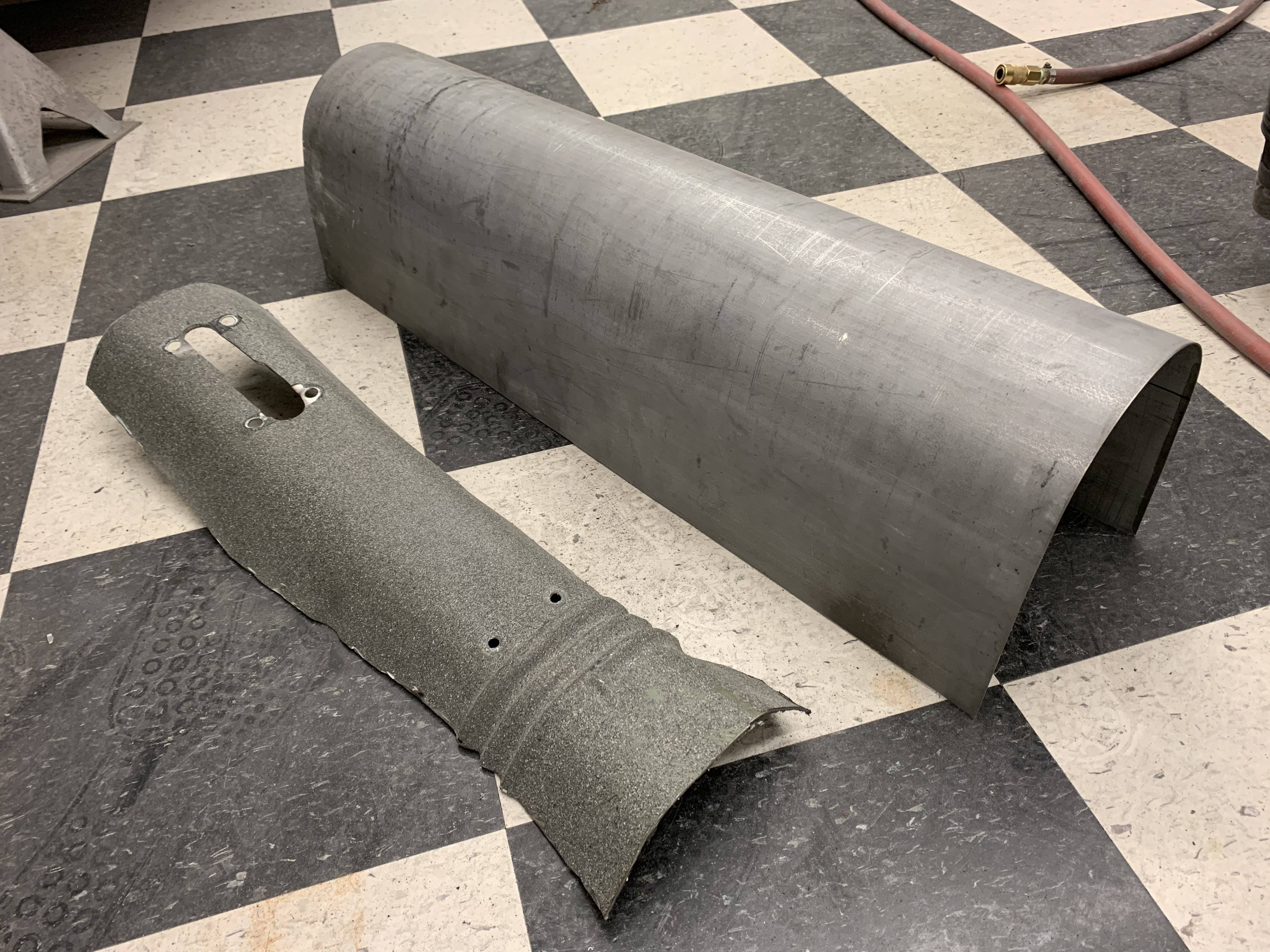

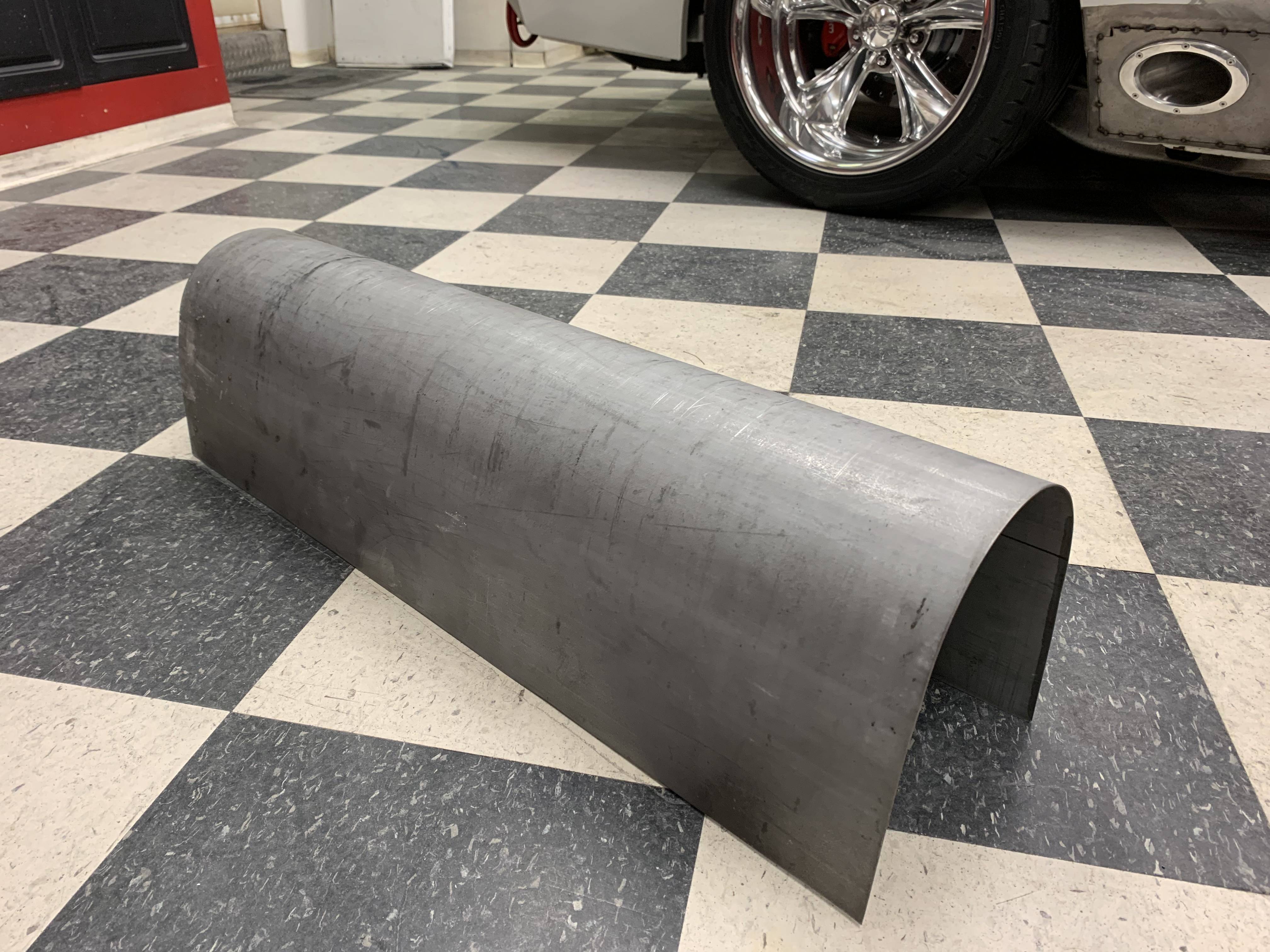

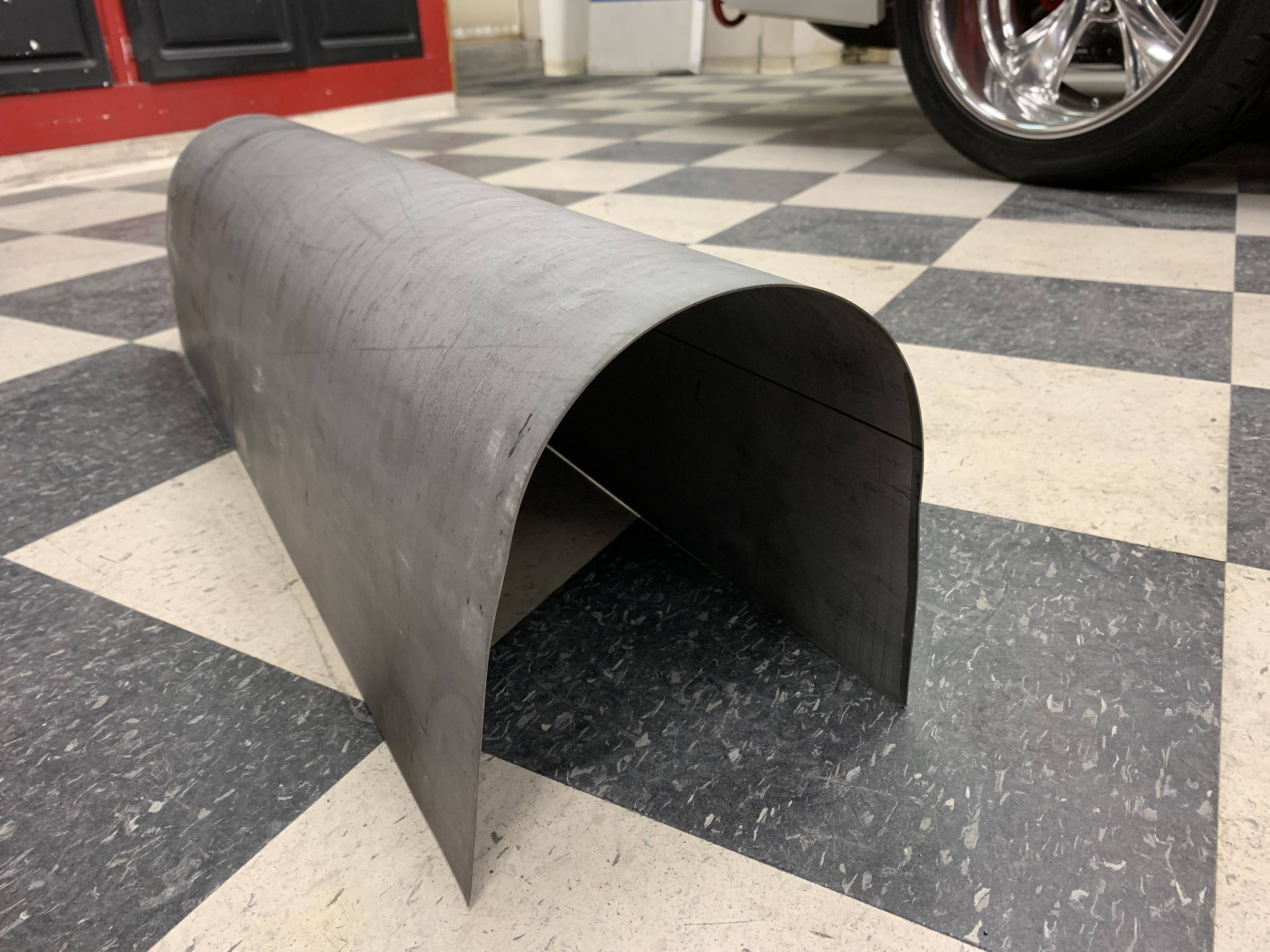

Mike was able to get the sheetmetal material I gave him run through the slip roll he has at his work, and it turned out beautifully.
I’m going to have WAY more room for a larger ‘shaft with this one vs the original.

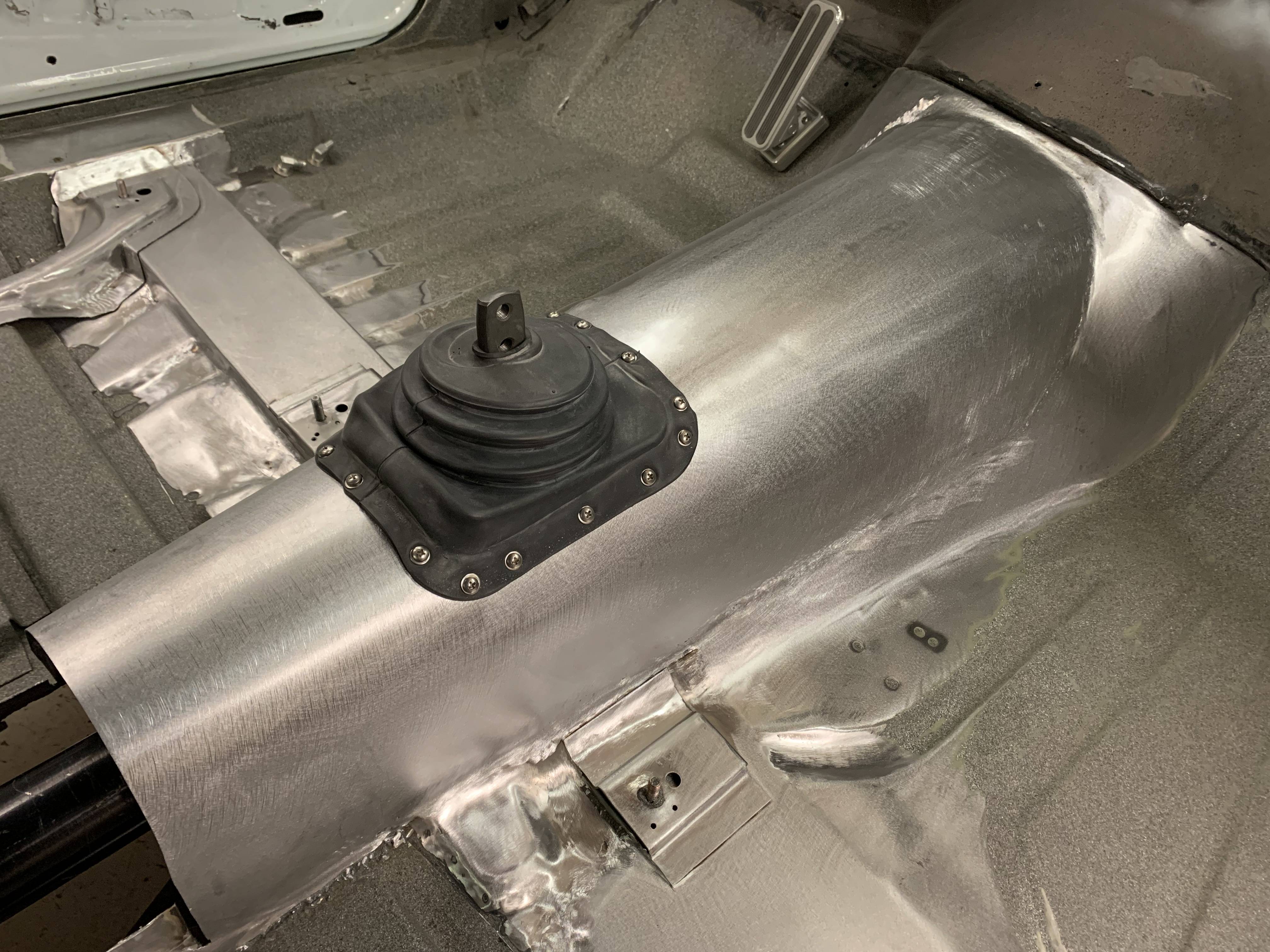

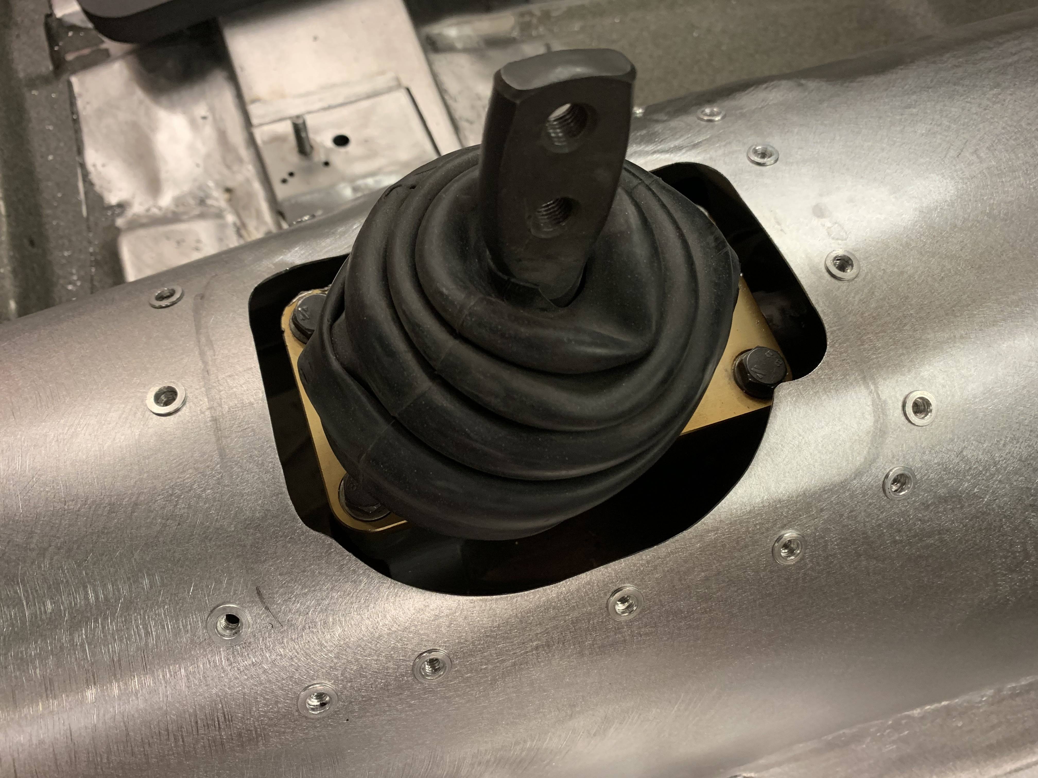

On the transmission tunnel side of things, once I got the car up in the air and was able to have a good look underneath, I was rewarded with nothing but good news. Absolutely everything clears, the tightest spot is between one of the shifter boot screws and the reverse lockout solenoid. Easily fixed by shortening the screws which stick out about 1/2”.
The new trans tunnel was more than well worth the effort.
I got some of the metal finishing done on the top and passenger side, it’s looking pretty good but I won’t be completely satisfied until I can hammer and dolly it out a bit.
As mentioned, the shifter boot is now attached, did it with nutserts and #10 x 32 stainless screws.
As for the transition between the transmission and driveshaft tunnels, I think I’m going to keep the height here where it is. The top of my driveshaft safety loop is going to be too close to the top of the larger driveshaft when it’s aired down, so I’ll keep the height of the trans tunnel where it is and make the top half of the loop taller.
Hell, I might even have to make the entire loop a bit bigger, but I’ll worry about that when the time comes.

And as for clearance inside the tunnel now? Plenty of room for larger driveshaft activities now! Overall I’m pretty pleased with how this is all coming along, and with the rate of progress.
