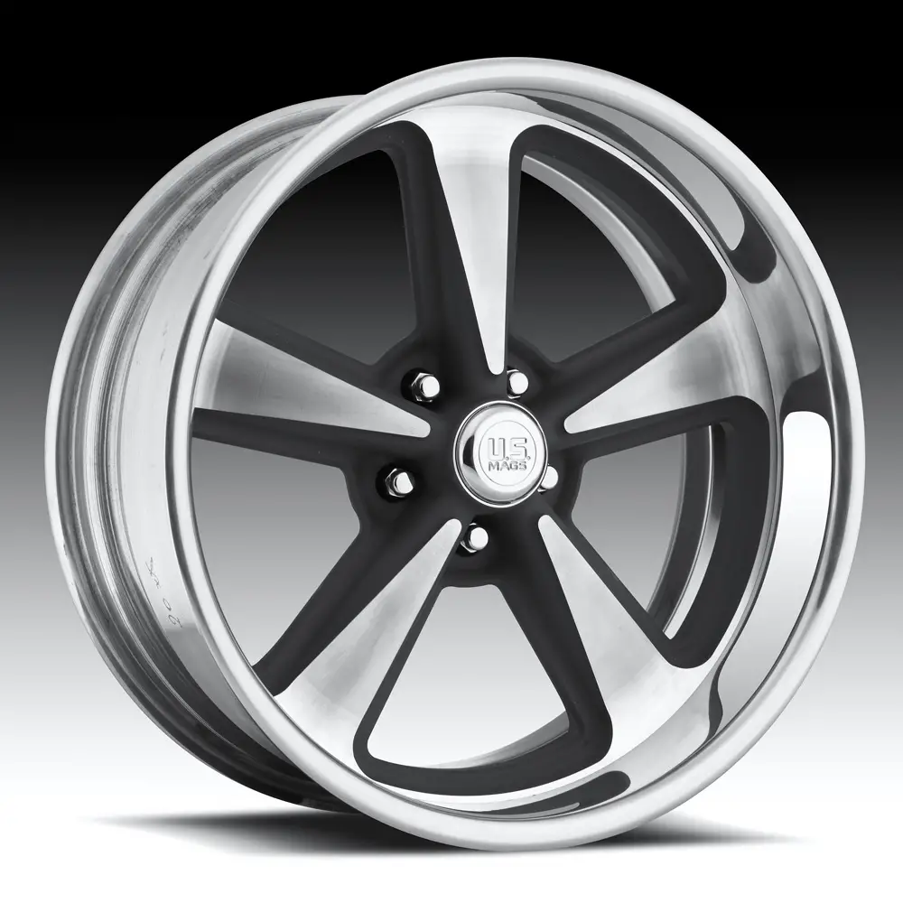

Wow the cutlass looks awesome with the us mags! I almost bought the same wheels a month ago for my 87 cutlass but went a different direction....what are the specs on those wheels and tires?
Thanks the specs on the wheels are
18x8 4.5bs front
18x9.5 5.25bs rears
Rears won't fit without a notch. Rear tires I have on right now are 255's. I had them so I used them. I can probably get away with a nice 285. What wheel did you go with?

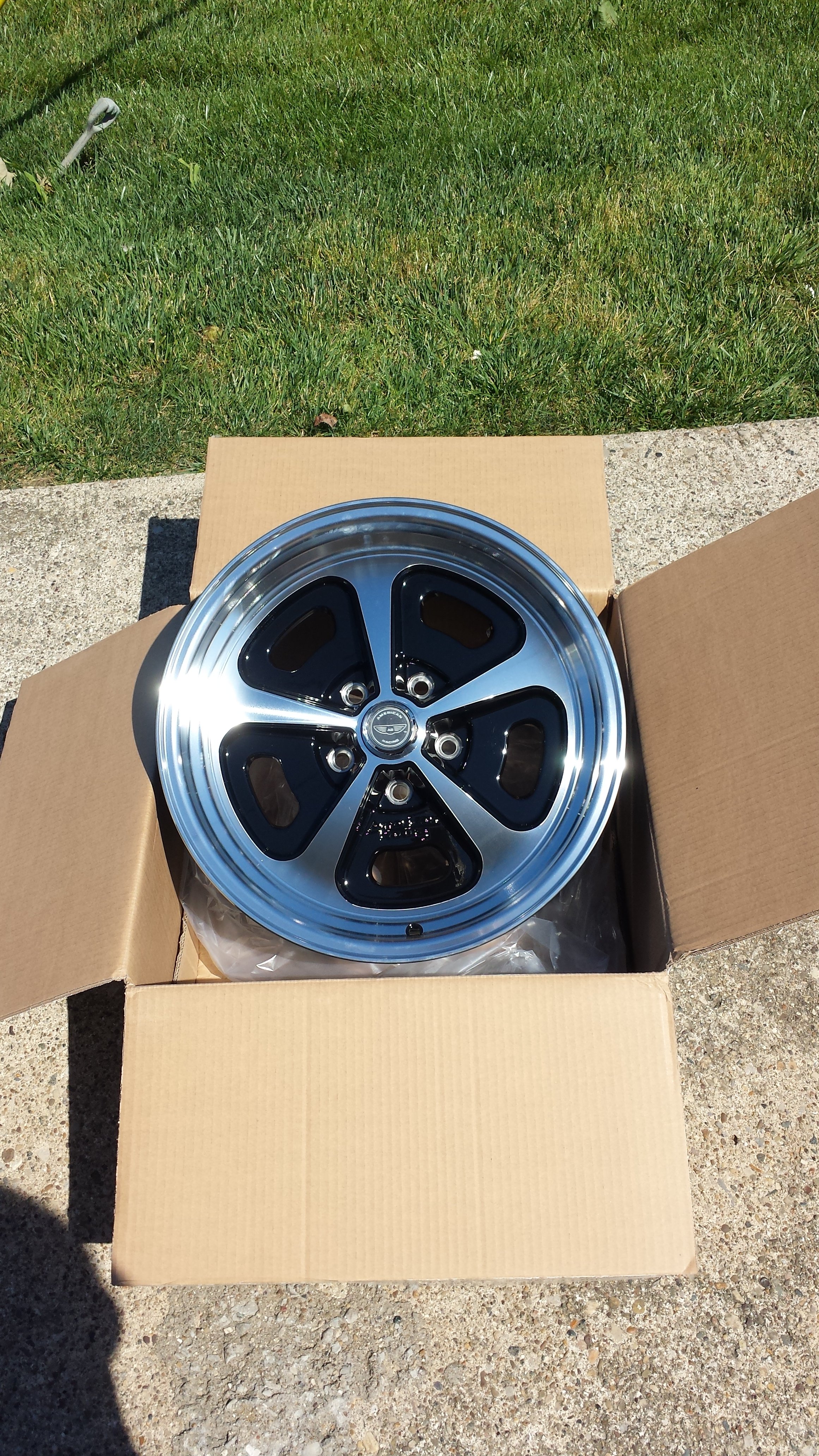

Ended up getting(actually just got the rears today and fronts on monday) american racing vn501's. Love the look of my factory 14" rallye's but wanted bigger for more options down the road.
17x7 front 4" bs
17x8 rear 4.5"bs
Probably gonna run a 225/50zr17 front and try to squeeze a 255/45zr17 rear. No frame notch....might need a small spacer.
17x7 front 4" bs
17x8 rear 4.5"bs
Scott.View attachment 51692
Haha what a coincidence I was looking at a similar wheel. But they didn't offer a wide enough wheel that would make my notch worth while lol. Those will look great
US Mags Bandit is what I was going to get
That's hilarious....i really considered the bandits as well! I think i started off with 20ish wheel styles in my budget then narrowed down from there. At one point i had probably 5 or 6 screenshots of my car using a wheel visualizer program to make the right choice!
