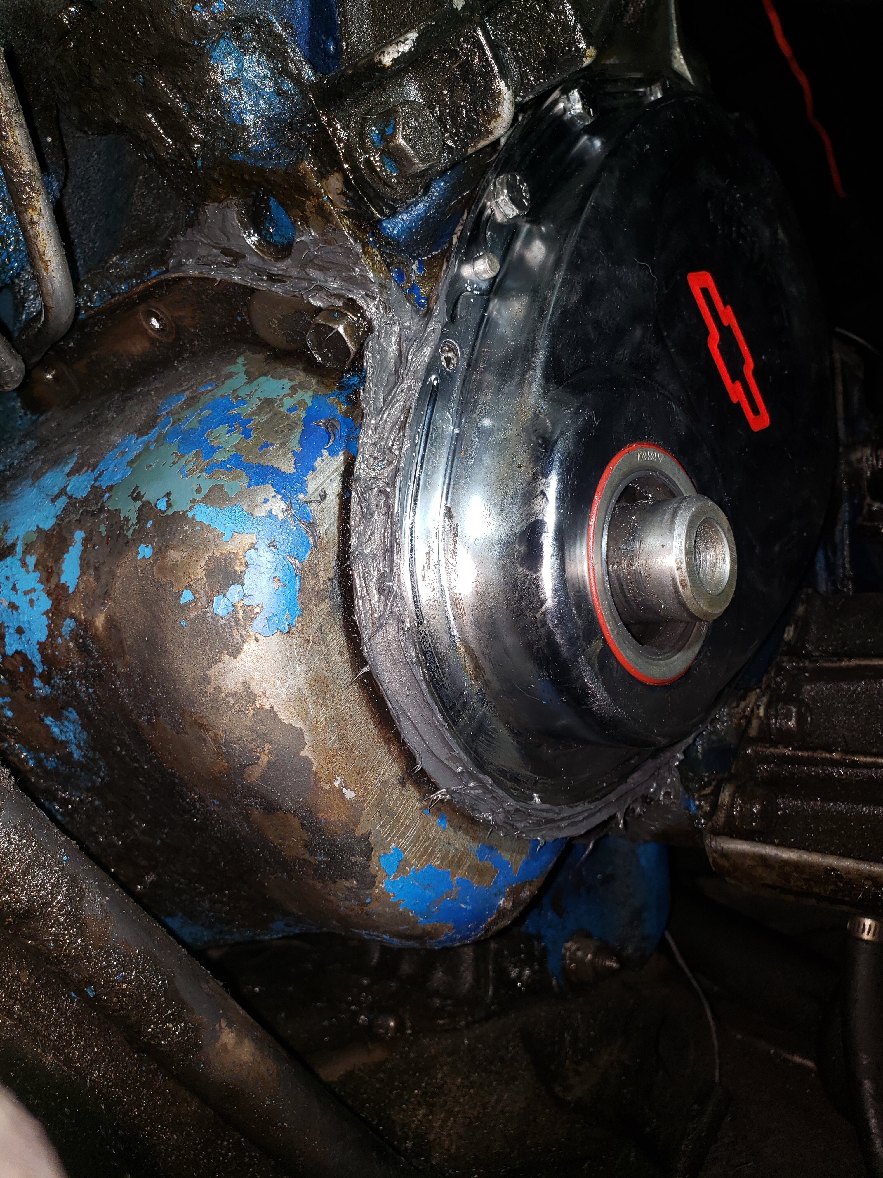

Looks like I did a better job installing the timing cover than the last guy did...
Looks like it wasn't even in all the way compared to my job...
