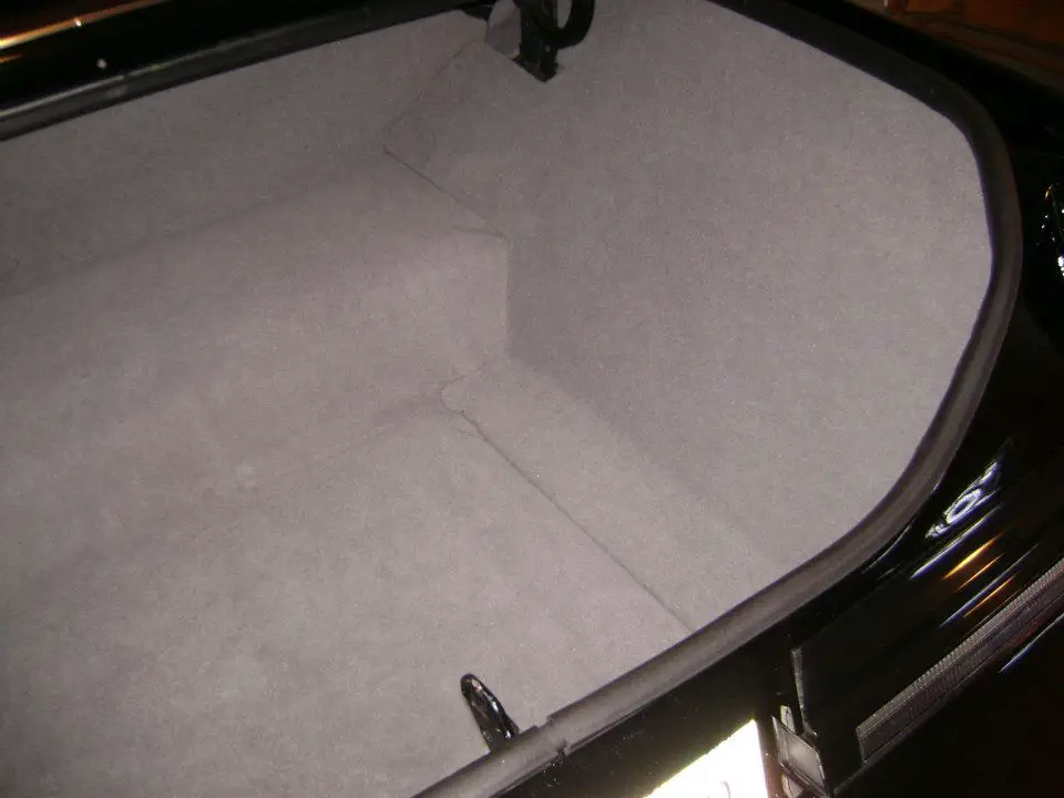

Not sure if you are looking for a factory kit carpet but I have the 9 piece trunk kit from GBP and it looks pretty nice. It took a little figuring out to install it, and the fit isn't 100% perfect, but it still looks pretty good and I'm happy with it. This one isn't mine, but it's the same kit. I got mine in claret to match the interior.
Looks good are these pieces sturdy? Is the carpeting glued onto particle board or something?
I really like the way it looks. They are glued on to a backer board of some kind. They aren't really sturdy, but they wouldn't be hard to stiffen up by gluing a furring strip or even a piece of aluminum angle or thin bar stock to the back. Im probably going to do something like that to try and stiffen the boards in my trunk up a little.
