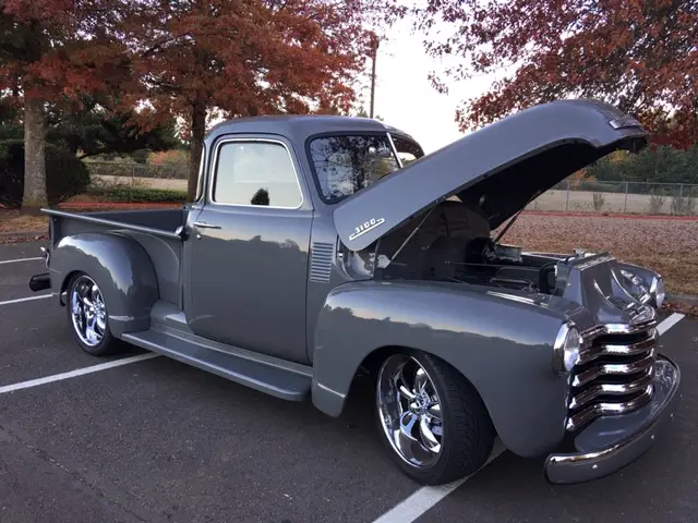

When you're building custom cars or trucks it's easy to get a part that doesn't fit or work quite like you thought it would. Prior to this car I built a '51 Chevy truck(see photo below) and I lost count of all the times it happened. I have had 3 different engines, 2 rear suspension and rear end setups and 2 different front brake setups on there. If you expect every thing to go perfectly the first time, this might be the wrong hobby.
