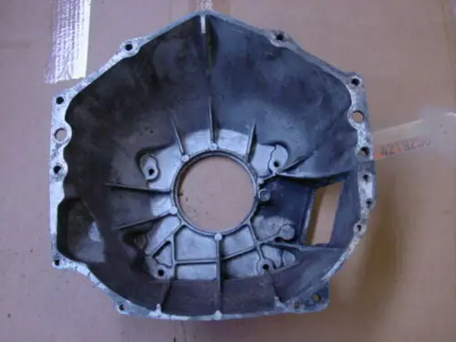

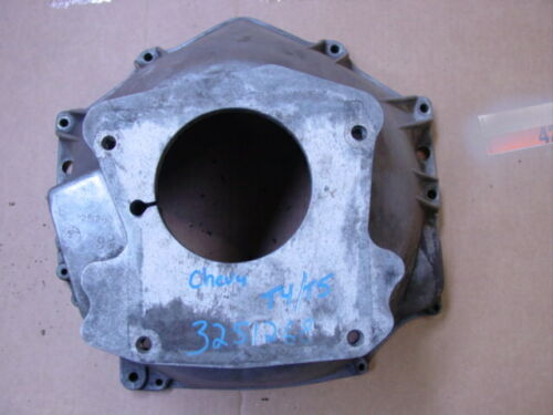

The 2.8 has the front drive bell housing pattern. This is the 2.5 bell housing which has the V8/90 degree V6 patternCherokees also used the 2.8 V6.
Isn't the '80's/'90's 2.5 simular/same as the Vega/Monza 4 bangers? I know those also had the Chevy bellhousing patteren.I had read awhile back, that the 2.5 bolt pattern was the same as the sbc. I had read that online, so wasn’t sure how to take it until now.... very informative!
It looks like the bolt pad locations for the GM dog-leg rectangle pattern are there, but some careful drilling and tapping is required.The 2.8 has the front drive bell housing pattern. This is the 2.5 bell housing which has the V8/90 degree V6 pattern View attachment 123237 View attachment 123238
Use a mini starterthose bellhousings might bolt onto a SBC but it doesn't look like SBC starter nose would fit in the bellhousing
