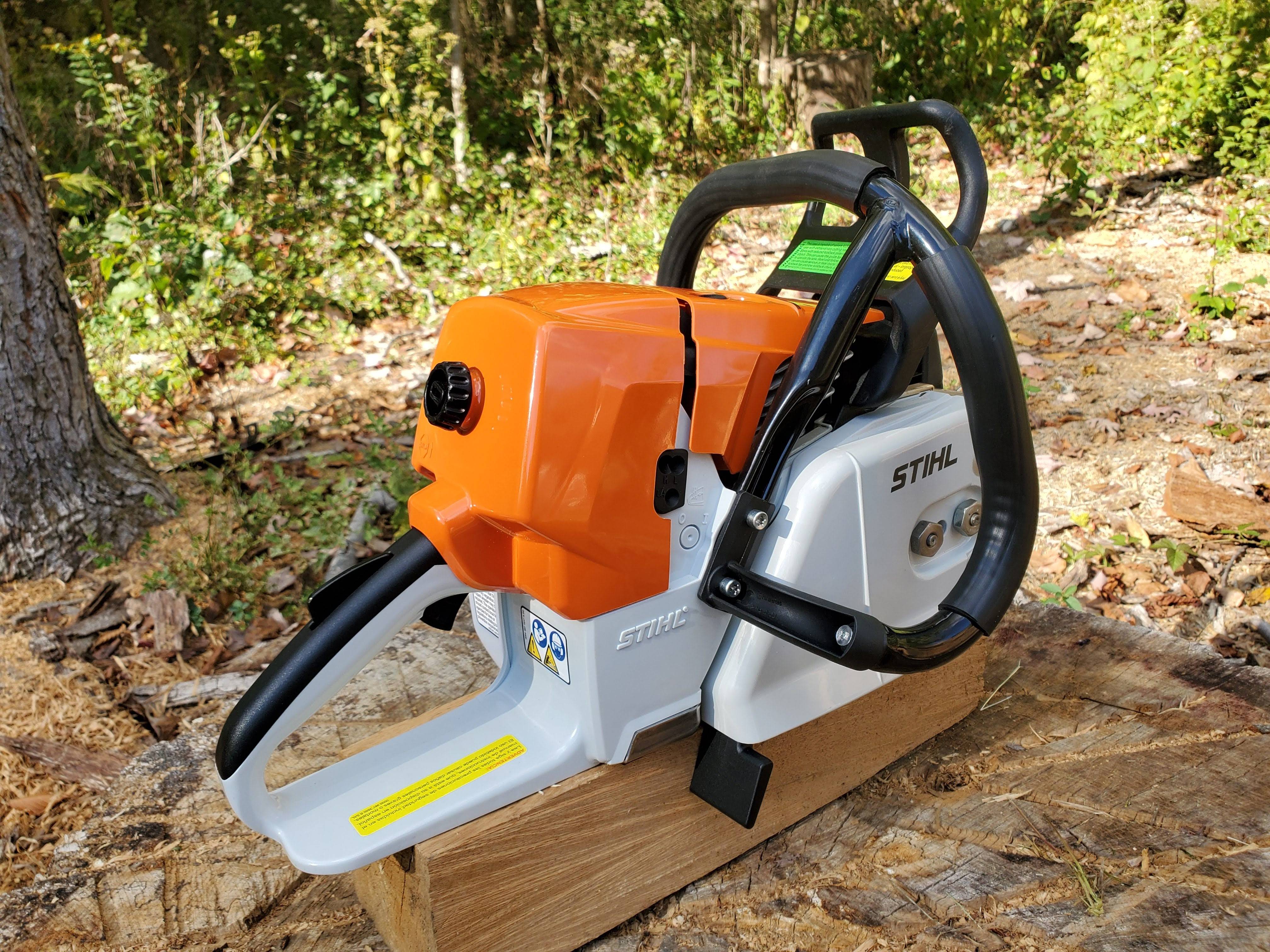

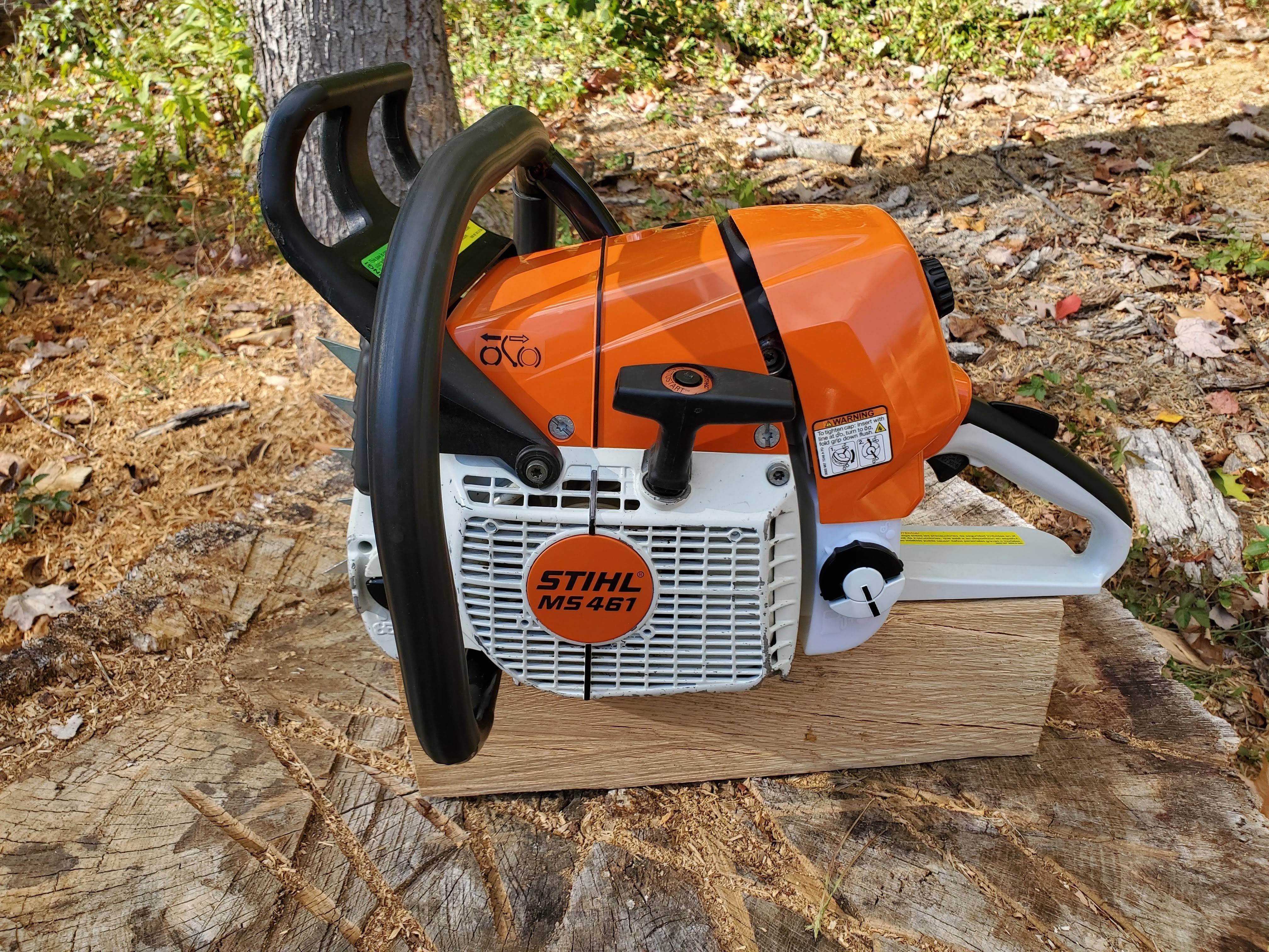

It was a beat up tree service saw. Had good internals, but it was ugly. I got new plastics for it and it looks 10x better. I don't use it much but they are becoming scarce so I hate to get rid of it. IMO these are one of the best saws Stihl ever made.
Also I'm super leery of Chinese copy parts but the wrap handle has been great and the clutch cover is a solid piece.
I have a brand new 25" ES Light bar if you are interested.

Where did you find the new plastics?

The plastics are new OEM from the dealer, but I have a hookup so I get them a little lower than full retail.
The 461s are really well made solid saws. They use classic Stihl construction, so they are easy to work on and they are probably the last non-m-tronic carbed saw of their size that Stihl will ever build. They aren't light but they absolutely rip.
