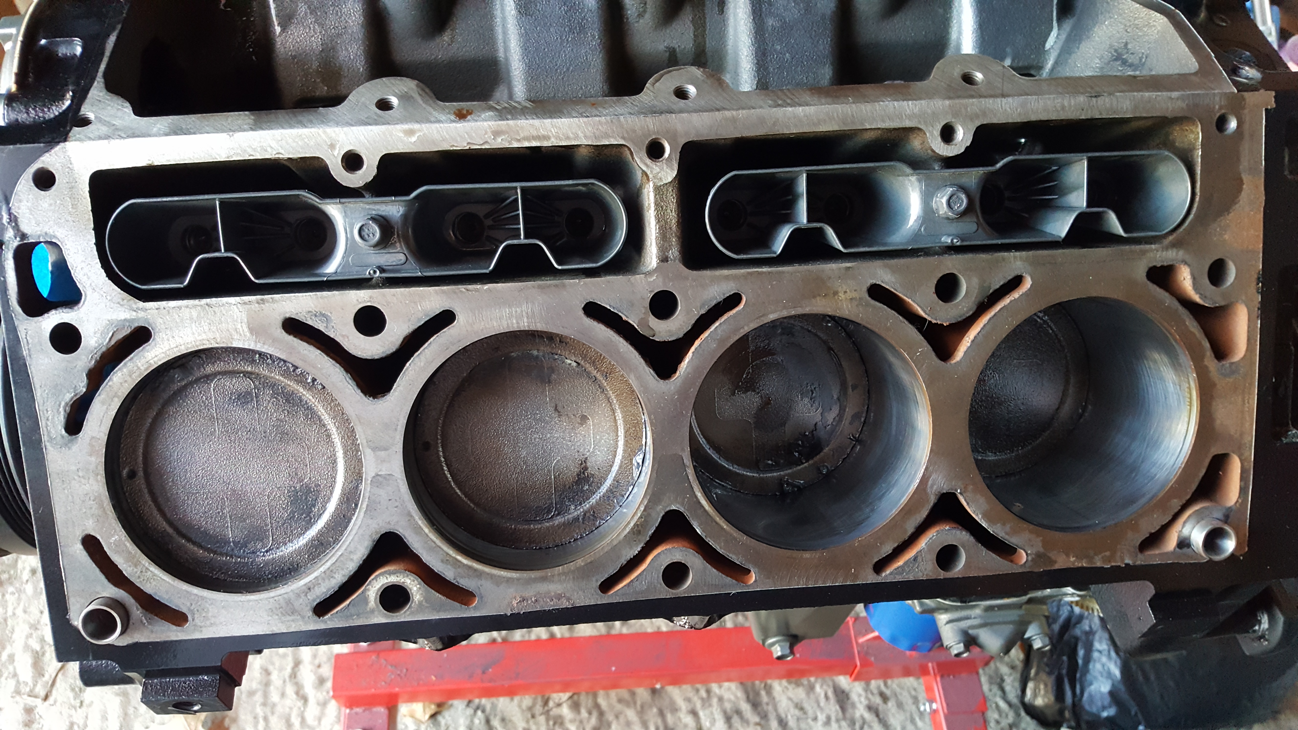

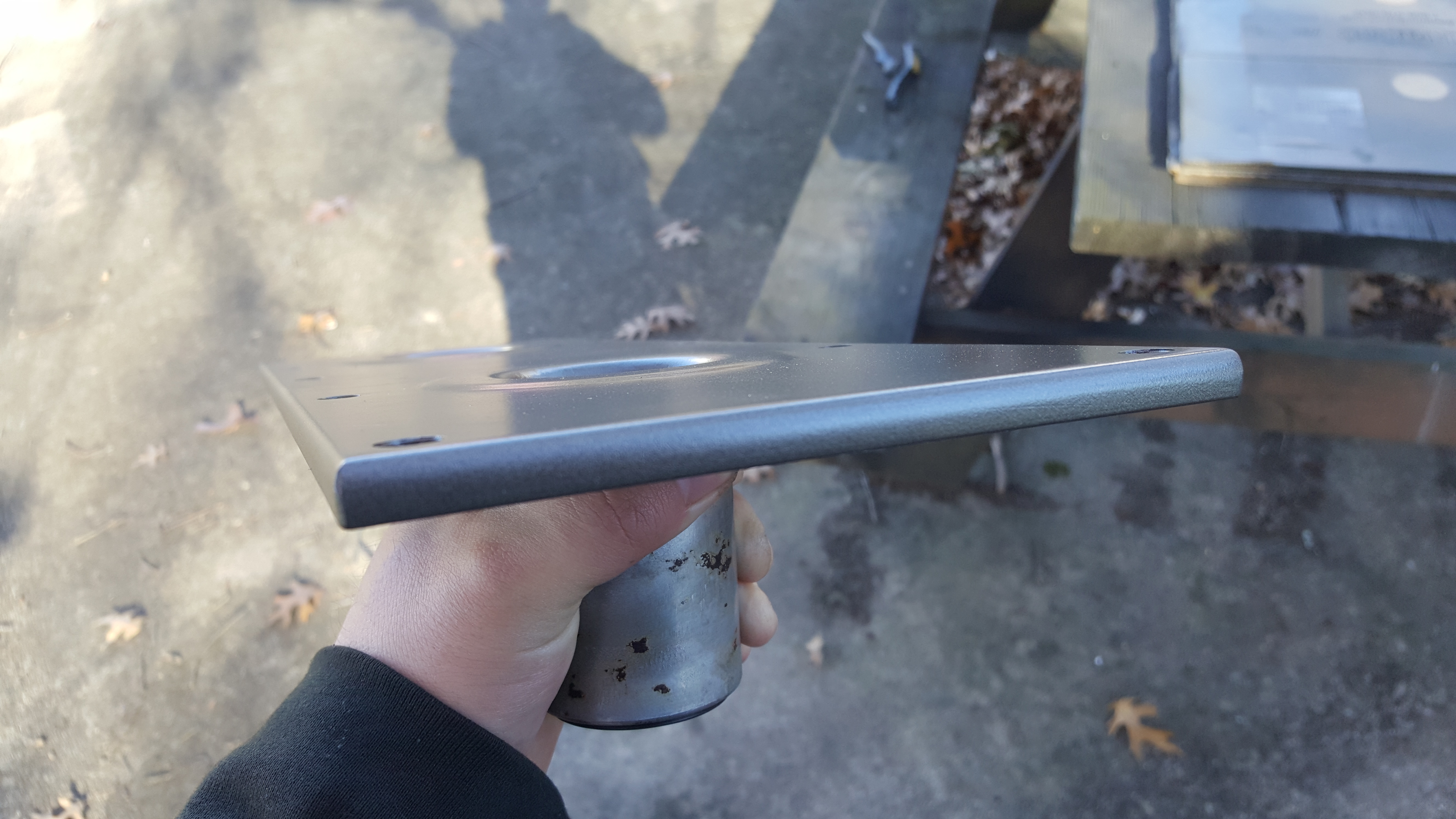

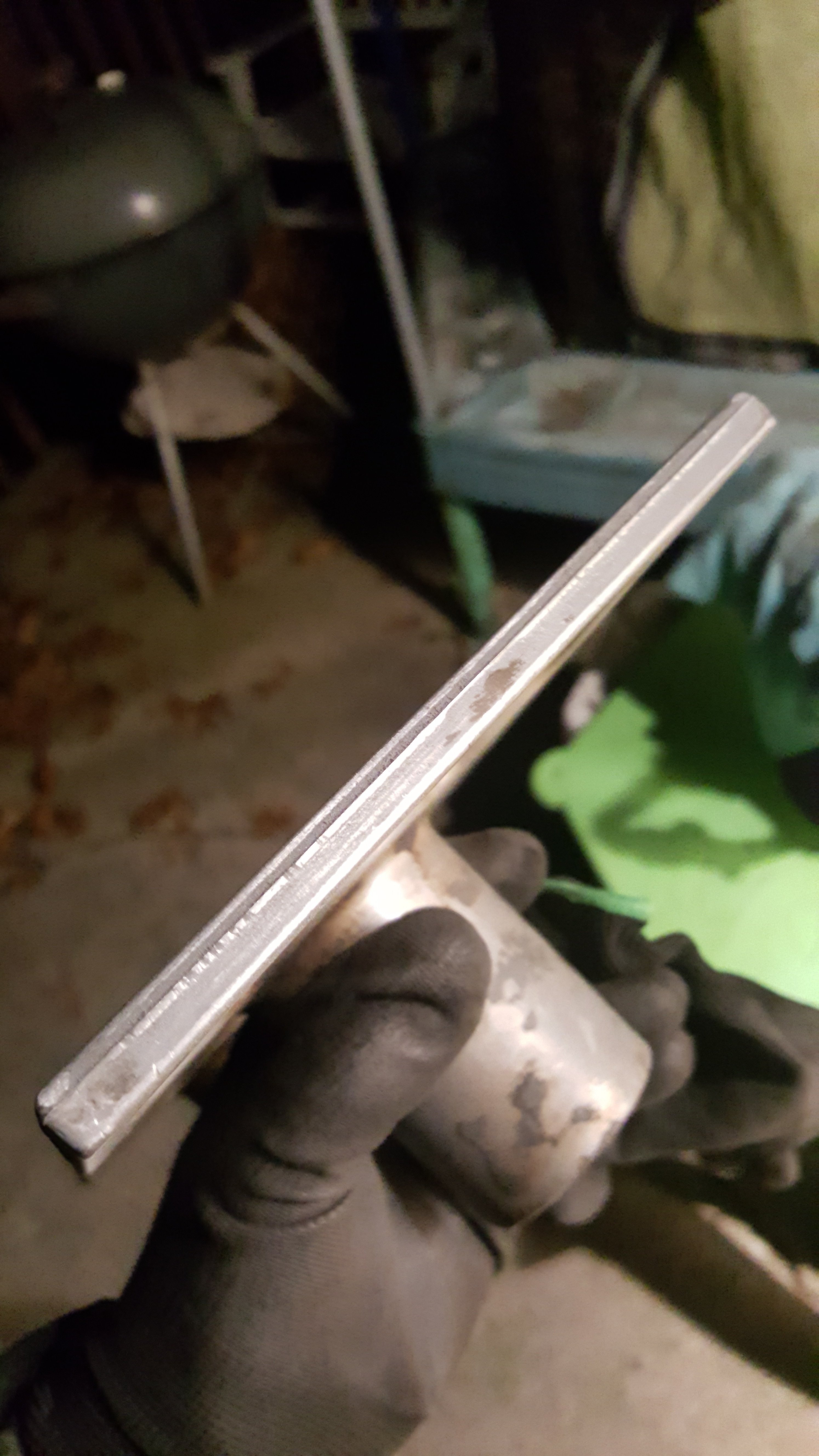

Not today, but yesterday I smoothed out the casting flash on my valley pan cover, primed and painted it. I also dropped the new lifters/trays into the LS.View attachment 77669 View attachment 77670 View attachment 77671
You should consider drilling and tapping a hole in it at the PS front corner and inserting a 90* barb fitting, and then run that into a catch can with some check valves... poor man's LS6 valley cover PCV. I will be doing this on the Monte's 4.8L - and I will be pulling air from from the valve covers as well. Basically, it will be a system that uses the turbines under load and the intake outside of boost (this is how my TBSS is set up).
Obviously without the turbo(s) just using the valley cover and stock outlets on the valve covers is sufficient for managing clean and dirty air.
