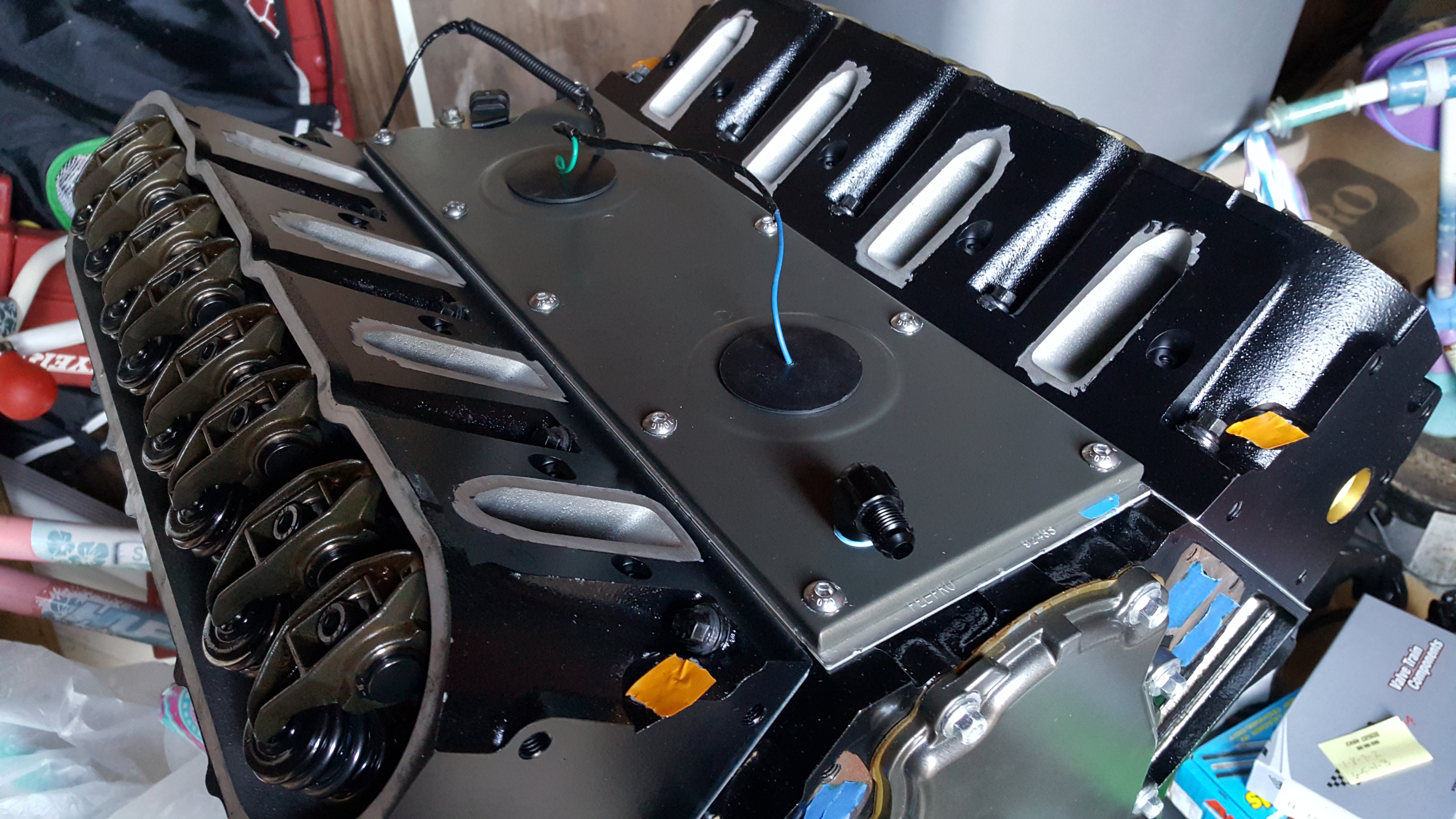

I got my NPT to -6an elbow installed, valley cover torqued, and knock sensors and harness installed. Minus the valve covers which need more prep before paint, the LS long block is done 🙂.

I got my NPT to -6an elbow installed, valley cover torqued, and knock sensors and harness installed. Minus the valve covers which need more prep before paint, the LS long block is done 🙂.View attachment 78660
Nice. Throw a little Form-A-Gasket 2 or some silicone around those knock sensor plugs... water gets in there and screws crap up good.
