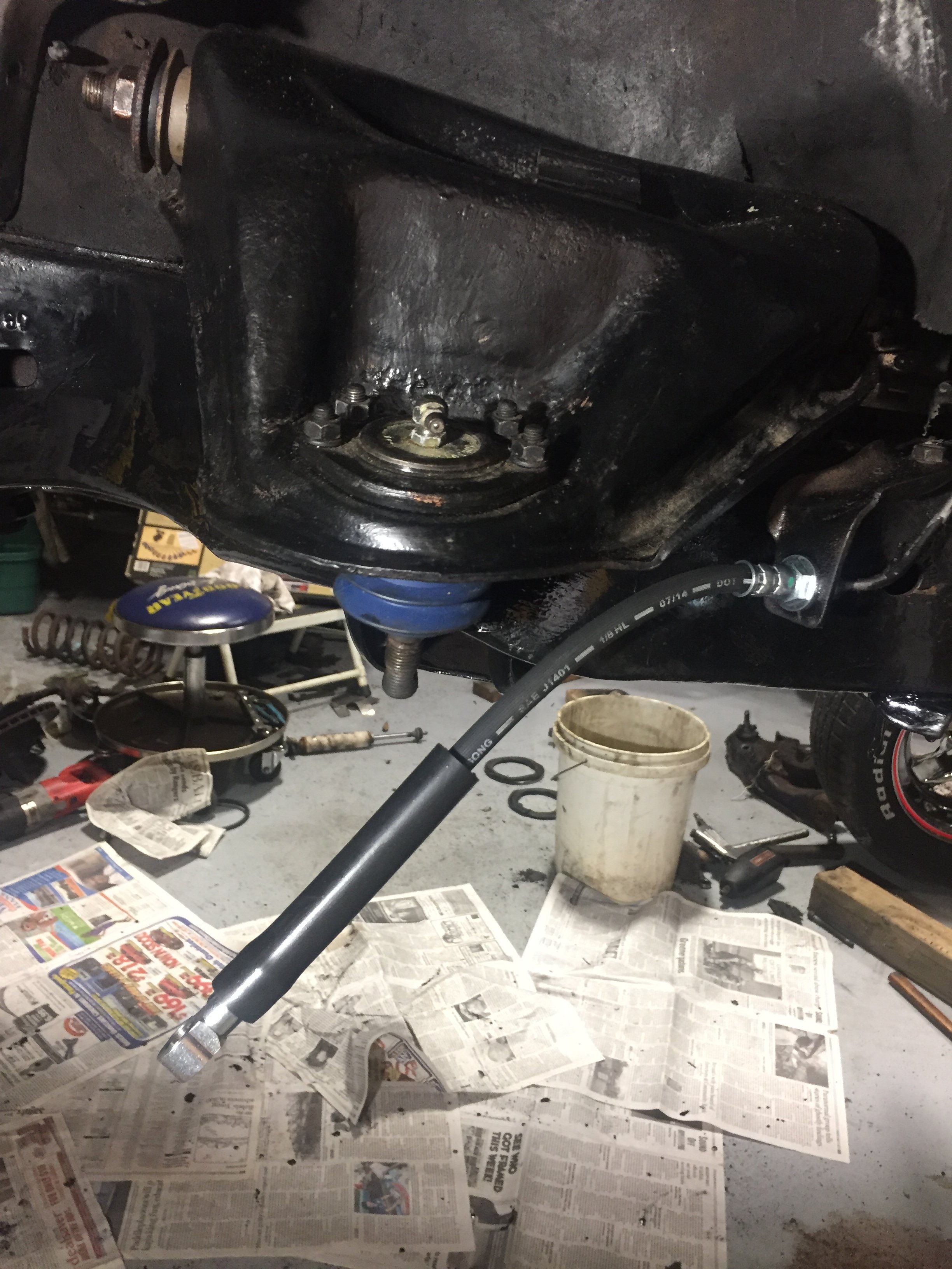

Upper control arm and new brake line installed.
hey jimmy, do your self a favor, turn the grease zerk so it faces the front or back, 90 degrees from where is it. that way you can access it with the wheel on.
