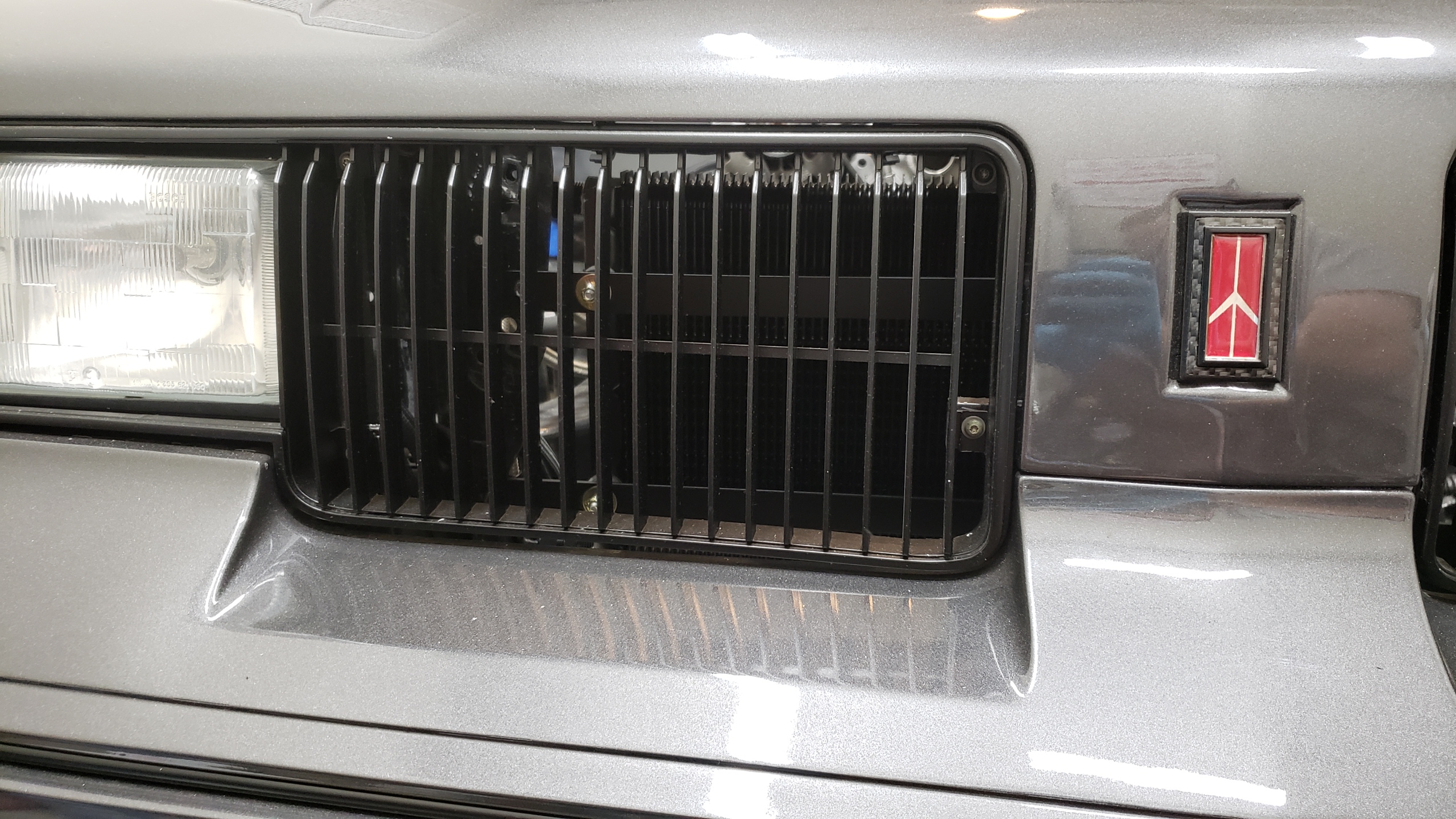

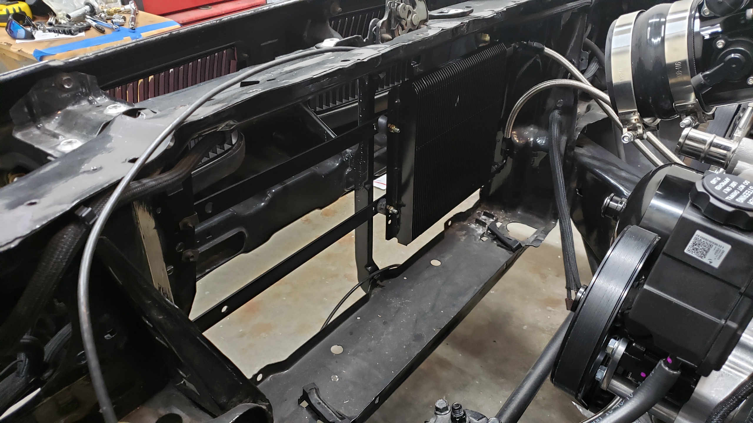

Used the 70 degree weather to fire up my redneck paint booth, and rattle can some brackets to make them disappear once installed.
