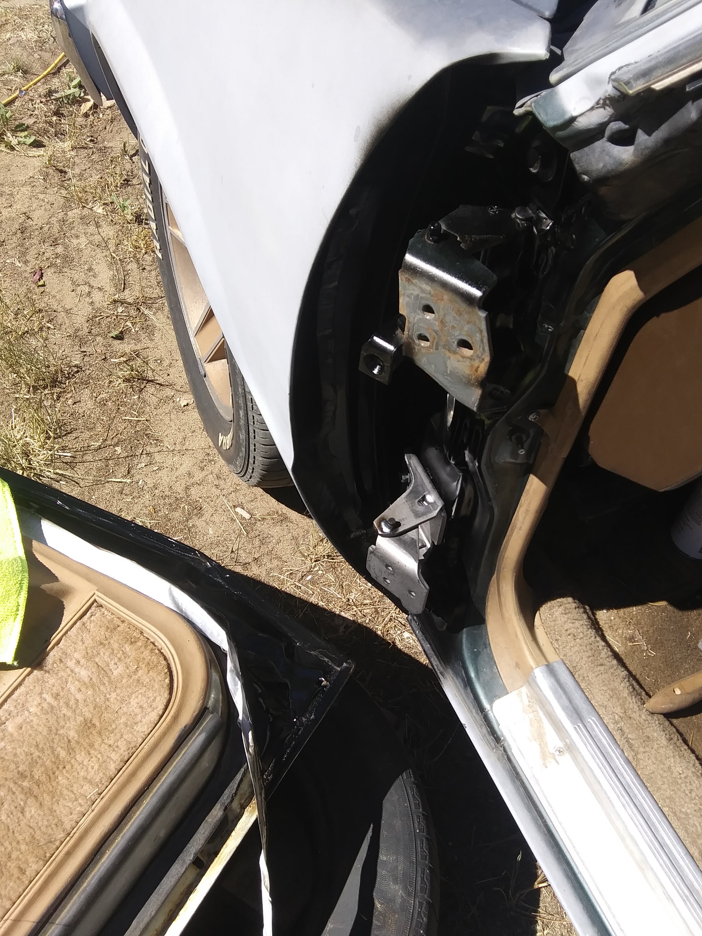

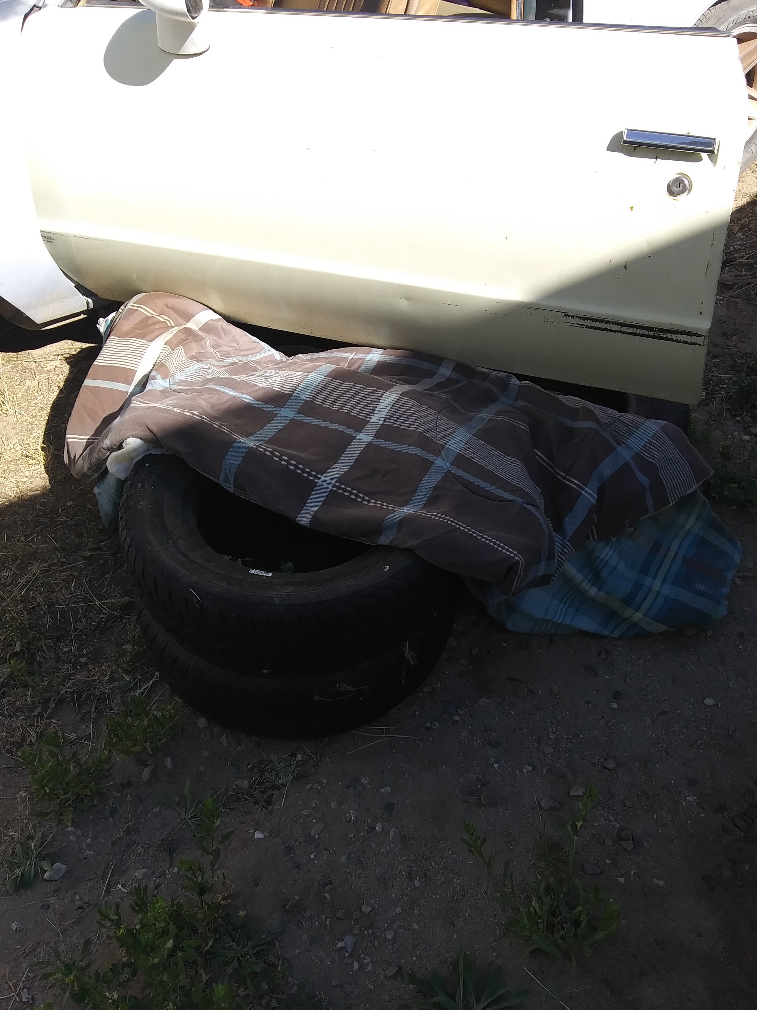

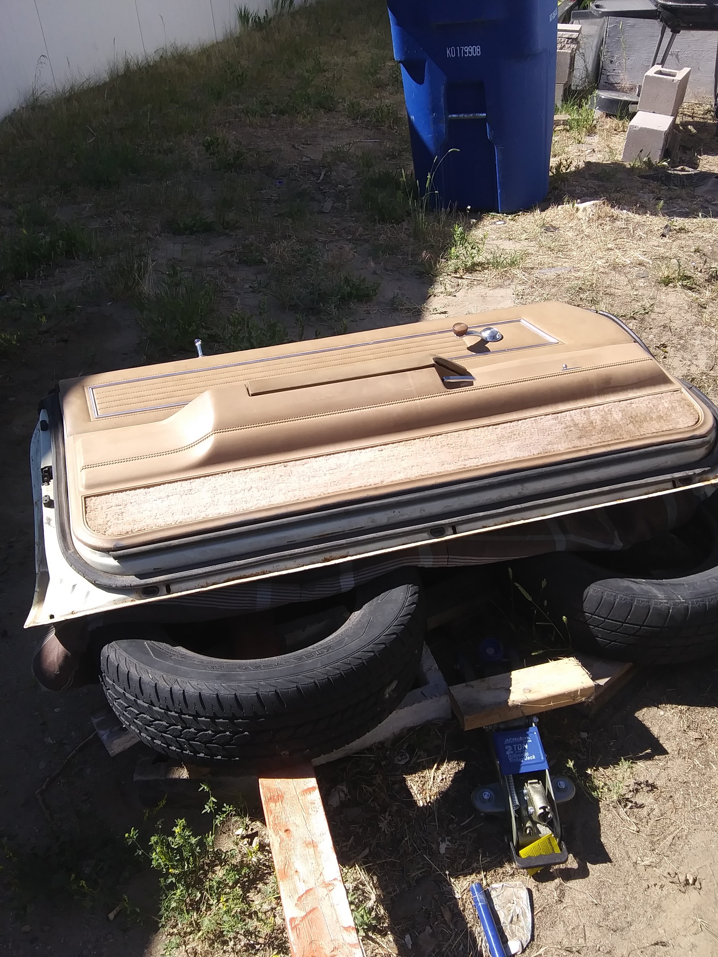

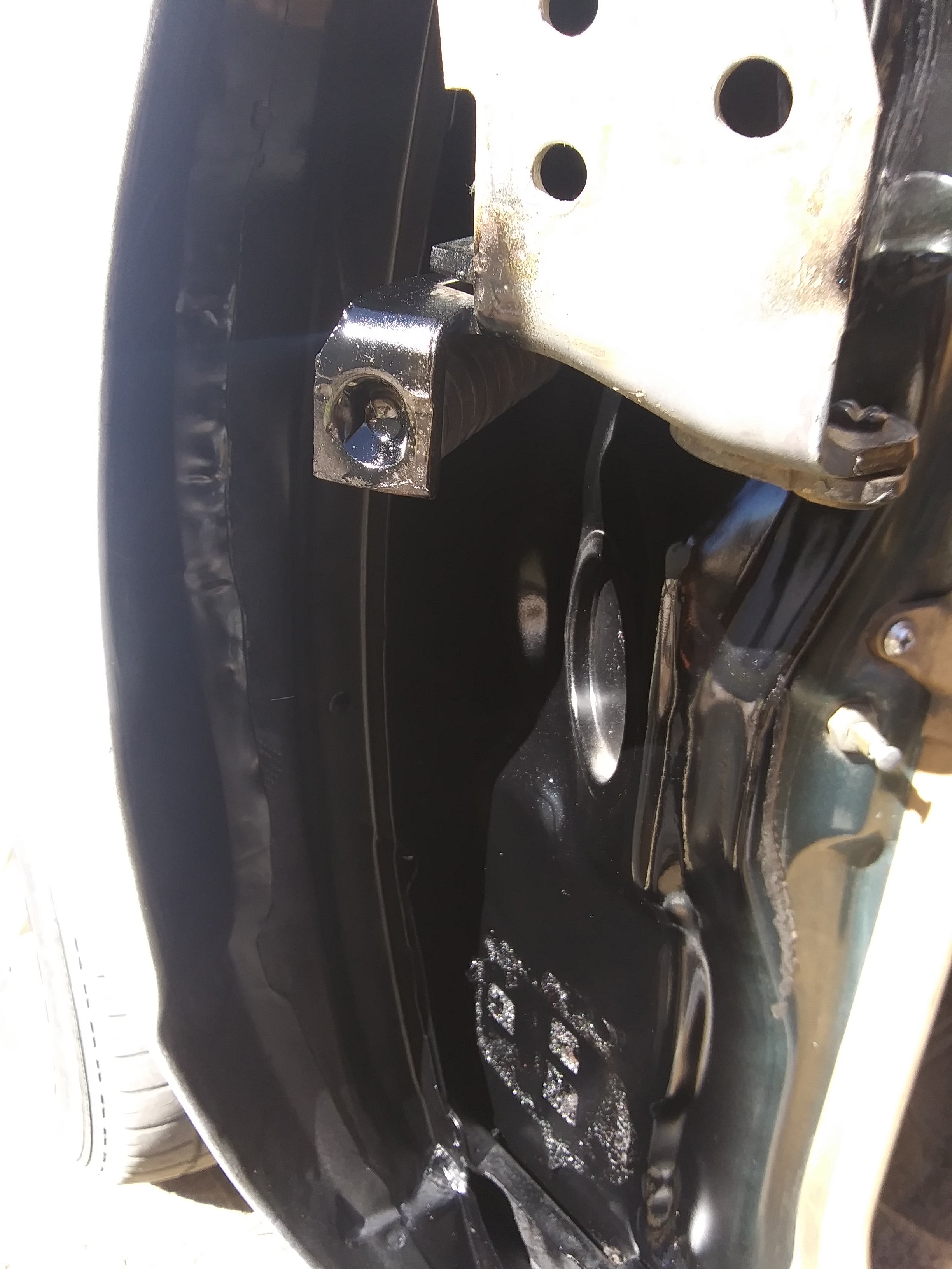

We're both having to replace the Hinges. Today I just now got finished replacing the Driver Side lower door hinge on the 81' Malibu. For me as well it was very much so a process, I also had to paint that part of the pillar black so's I won't have to worry about it later. Hardest part for me was putting the door back on with the inner plates (With the Thread Holes) moving around which I had to use an Allen Wrench to help me line it up so I could put the bolts back in. Allot of cussing and allot of sweat, but it's on. The door is no longer hanging and closes well. Strangest part for me is that the door closes smoothly with the window down, but when it's up I have to push alittle hard to get to close all the way. Otherwise I finally got this part finished. Kudo's to us both 5spdCab. 😎 👍

I had noticed that my door had always closed better/easier when the window was down also. A couple of weeks after doing the power window upgrade, I saw a post about adjusting the window stops inside the door shell. I will attempt to find that post and let you know where it's at, or PM the link to you.
When I had the panel off last Saturday to tighten a loose electrical connection, I adjusted those stops on the driver side. Getting that taken care of, along with getting the door aligned better with the new hinge install, I find that my door closes so much easier. Soon, I hope to install the weather strip around the door, and install the insulation and water shield as I find and install stereo speakers. After that, the last thing the doors will need are the upper panels.
