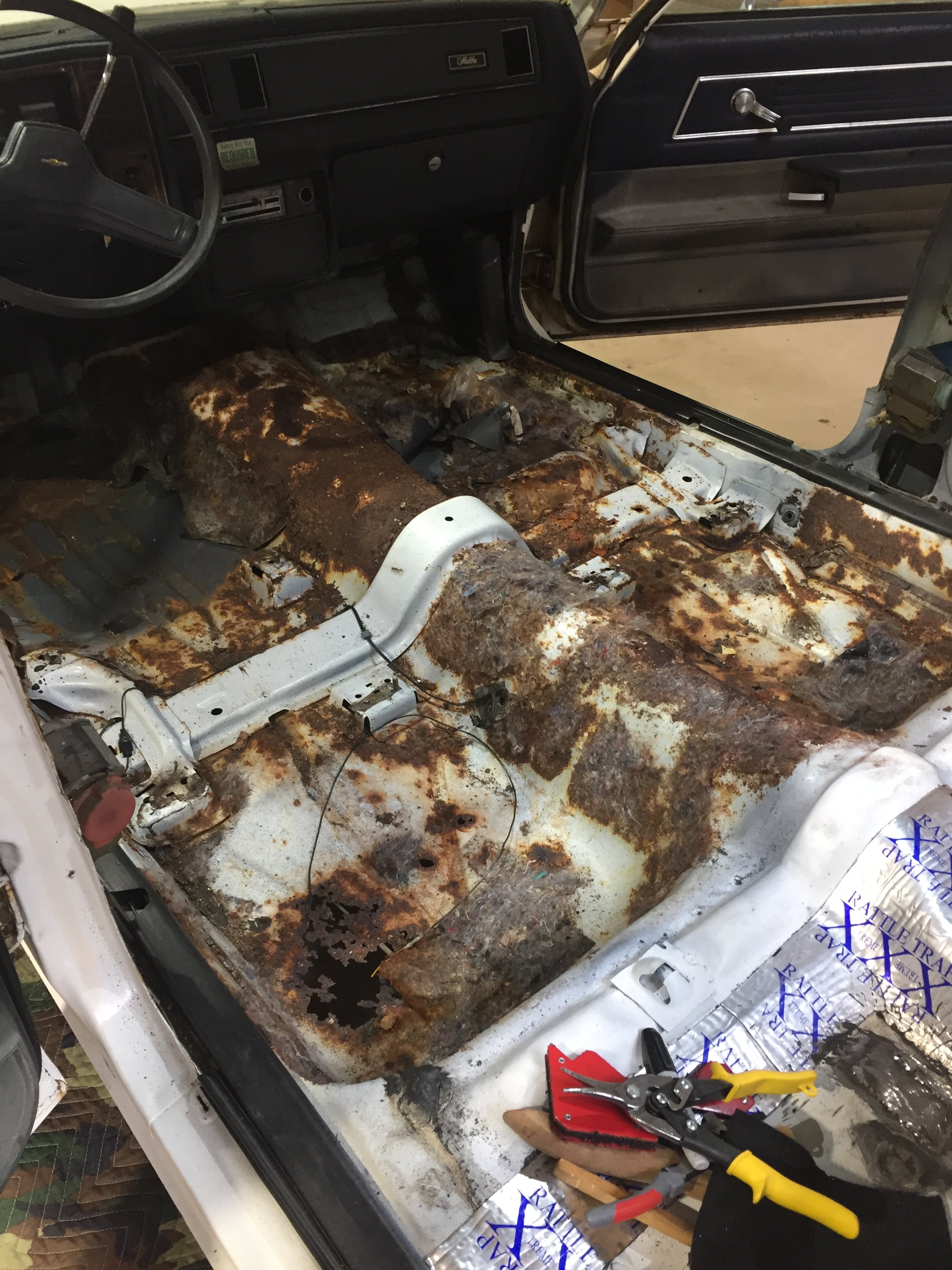

Got the interior stripped out, rubber matting removed. After inspecting the Swiss cheese I found I’m torn between patching or total floor replacement.
Thats alot of thin metal and holes. If you replace the whole floor its a pretty big job. If you try patching it you'll be fighting what will amount to a losing battle. There will be rust in every seam of that floor. The seat belt mounts are probably unsafe because of rust. If your gonna put time,effort and money into it and plan on keeping it. Id try to make sure im not doing it again in a few years.
