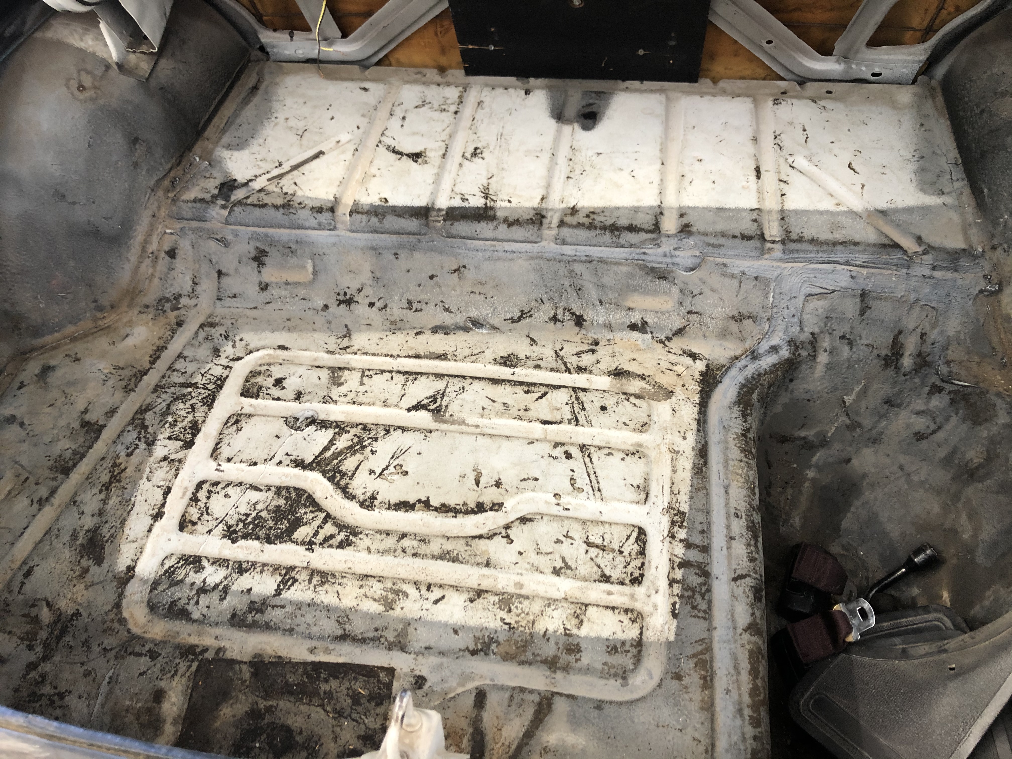

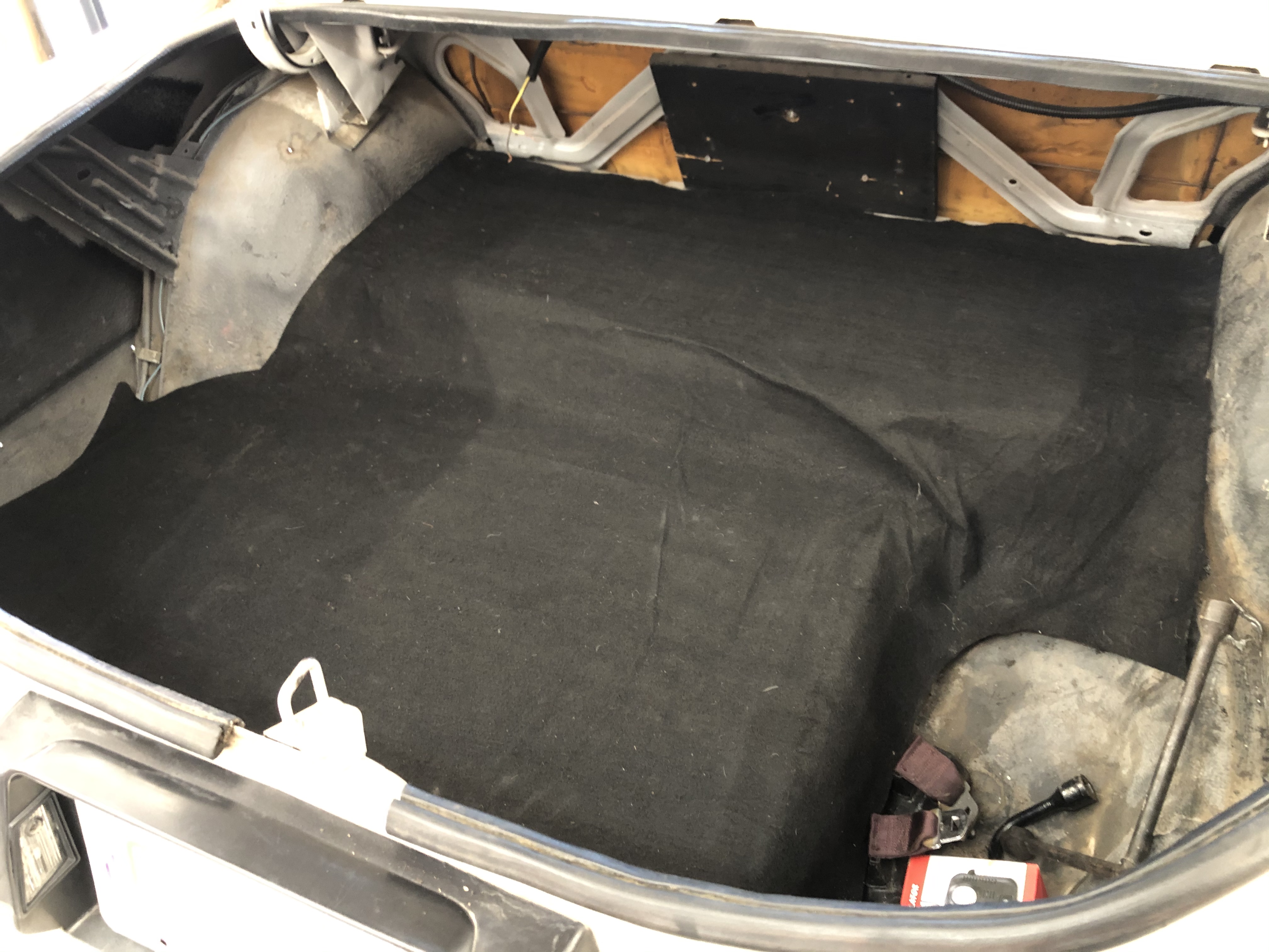

Finally cleaning of trunk area and reinstalled the carpet.

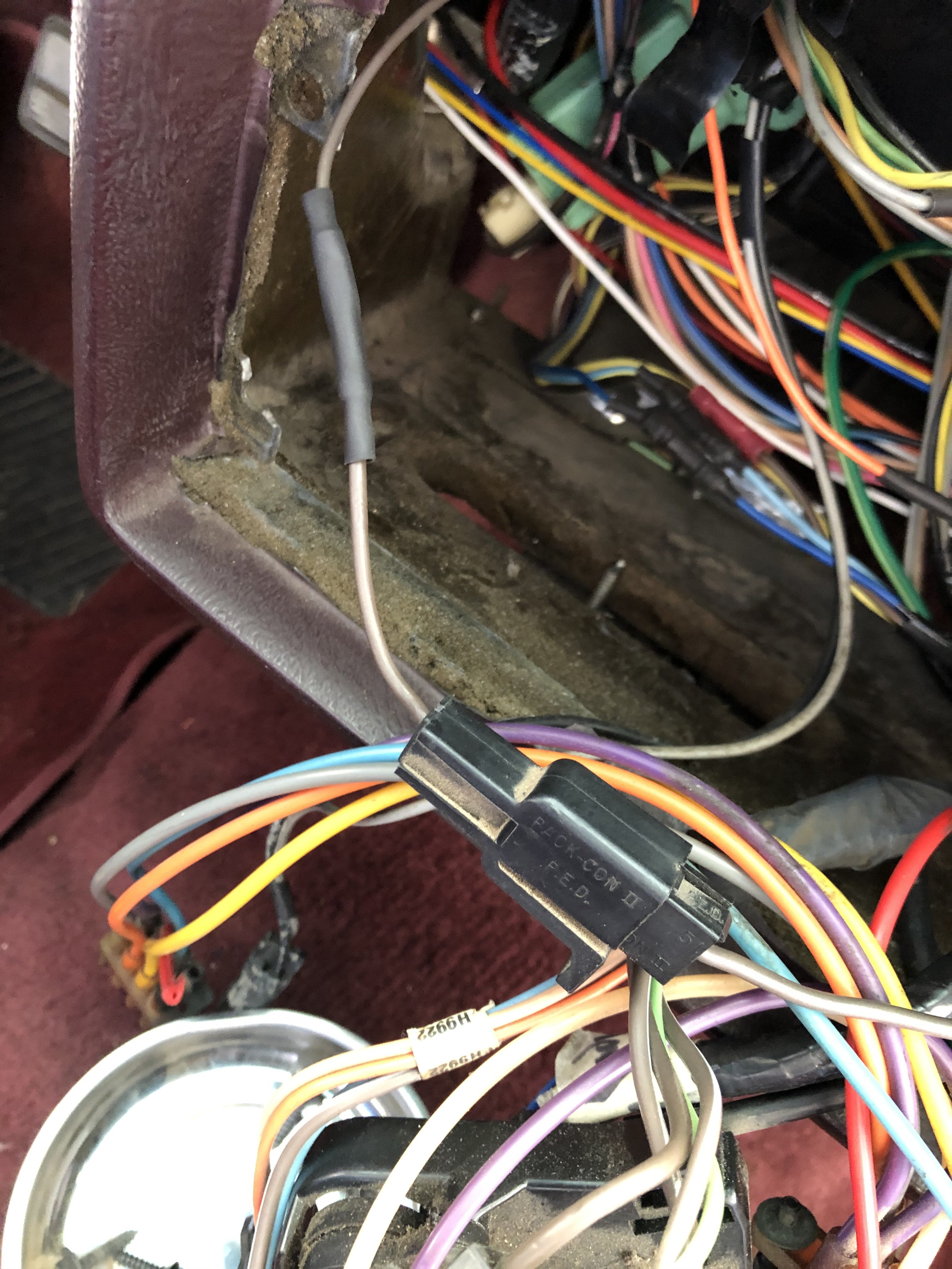

Installed a new-to-me A/C vacuum line behind the dash. Previous one melted somehow.
Also wired in the A/C hot wire that the previous owner cut for some reason. I got a blower motor now, although it is very weak even on high. I don’t expect much for 30 years old and not having been used in who knows how long. The AC setup is pulled from the car anyways, one step closer to getting it all working though.
You can catch a glimpse of all of the previous wiring repair that I’ve done on the car since I’ve had it. Previous owner(s) we’re not friendly to the wiring. Undoing others mess ups is both interesting and irritating.

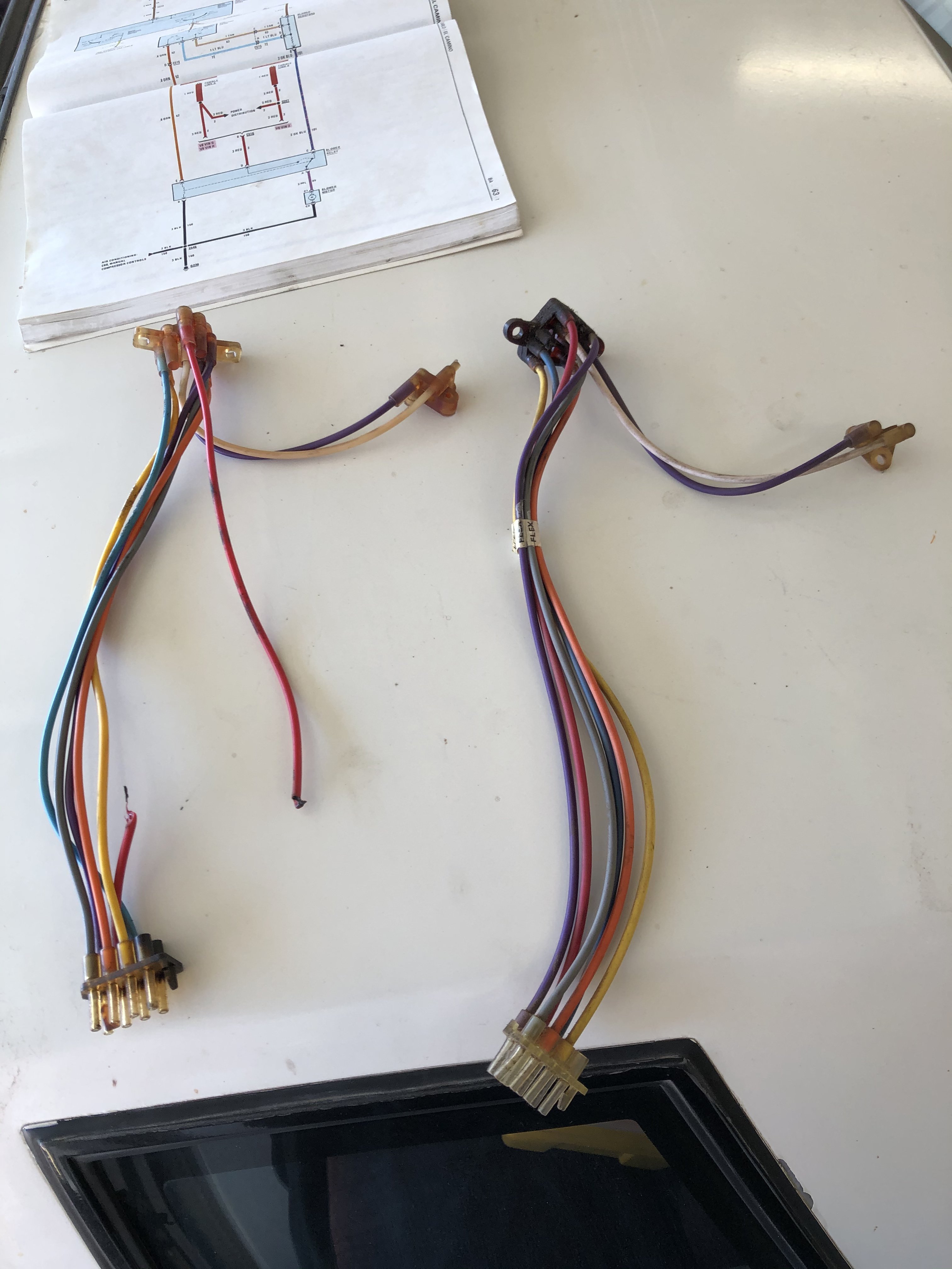

You've got that right, I have an AC dash that is nearly ready to be installed in my Caballero that the previous owner(s) cut more than half of the instrument cluster wiring to install aftermarket gauges. Sometimes you gotta wonder "what was that guy thinking".
