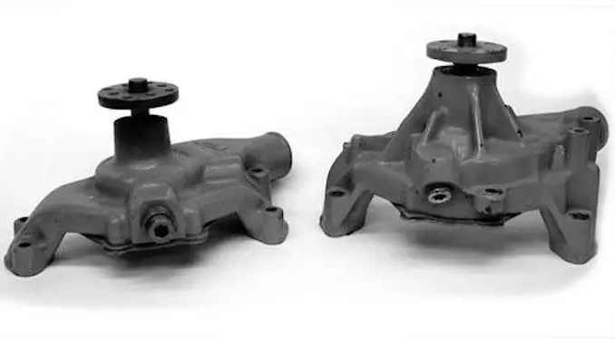

Can anyone tell me what/why the difference in long/short water pumps. Does it have anything to do with whether the car was fitted with AC or not? Will I need to add that to my list also?
Here's a visual on the difference
Shouldn't be any big issue on if the pump was spec for A/C or not with most remans/aftermarket OE replacement pumps.
I would have to say that I have long water pumps on both of my gbody rigs. That short one looks weird, like some kind of alien water pump.
Thank you pagrunt.
Thank you pagrunt.
I might be off onthe year but I'm thinking '69 was the first year for the long with only Vettes using the short up th '82. All years of our generation will have the long pump.
