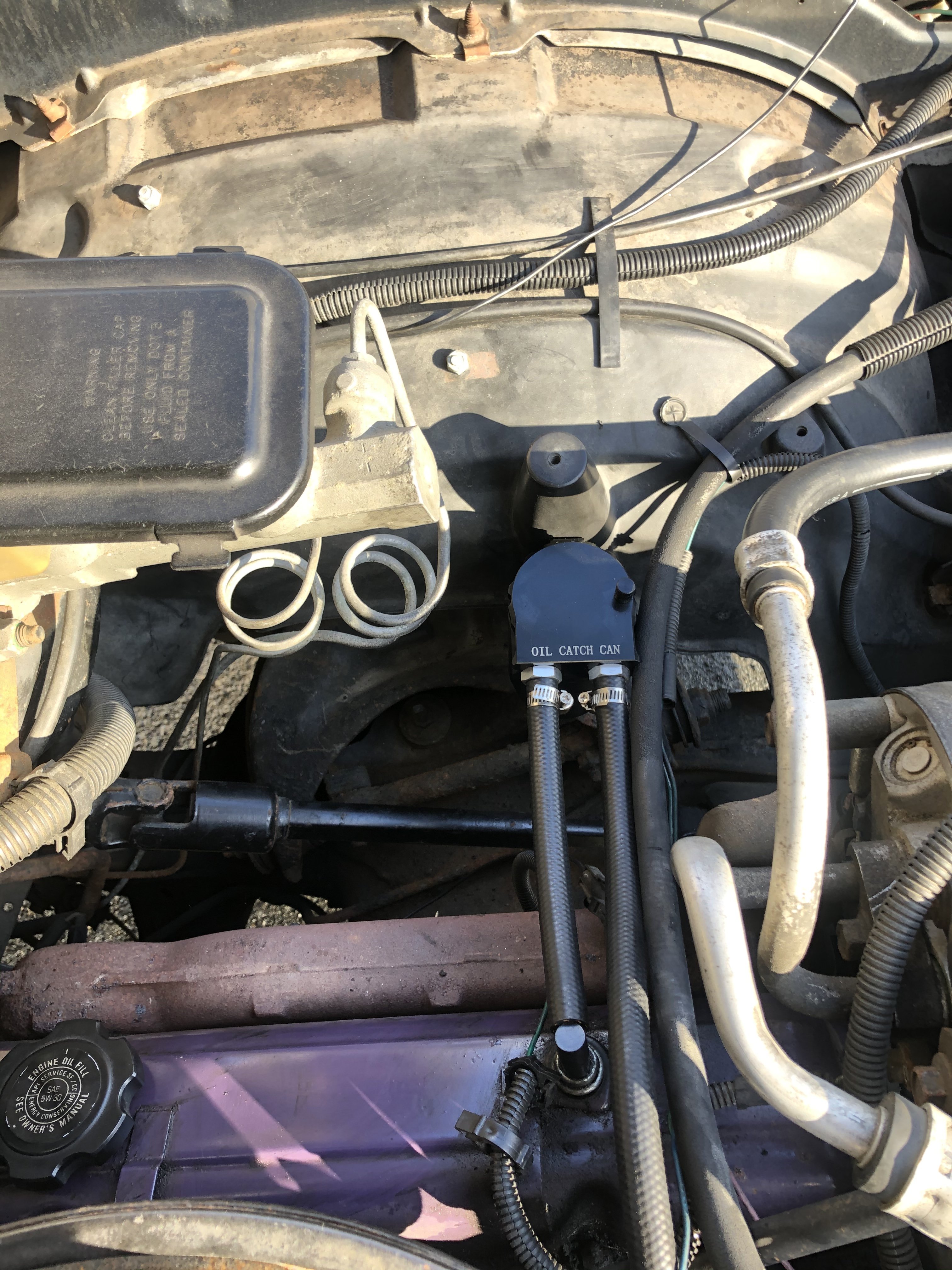

Haven't had time to work on the El Camino in awhile, but since my university is closed because of Corona cases on campus I took advantage of the nice day today to give the car some much needed love.
I had trouble getting my car to pass emissions last summer because I had a spark plug that wasn't firing because it was soaked in oil and gunk. Decided to try to prevent that from happening again any time soon.
Started out by seafoaming the sh*t out of the intake via the PCV while the car was running. Removed all the spark plugs, cleaned and sanded them and made sure they were correctly gapped. Did an oil change too.
I ordered a cheap oil catch can off amazon for like $35 and installed that in-line between the PCV and the intake. Mounted it on a little stub sticking up from the drivers side wheel cover that seemingly had no other purpose to me haha. Fit very nice. I'll check back in after some time driving to see if it'll collect a decent amount of gunk.

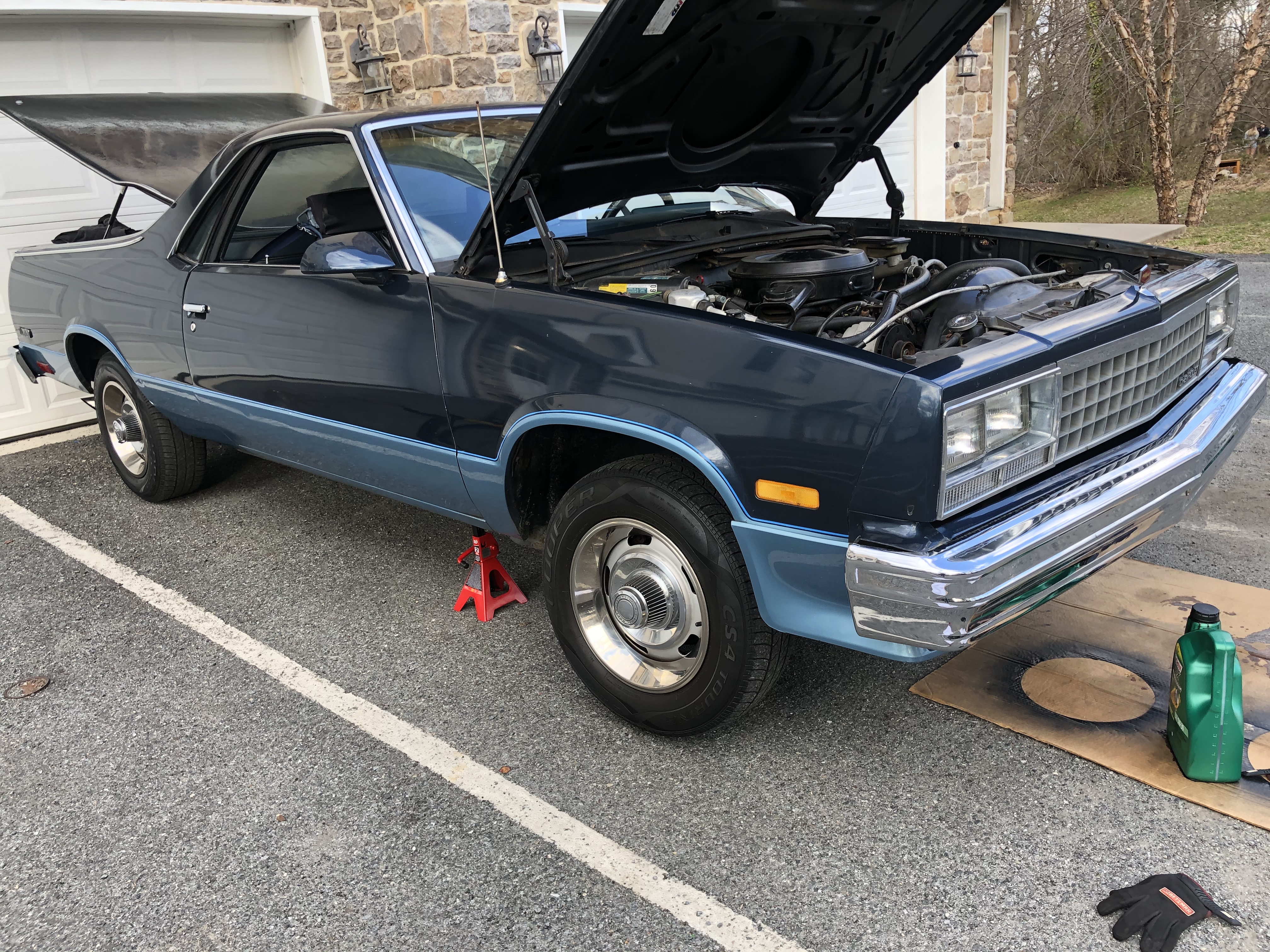

View attachment 139257View attachment 139258
Love your color scheme there, especially the way the lower blue goes up where the wheel well molding was deleted. Corvette Rally Wheels sets it all off nicely as well. I hope to get mine looking as good someday.
