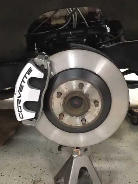

Still need to torque everything down, cotter pins, and brake fluid, but here is the basic appearance. C5 rotors, C6 calipers, S10 Blazer spindles, KORE3 brackets and hoses, Summit UCAs, Proforged +1/2" upper and lower ball joints. I know somebody wants to tell me I'm wasting my time because the large single piston G body caliper has awesome clamping force, blah, blah, blah. 12.8" rotor vs. 10.5, twin piston caliper vs. single, looks cool, yeah this is what I want. FYI- Gbody spindle, rotor, caliper, pads=42.2 lbs., current combo=49.2 lbs.
Hey, carnutjw, in the end, it's what you want. Consider the advice of others, but make your own decisions, build it the way that you want it.
