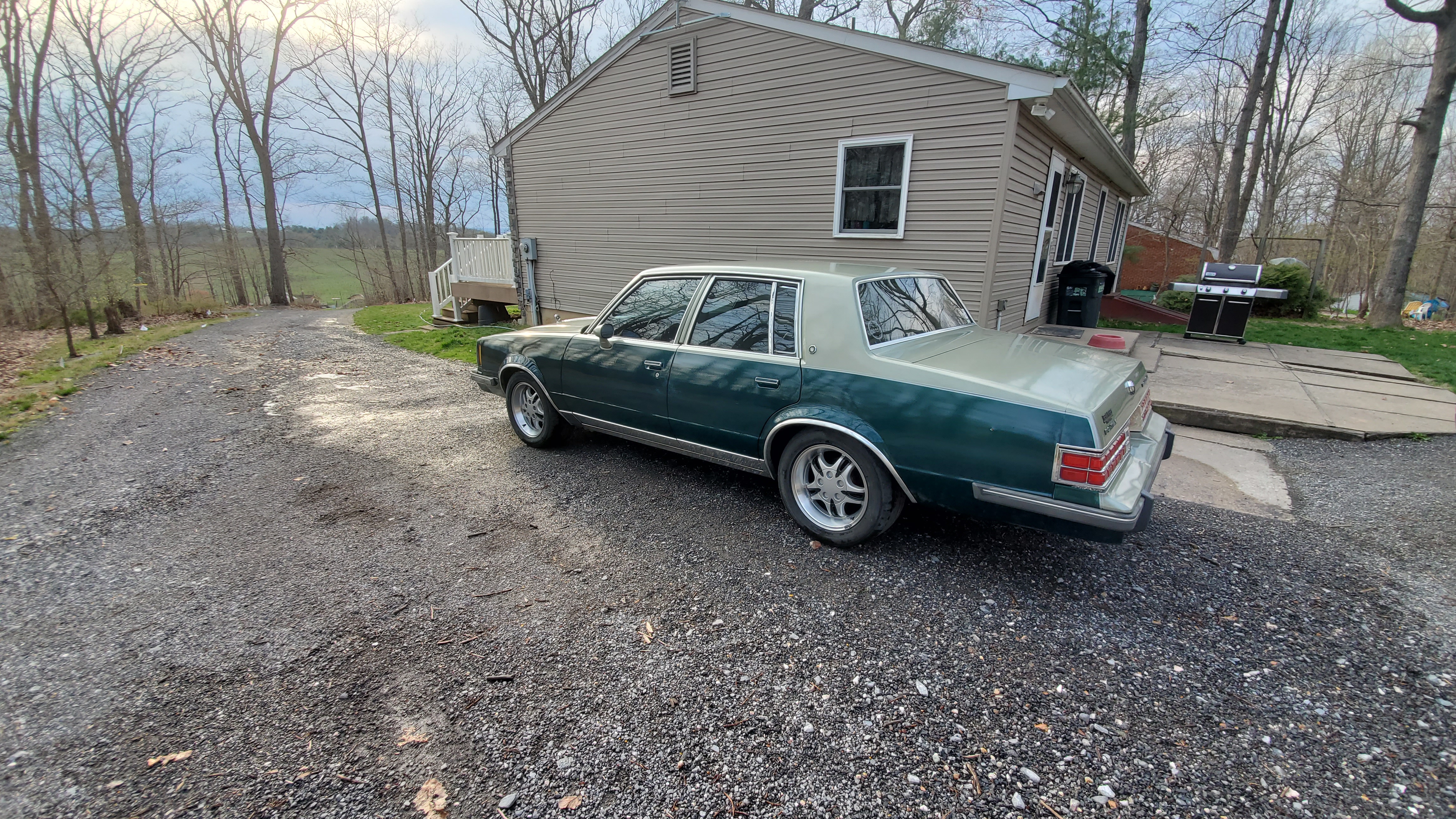

Installed the Holley exhaust. The fit and finish is excellent! It went together really well. I wish I had a G-force or Holley crossmember. The only problem I have is the Jegs crossmember jumps are no where near the proper location for it to fit. If they were all I would need to do is add about 4” to the driver side the Holley exhaust would work well on the Speed Engineering headers.
