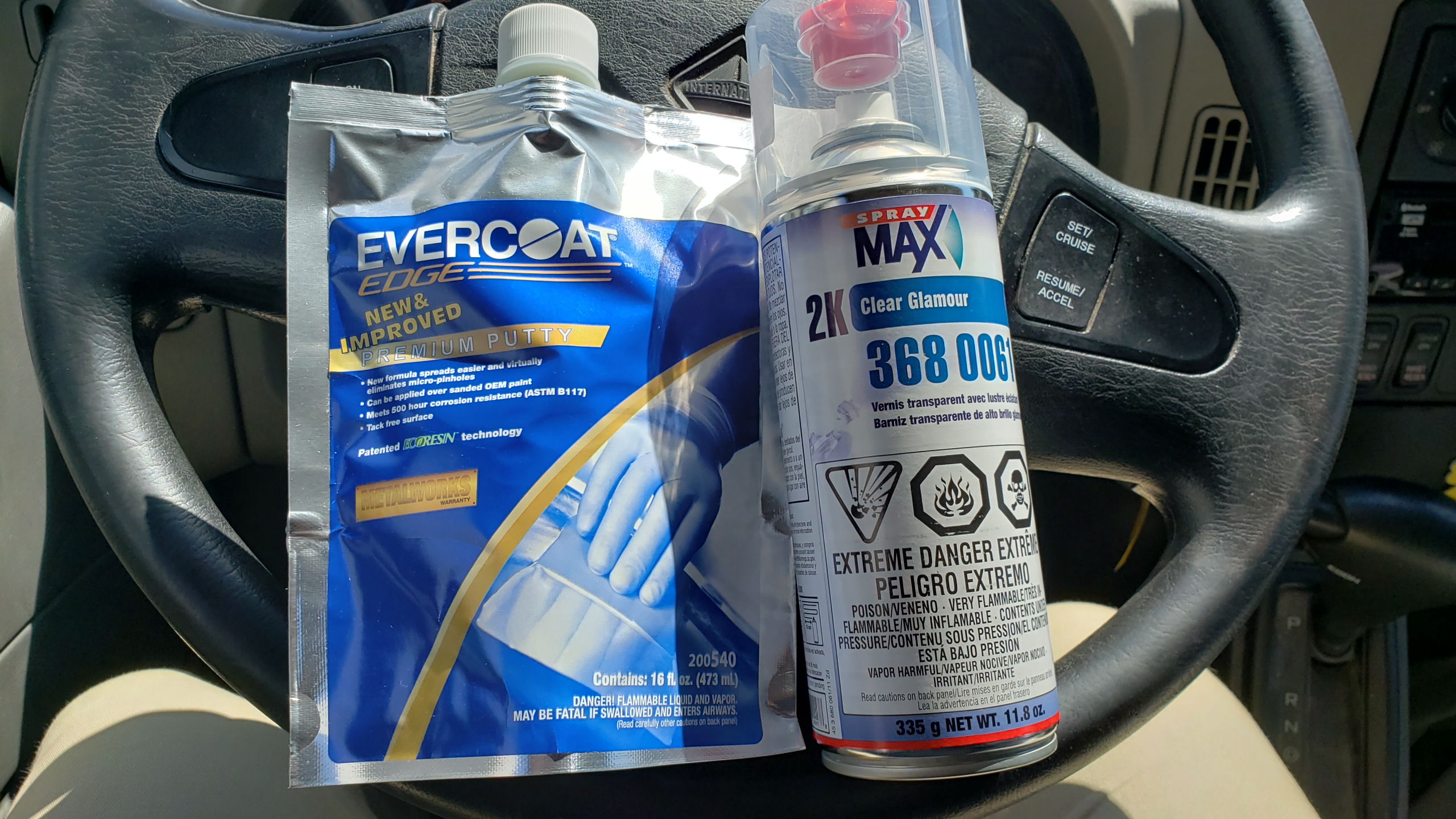

Picked up the rest (I hope) of the material to finish the spoiler....View attachment 141952

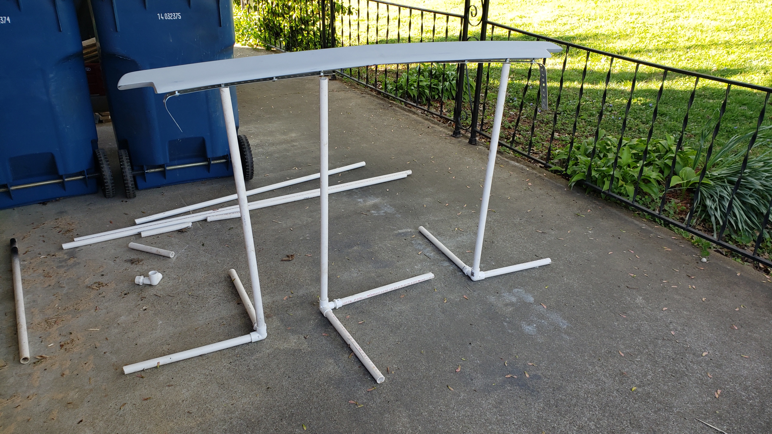

Also picked up some drilled strapping, a piece of all thread, and cut up some spare PVC I had laying around to make a holding stand to paint the spoiler. It's redneck AF, I love it!View attachment 141953
You just showed me the way to support my spoiler when I get back into the body work phace again.
