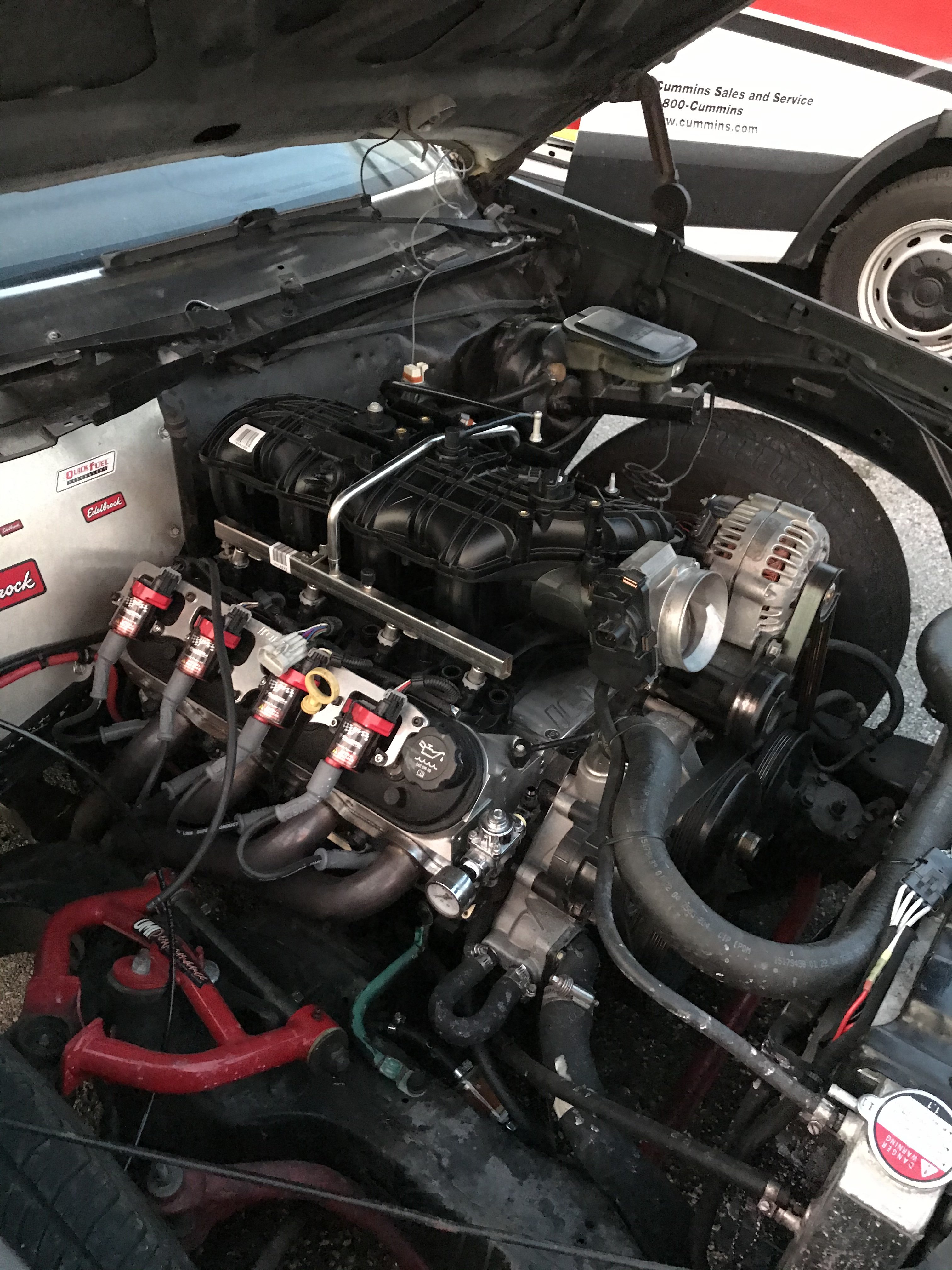

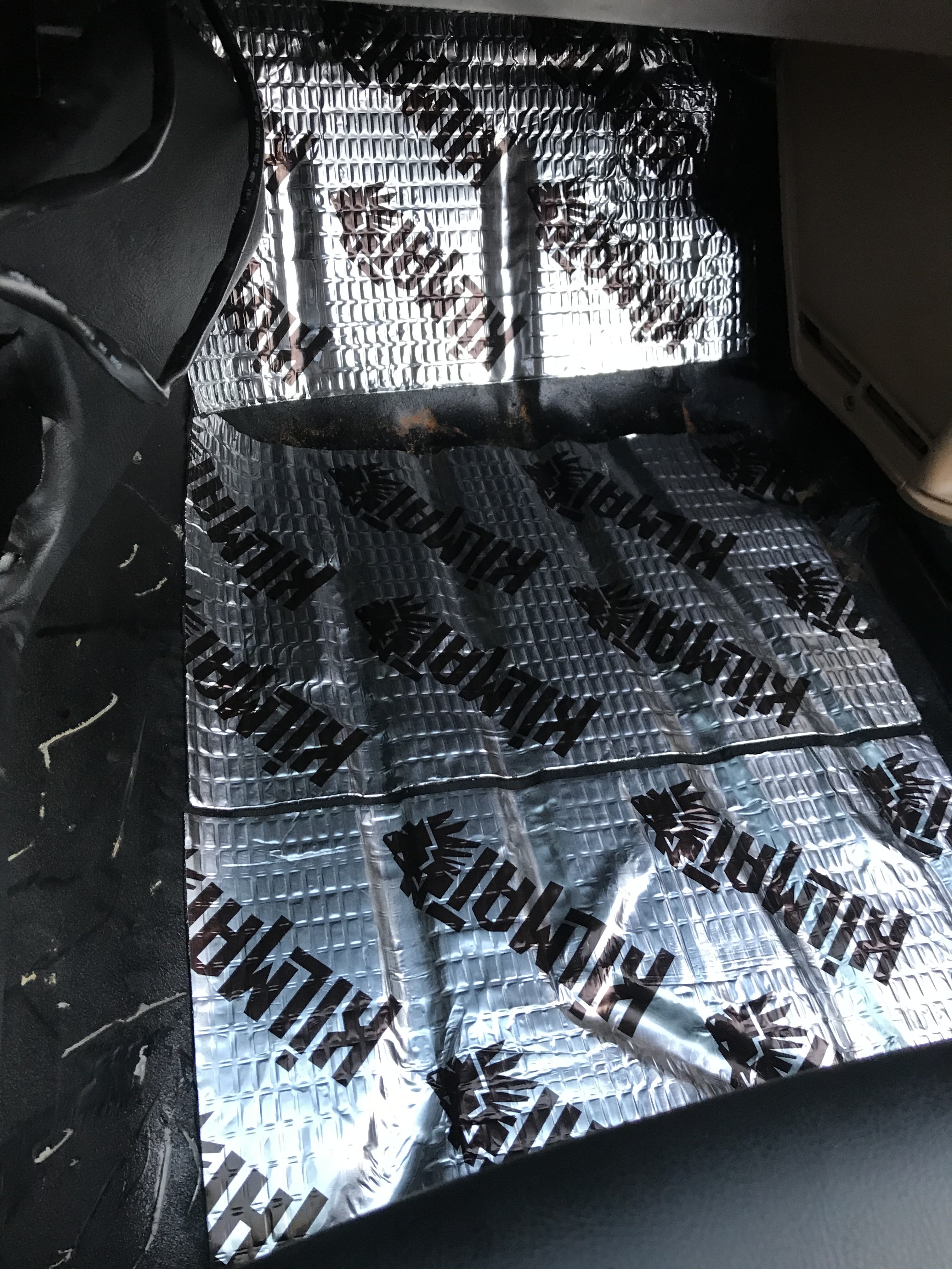

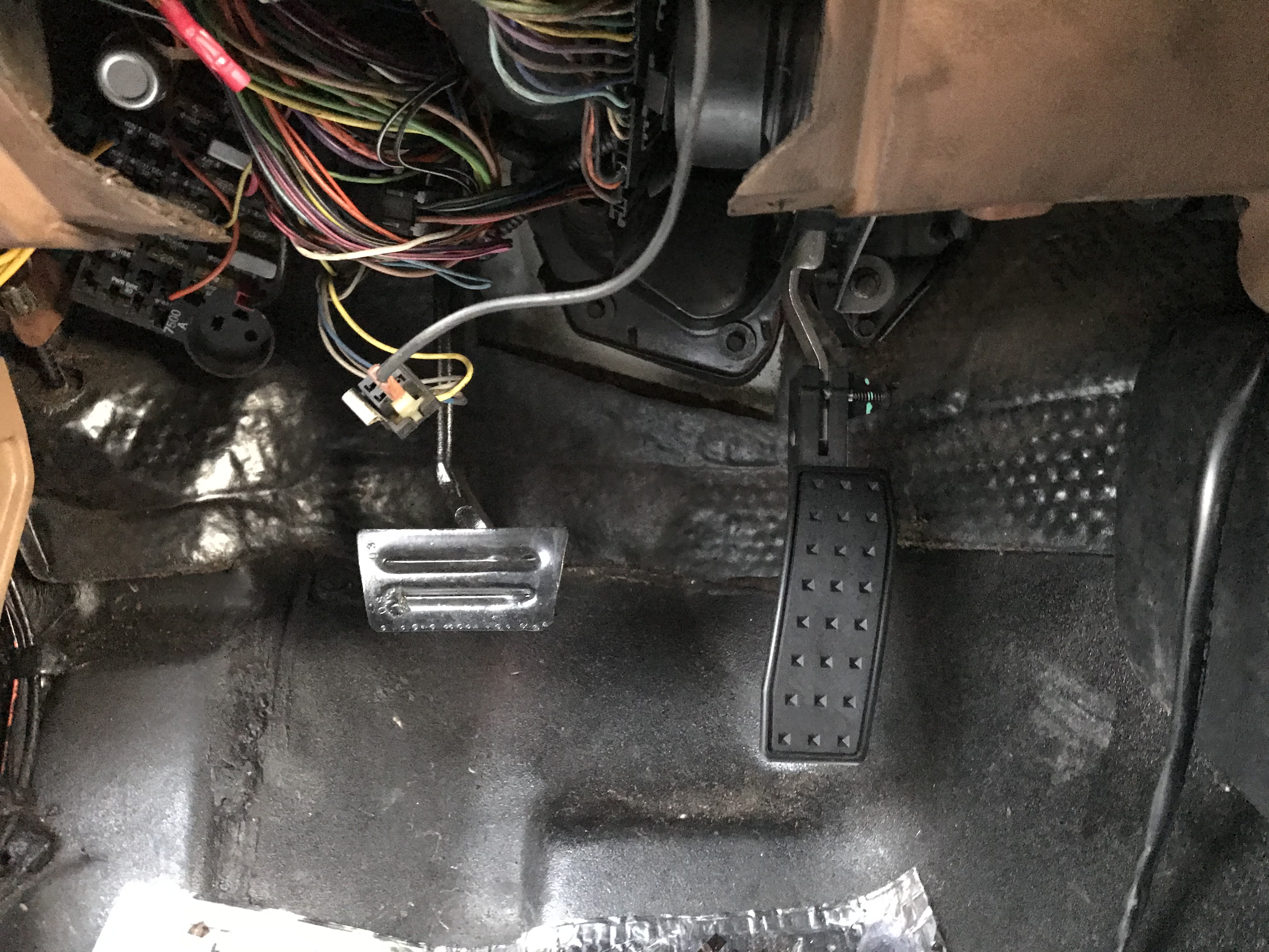

I installed the pedal, some of the kilmat, and the mocked up the intake(still waiting for the gaskets). Sill waiting for the sending unit which I ordered on Monday and paid for it to be “next day shipping “... Still waiting for the Holley which is on back order. Why does the world ending have to get in the way of our projects.
I installed the pedal, some of the kilmat, and the mocked up the intake(still waiting for the gaskets). Sill waiting for the sending unit which I ordered on Monday and paid for it to be “next day shipping “... Still waiting for the Holley which is on back order. Why does the world ending have to get in the way of our projects.View attachment 143759View attachment 143760View attachment 143757View attachment 143762
