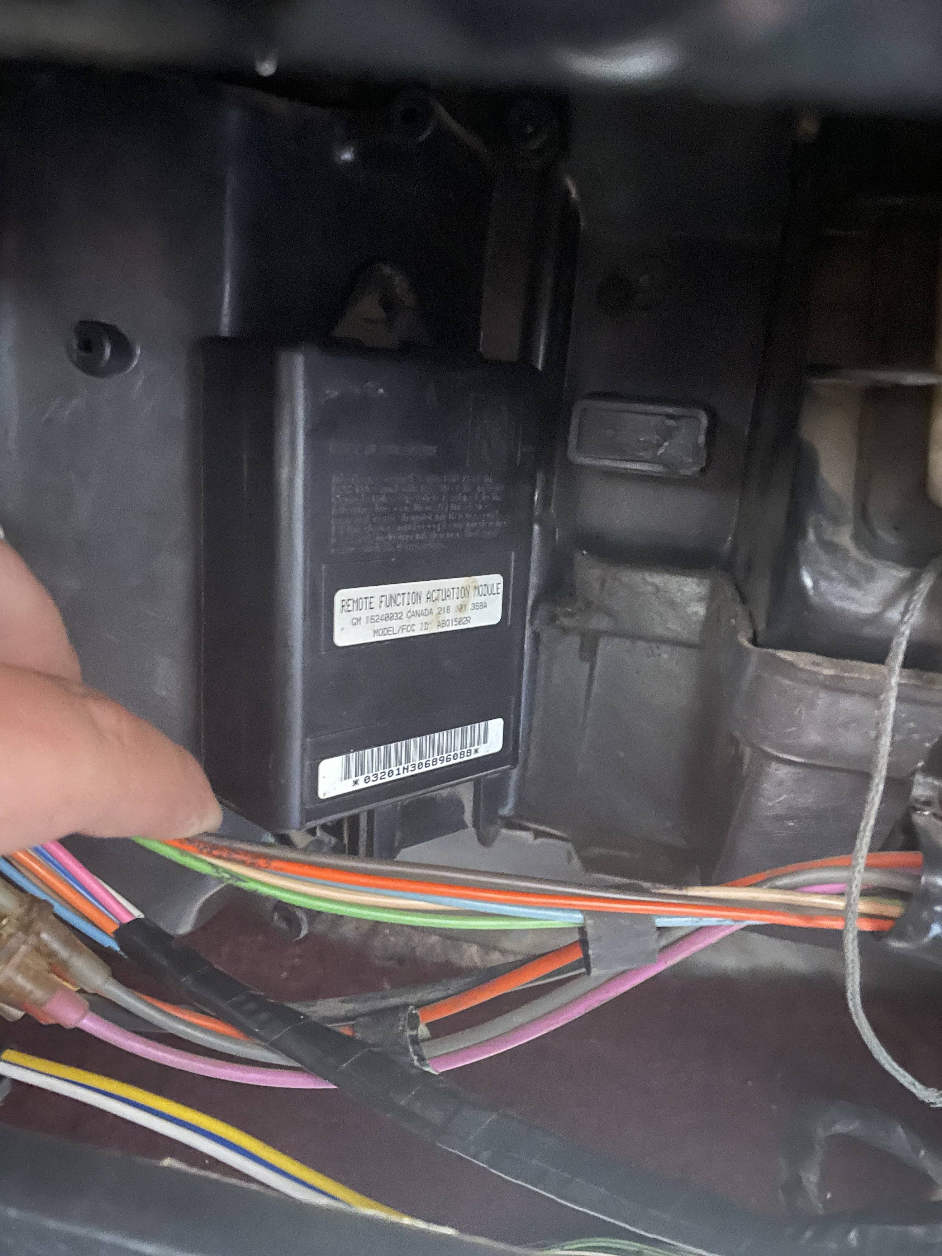

Installed a remote keyless entry from a Lumina. I bought a remote from eBay but it wouldn’t take to programming. I put it into programming mode and the trunk release and door locks cycled so I know I did it right. I’ll order a new fob and hope for the best. Mounted with Velcro like the stock application. Fit nicely on AC box right behind glove box.
How much wiring did you need to do for the door harnesses to get that to work? Really cool!
What year Lumina, random 90's?

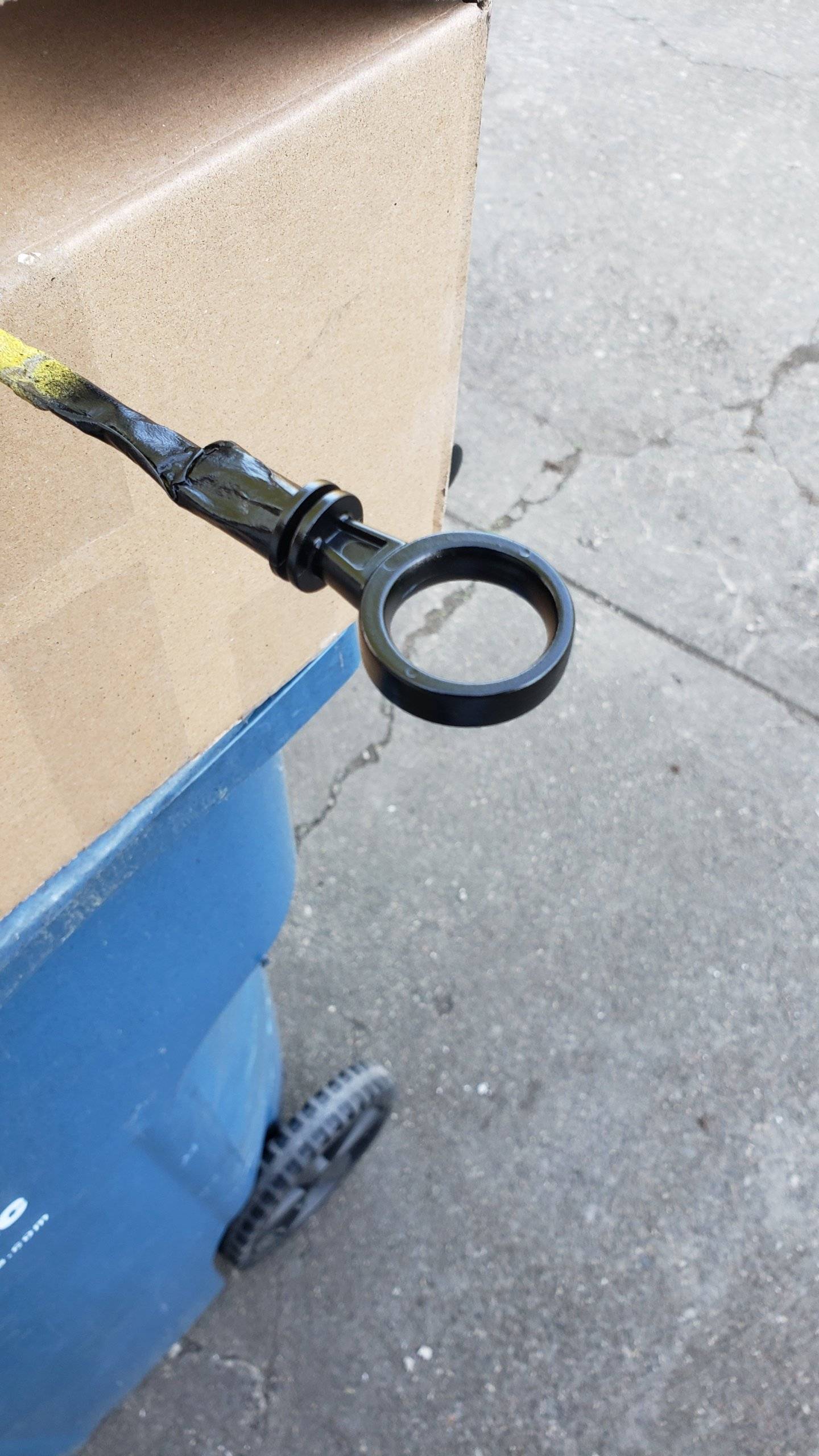

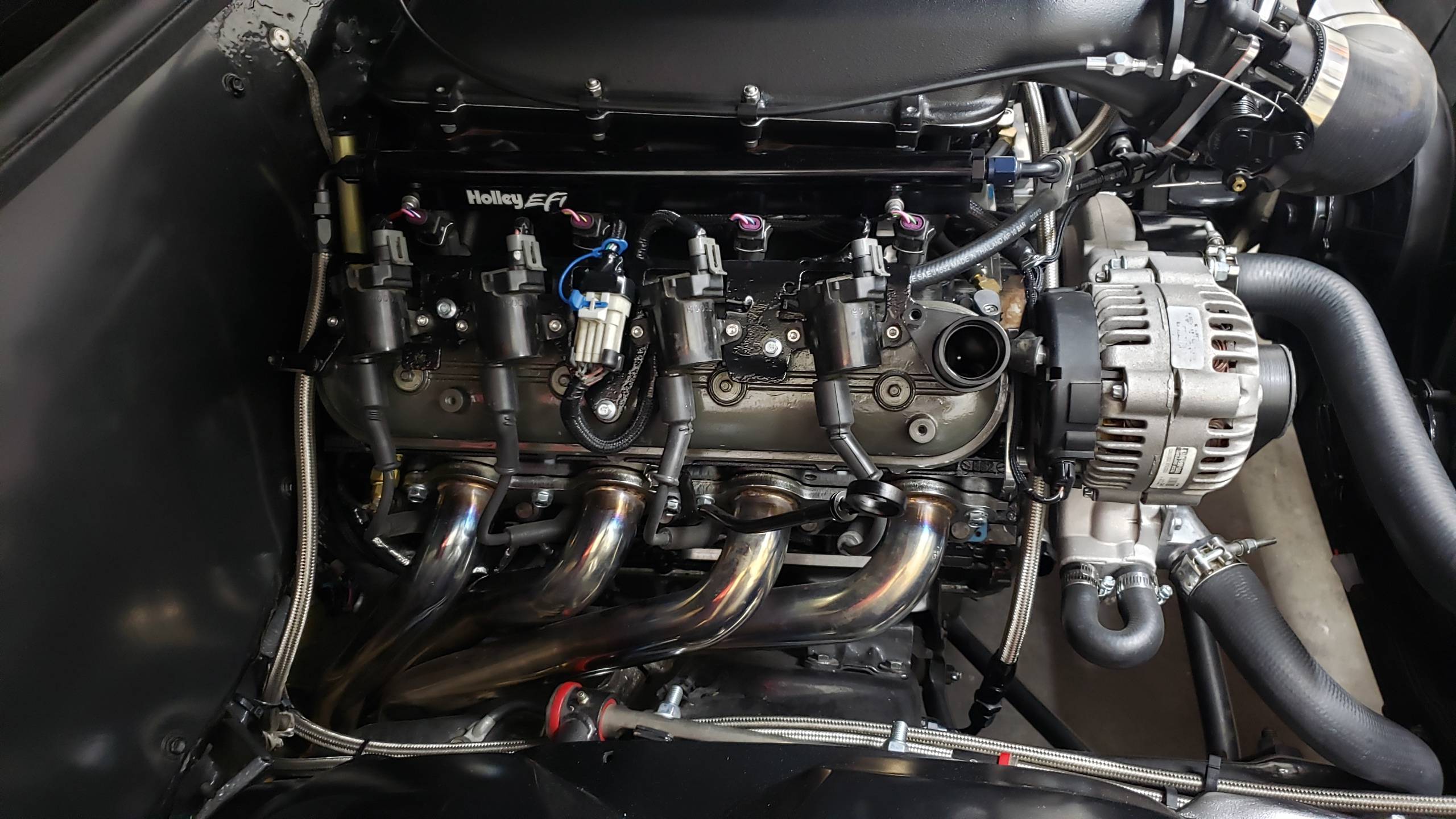

Painted the coil brackets black along with dipstick handle to help them hide better. It's silly, but bright yellow is out of place lol. Everything is back together minus the covers.View attachment 172981View attachment 172982View attachment 172983
I changed the oil on the 2+2 this weekend and I put a ton of black schmoo on the yellow dipstick handle and thought "Huh, well I guess it was clean for like a year, meh."
And then I see you painting it black, attacking my feelings lol.
I pulled it from a '97 Lumina but I believe 97-01 or something like that is the year that youll want. Monte Carlos come with the same module. I wasnt able to get into the trunk area so I pulled as much harness as I could through the package tray where it was located and used that. I tapped into the necessary wires at the kick panel near the lock relay and didnt need to extend any wires thankfully.
