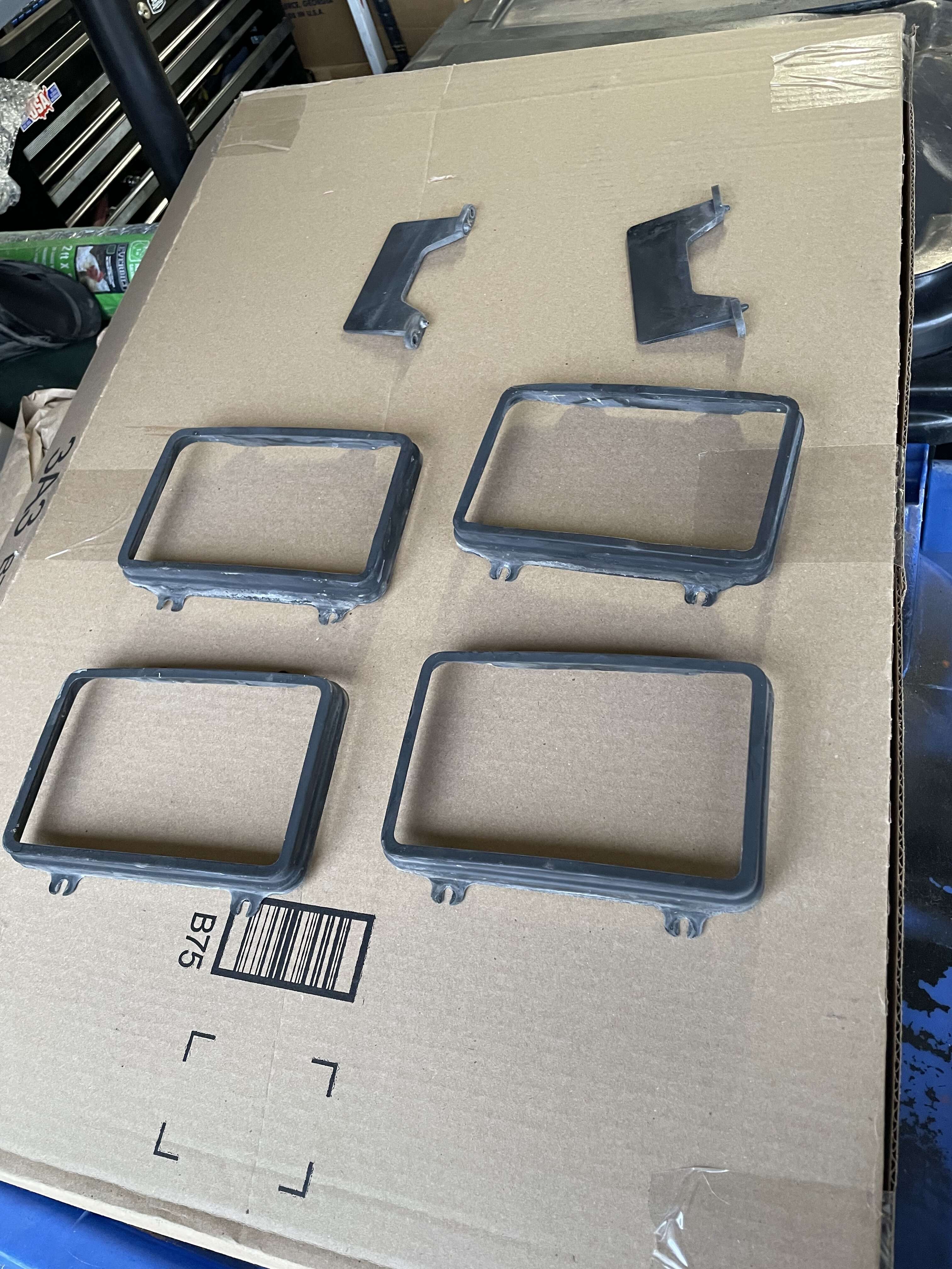

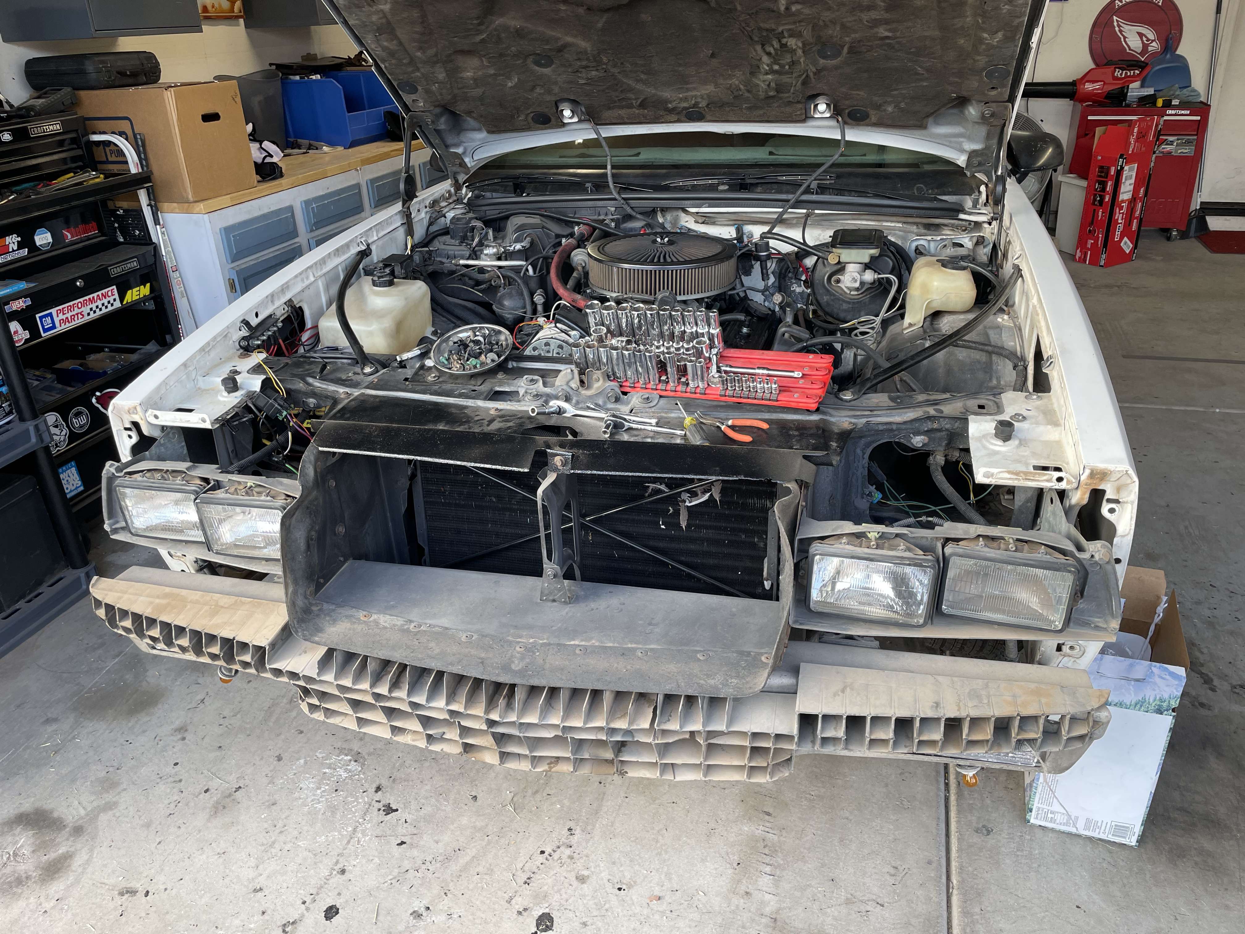

In preparation of the H4 bulb and lens upgrade I got from Dixie Restoration, I removed the front cover to get a better access to the headlight trim rings and dividers. I know they’re accessible from the front without removing the cover but I didn’t wanna scratch the edges of the cover more than it already was and this gives me a reason to clean behind there as well. I got the trim removed and will clean it and paint tomorrow. It’s cloudy and rainy here in Arizona this week so I need to find the right time with just enough sun. Never thought I’d have to worry about that here. Any suggestion on things to do while the cover is off and I have access to this part of the car?
Get those bird feathers off your radiator.

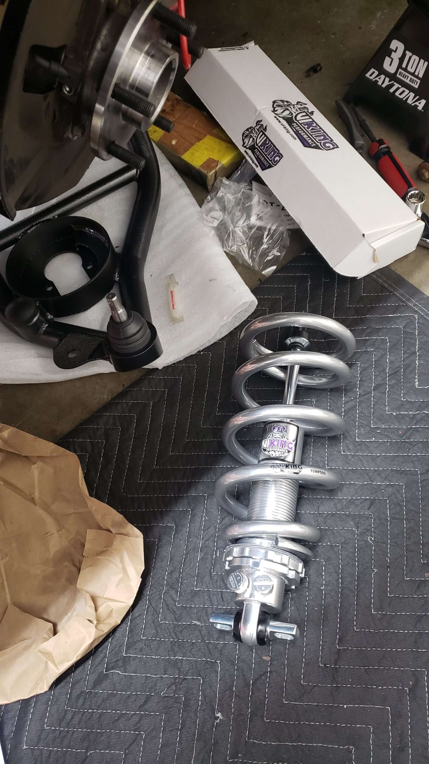

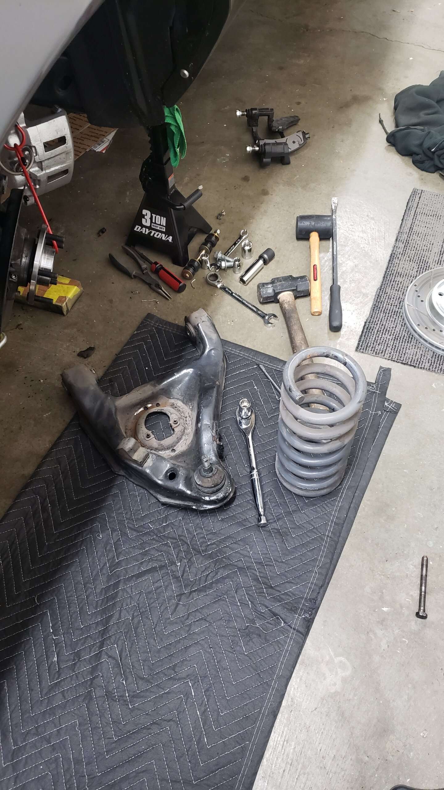

Driver side is basically done. I'll need to torque the a arms once the weight is on the suspension, and adjust the coilover. Dang it looks good, can't wait to see how it rides but that'll be a bit obviously. Couldn't find the right metric hardware for the a arms, so I swapped to 1/2" which required opening up the holes in the frame.
