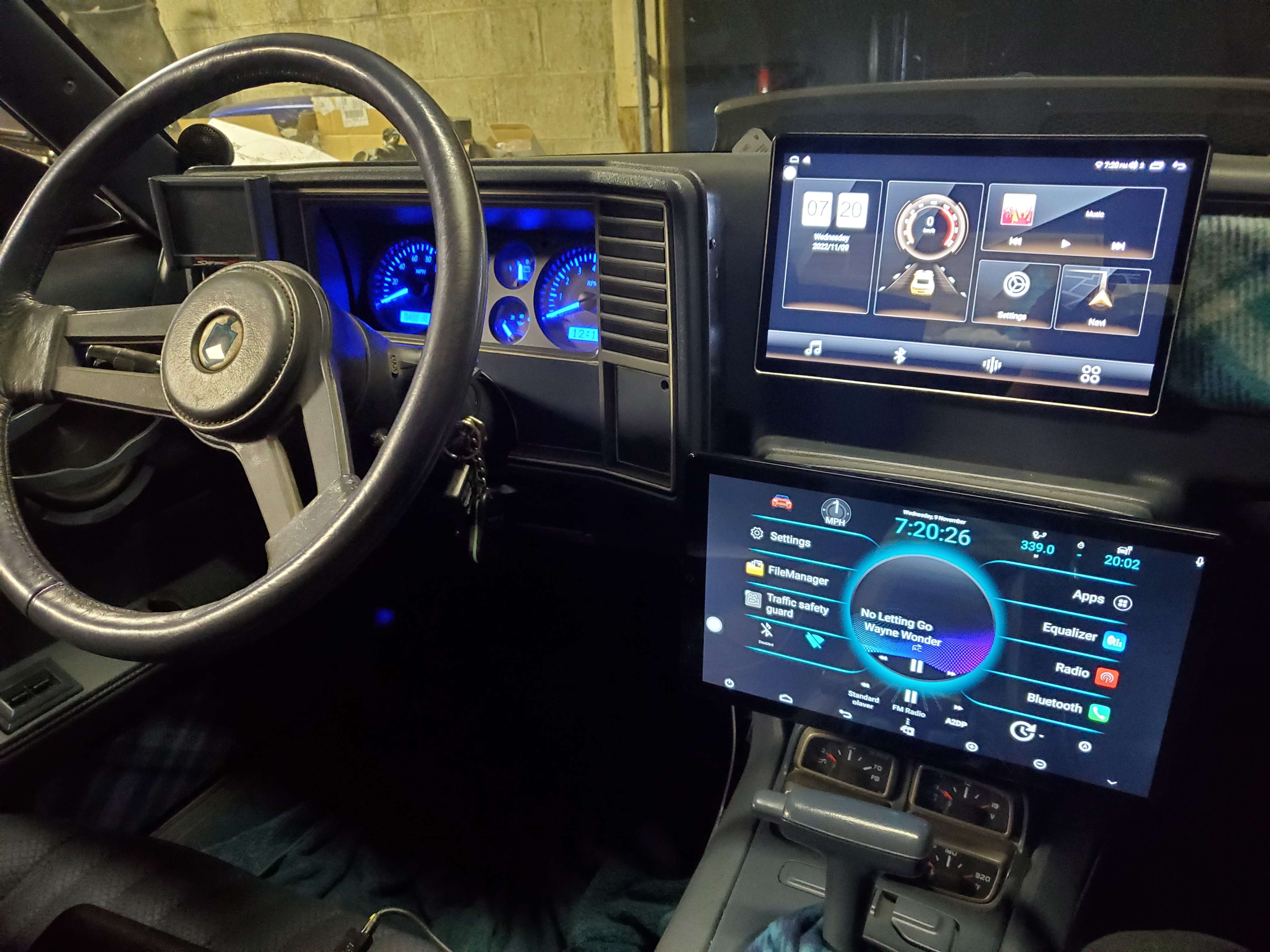

Had a bit of success finally but wasn't in the right area, decided to install that new to me head unit since Holley only sent the connector and not the pins with it. So now I have to call today to ask for them and wait another week, which I guess will be OK since the guy with the distributor still hasn't got back to me about finally shipping it. Kind of a big question to finish off the radio stuff, looked on here and saw people saying dark green wire would be the correct one for the gauge wiring. Well for me that is part of the brakes so whenever I press them the headunits react, which wire is the tap to get them to probably adjust with lights?

When I was trying to wire my illumination wires I used a post wiring up gauges that is no longer open for replies but it said that it uses a dark green wire which when I used it now lights up my head units when I hit the brakes for use a turn signal which means it is one of the tails. From this post I was taking the grey wire to mean on the head unit wire harness side which is it on the car?
Now after reading this in the other thread I need to ask if you are trying to get the lighting for when you turn on the parking/headlights? Or is this to power the back light when the head unit is on? If you need the back light on when the key is on then you'll need to either tap in the fuse box port at the RADIO fuse which is for circuit 141 (uses a brown/white wire when factory hard wired in), Feed, Ignition Switch, "Accessory & On" Controlled , or tap into the brown 12 gauge accessory power wire (circuit 4, Feed, Ignition Switch "Accessory & On" Controlled, Unfused) to run a new fused line to the head unit. This way, key at On or Accessory you'll have the back light. I can't figure out what green wire that you did tap into to power it.
