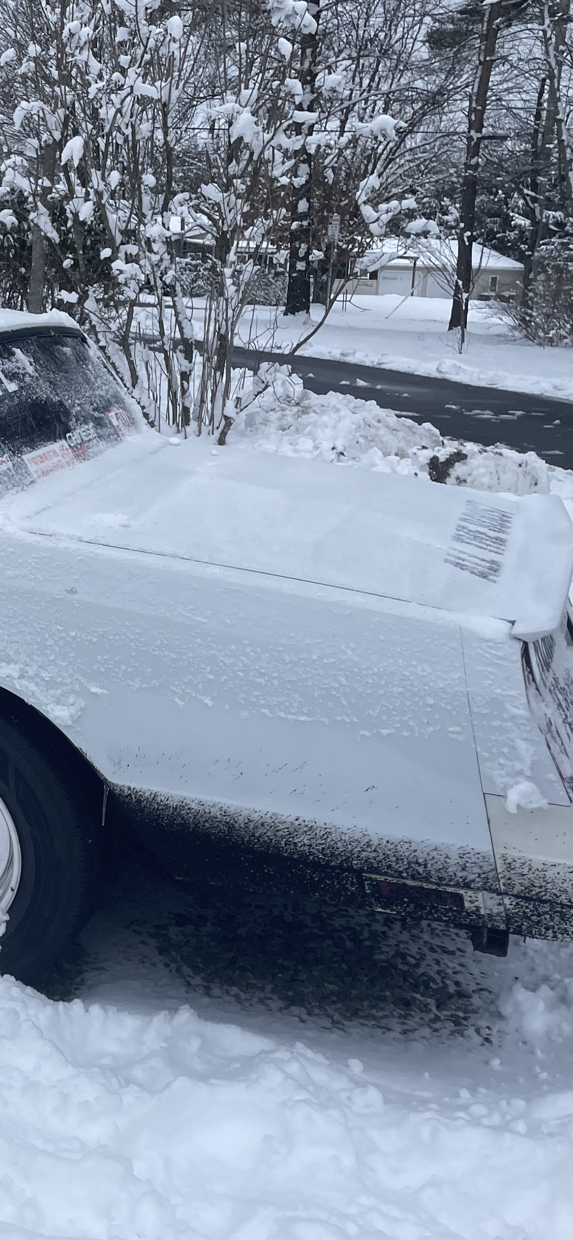

I did a rough trim on my 6.5" Glasstek Sunoco hood for the Monte, I had to cut almost 2" off the rear to keep it from hitting the windshield.
I still have to drill for the hood pins and then finish sand it which will give a bit more clearance at the windshield
I love it. We have the 4” and really like them. The Glassteks are a quality piece. I kept mine off the windshield when up, but he s his about like yours lol.

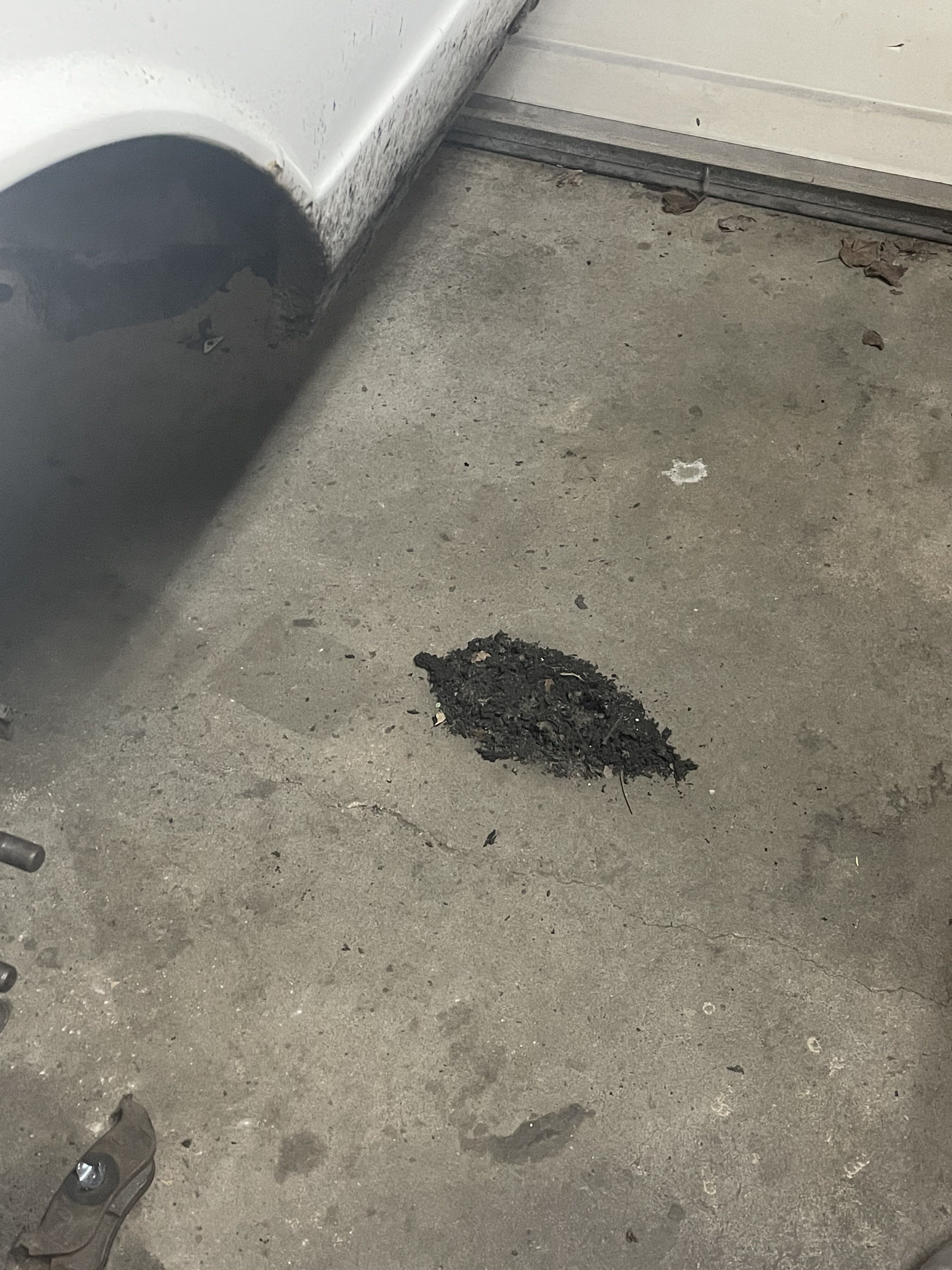

I decided to clean off the black. Hello remains of Mickey Thompson!!
I have to wait until it’s hose weather to give a proper cleaning.

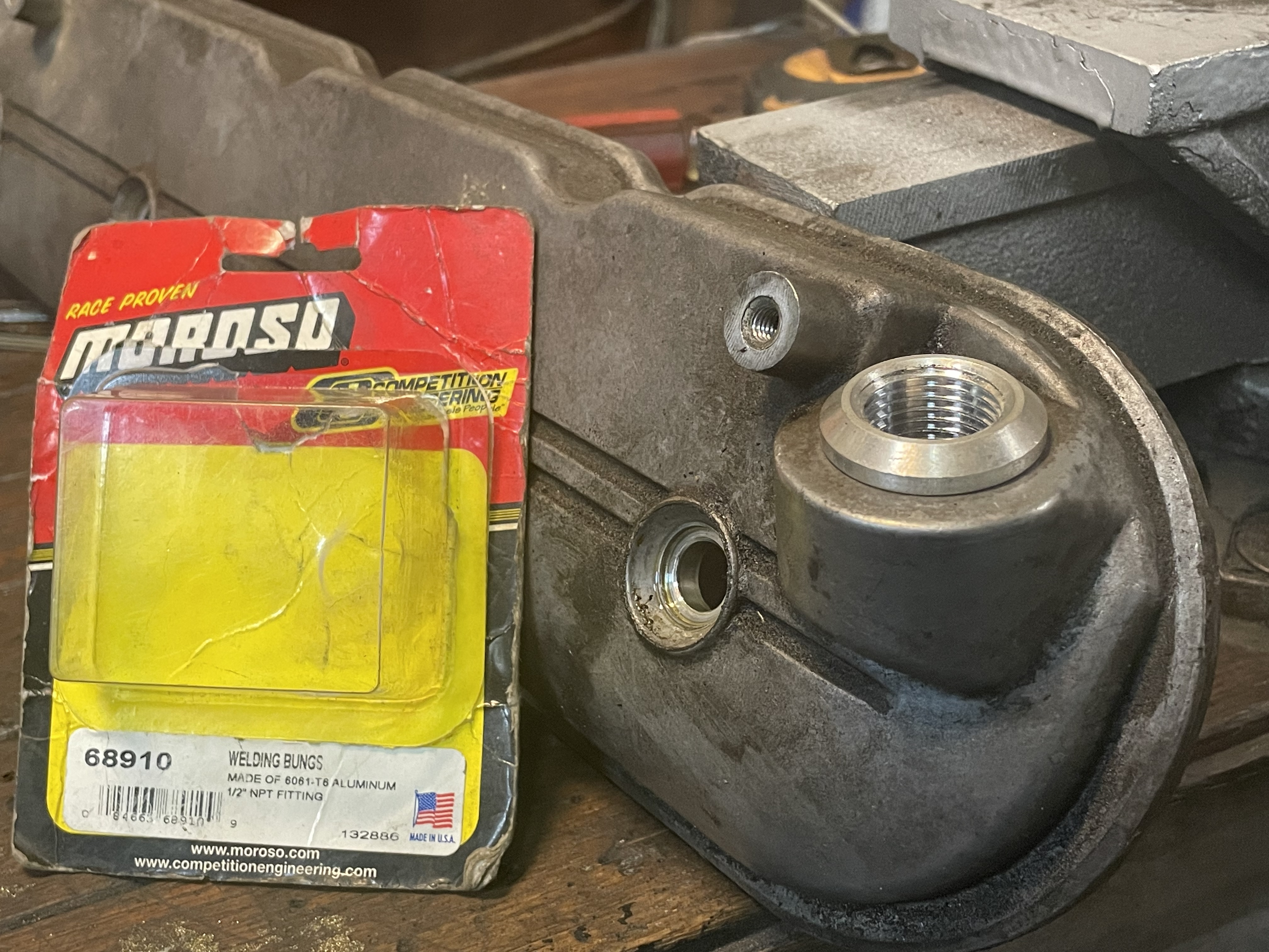

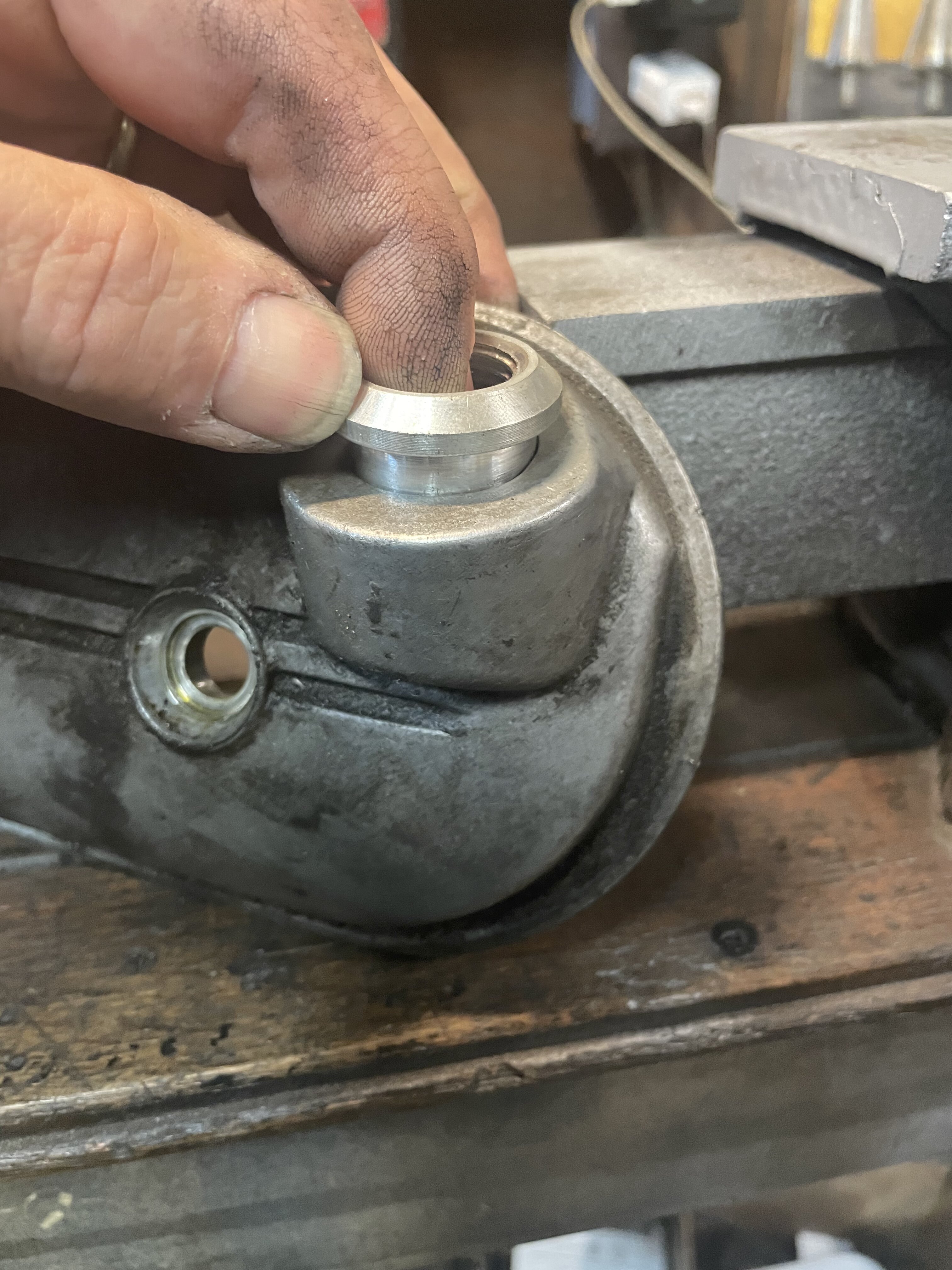

Making a minor mod to the valve cover and saying goodbye to PCV. I’m going to run a breather line from each valve cover rather than just a single line.
It seems that at about 32-34lbs of boost I pushed out the PCV valve. It never did with the stock pistons, but one of two things must be happening, either a bump in compression or a different ring package is causing the issue. Perhaps the turbo that is another couple of HP has something to do with it well. Whatever is causing I, a threaded fitting should keep the hose connected lol.
View attachment 218251View attachment 218253
Making a minor mod to the valve cover and saying goodbye to PCV. I’m going to run a breather line from each valve cover rather than just a single line.View attachment 218254View attachment 218255
Why not just tap the valve cover itself? It'll give you a bigger OD and breathe even better.
I’ve been running a single 1/2”’hose for a while, I think two 1/2” vents will be plenty. I have a plan to run an in-line PCV that I can swap on for street driving.
I have a 3/4" hose plus the factory 3/8" hose breathing on my dually and I still think I need more. Same with my Camaro. I don't think overkill is possible with crank case venting, and with the adult boost you're pushing I'd err on the side of all the overkill. Adding those 3/4" hoses dropped my oil consumption in both from "I should rebuild" to "meh".
