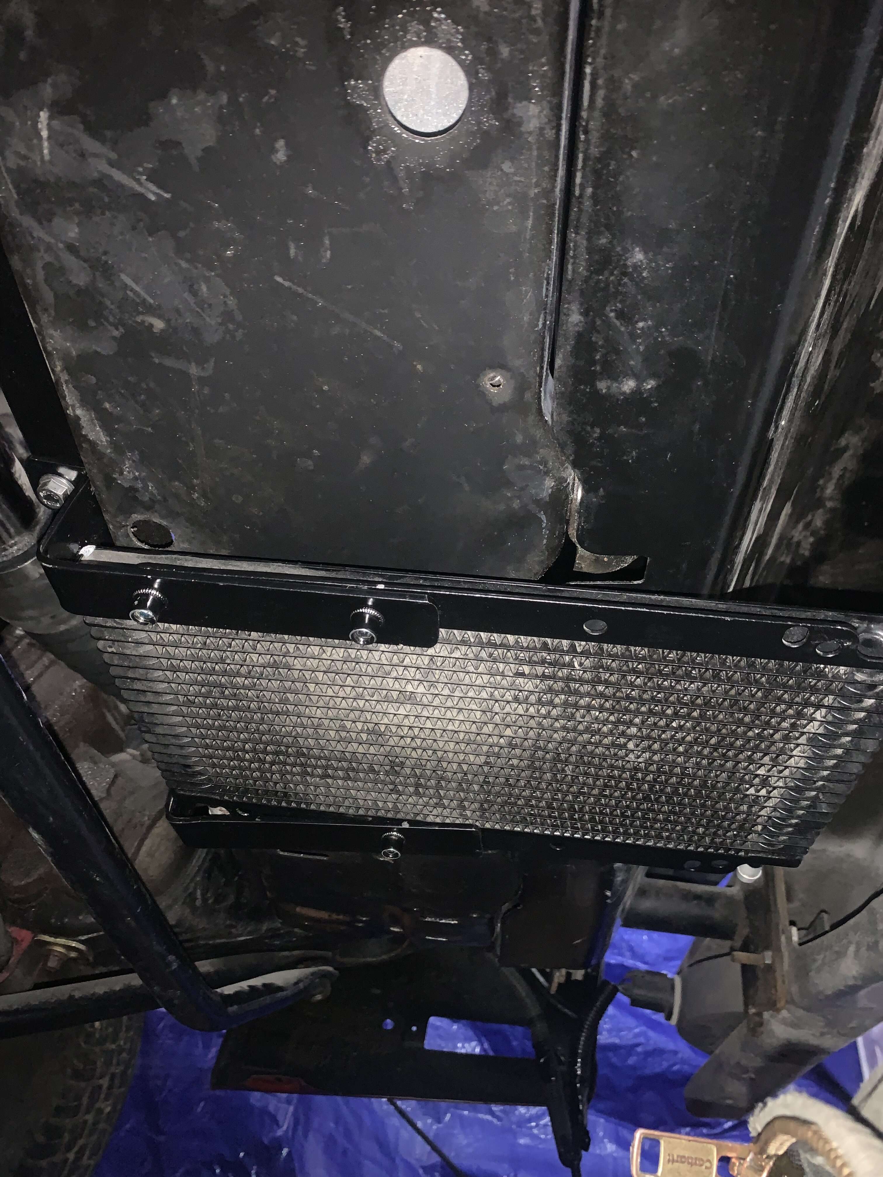

Stuck a power steering cooler underneath the core support.
While it’s not the best place for it, it’s higher than the brace bars, so it should be relatively safe here. Debating on a fan or ductwork for forced cooling. Also need to grab an auxiliary fan for the transmission cooler.
Can you fit it behind the core support? As it is it's really only going to act as a heatsink.
I think anywhere I could move it to will just put it into warm air in the engine bay. I’ll be running headlight covers so there’s now going to be much air moving in the areas behind the headlights compared to a car without them, and the HID ballasts are in the way elsewhere.
I need to look but I might be able to mount it out on the driver’s side directly under the core support outside of the frame rails now that I’m thinking about it.
Even so, warm airflow may be better than cool air exposure. I put the oil cooler for my Camaro behind the radiator as I don't want the oil cooler to steal cooling from the radiator, but the oil still runs a good bit cooler than it did without. I also put my PS cooler behind the radiator, same idea. A friend put his oil cooler behind the core support horizontally, I've even seen guys do it that way with a scoop.

I'm curious as to why a power steering cooler is needed on a street driven car? Does your power steering fluid get hot? Or is this car driven in autocross or something like that?
I’ll look at it again tonight, I’m using Intrepid fans with a generic dual pass radiator, and the bottom of the radiator is stepped forward to clear the steering box. I should have the space for a fan on the front of the cooler in that area.
Switching to a hydroboost setup, and the car will see road trips once it’s done with the possibility of autocross or racing in the future. Need to feel out what I like first.
There’s space for a cooler there if I had one about 2 inches smaller in height and 3 inches narrower, this one hits the fans no matter how I mount it.
If I never bought this dual pass radiator that wouldn’t be an issue. Guess I’m shopping for a couple extra fans over the weekend.
