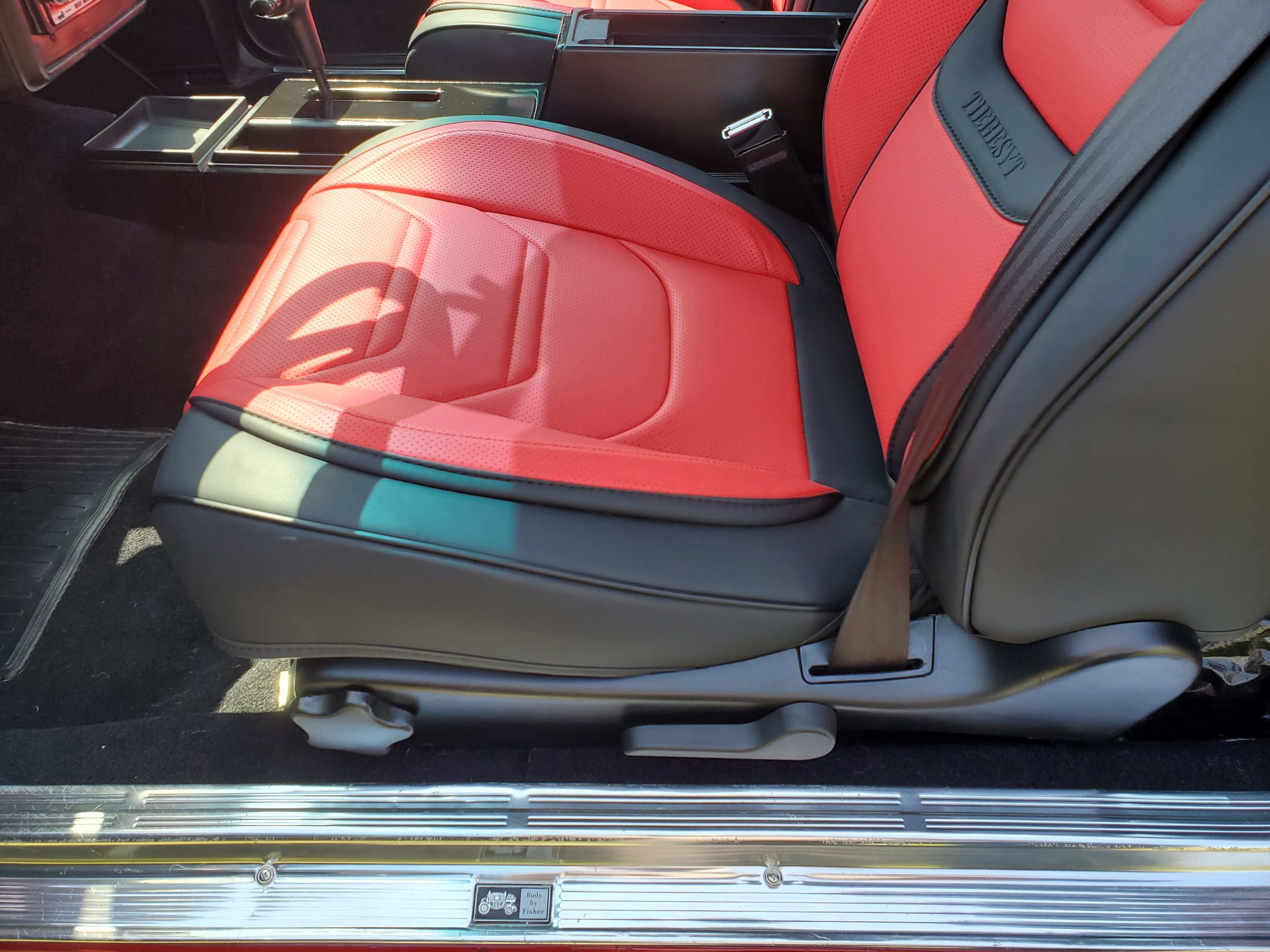

Thanks. Took me a month to figure out how to lower the car seat base and tracks to get those things to fit.
I'm interested in hearing/ seeing more of that if you've got the time to start a thread. With seat swapping being such a popular mod I bet I'm not alone...

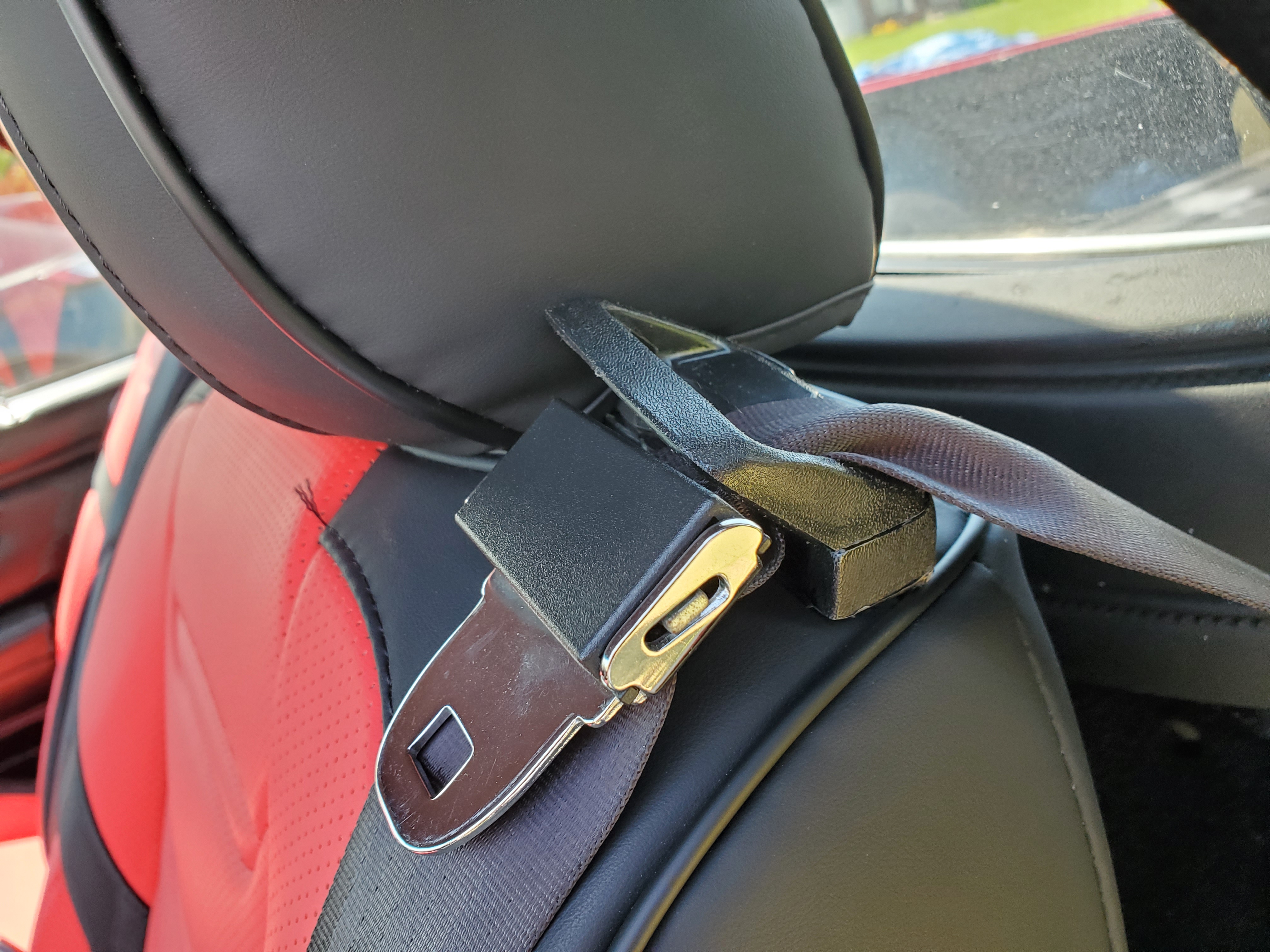

I wish I had taken more photos as I was doing this. I had to remove the original tracks and replaced them with 14inch wide tracks. Had to improvise brackets from side mount seat brackets which worked great to secure the new tracks to the base. I then also had to cut the plastic moulding along the bottom edge leaving just enough for them not to drag against the carpet. I also had to build a bracket for the seat belt guide near the headrest. The guide is not actually connected to the seat.
