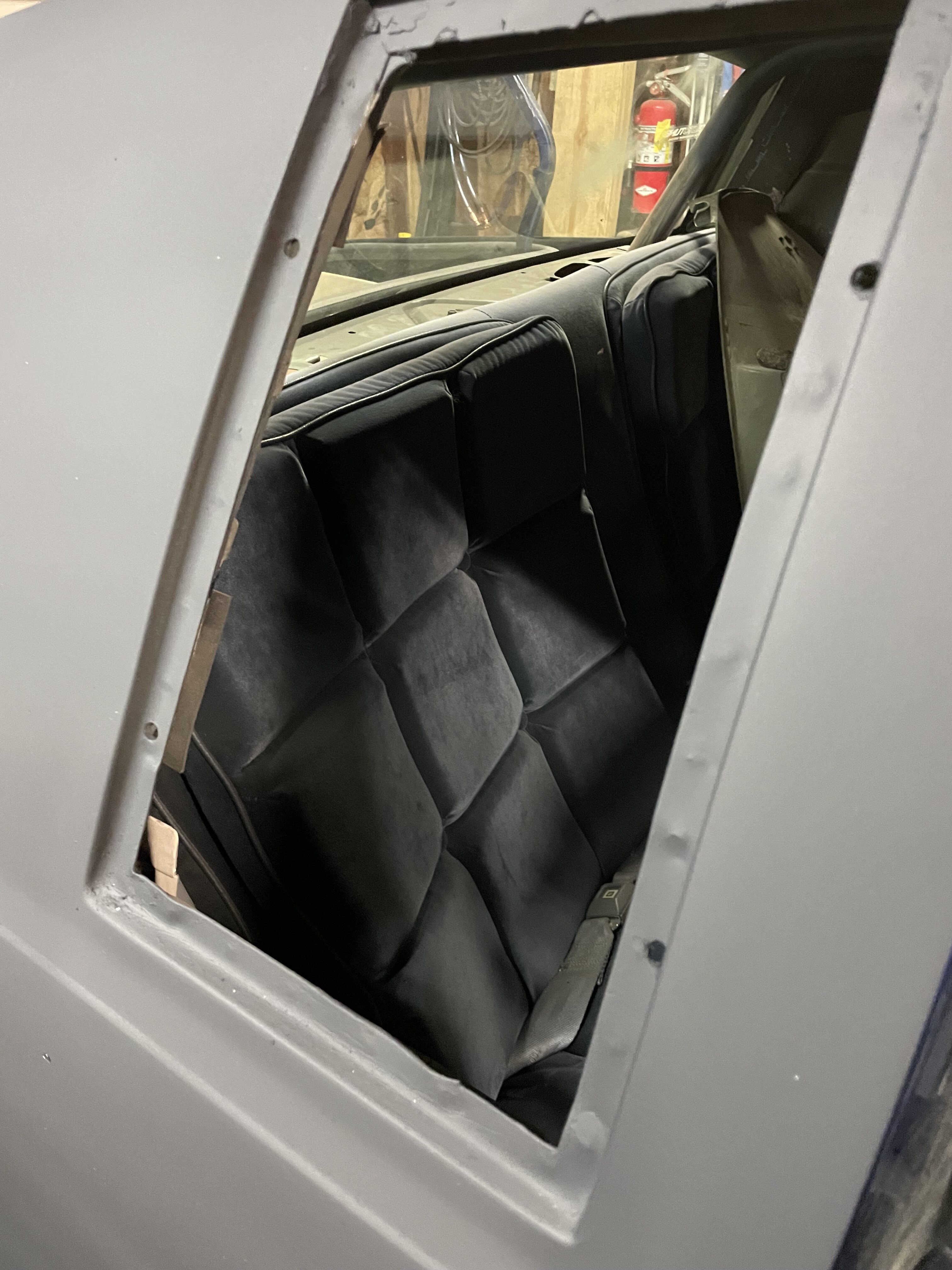

I’m looking for a sealer brand/type that goes on this :
I don't know a brand but whatever it is never dries or hardens, it's sticky and like snot, really gummy.
Butyl rubber. Comes in various sizes of "rope" and there's a slightly different type that's available as caulking.
