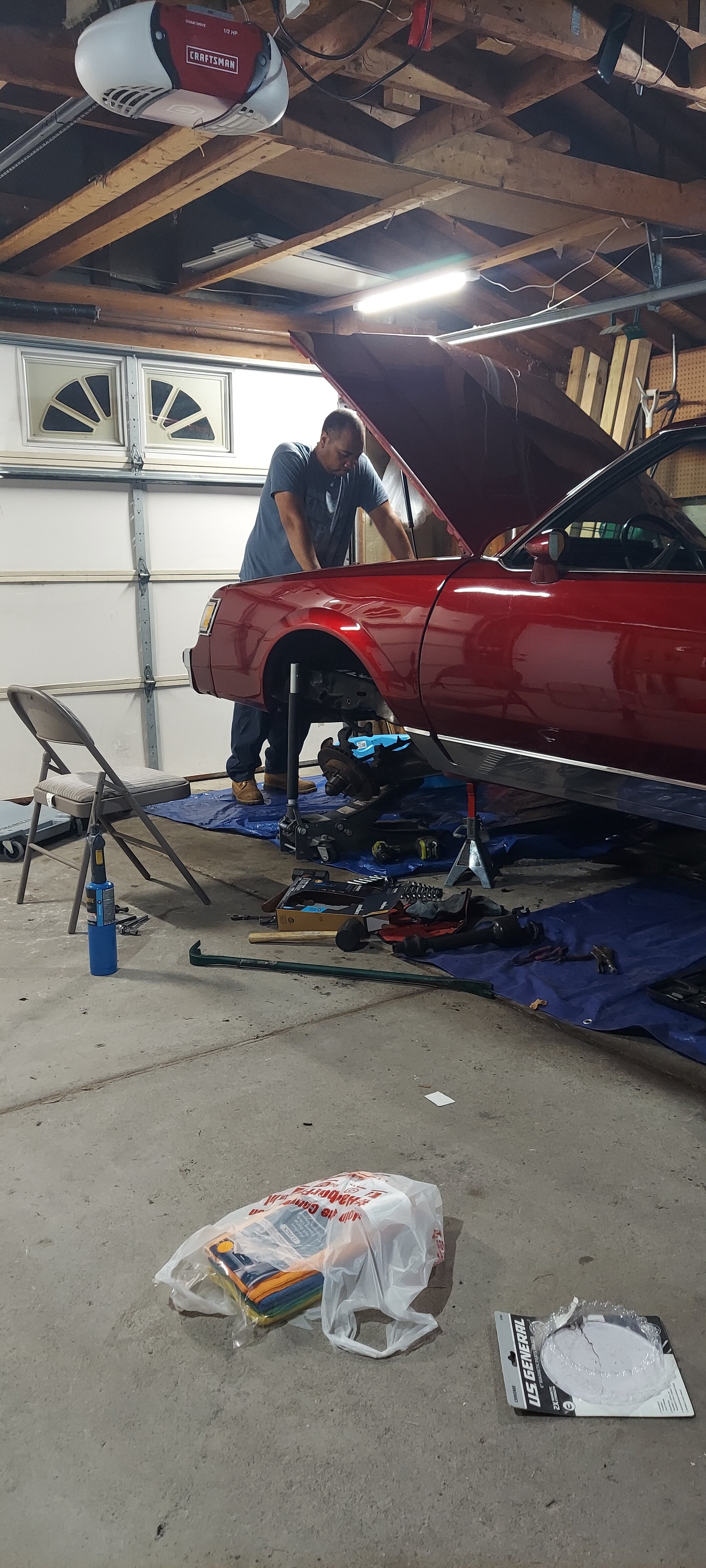

No more heating bolts for hours for me. Buy a grinder and cut off disc and be done with it. This kicked my butt when it didn't need to. I spent hours trying to get the bolts out of the lower control arm mount, but they were seized in the bushing. I beat on them, put a propane (yellow bottle) on them. Finally, I went to HF and took the grinder straight to the bolt. 6 minutes...DONE.
