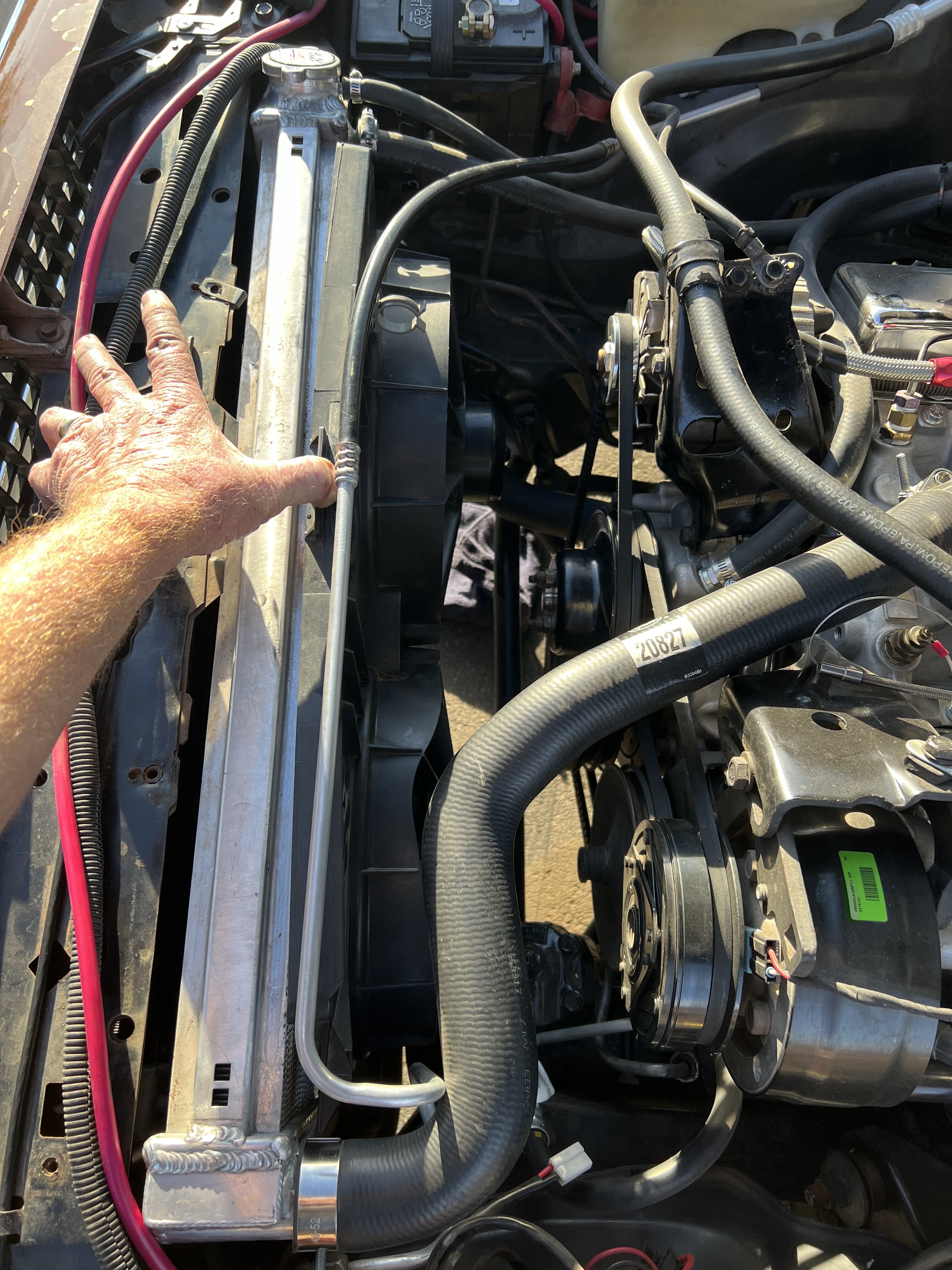

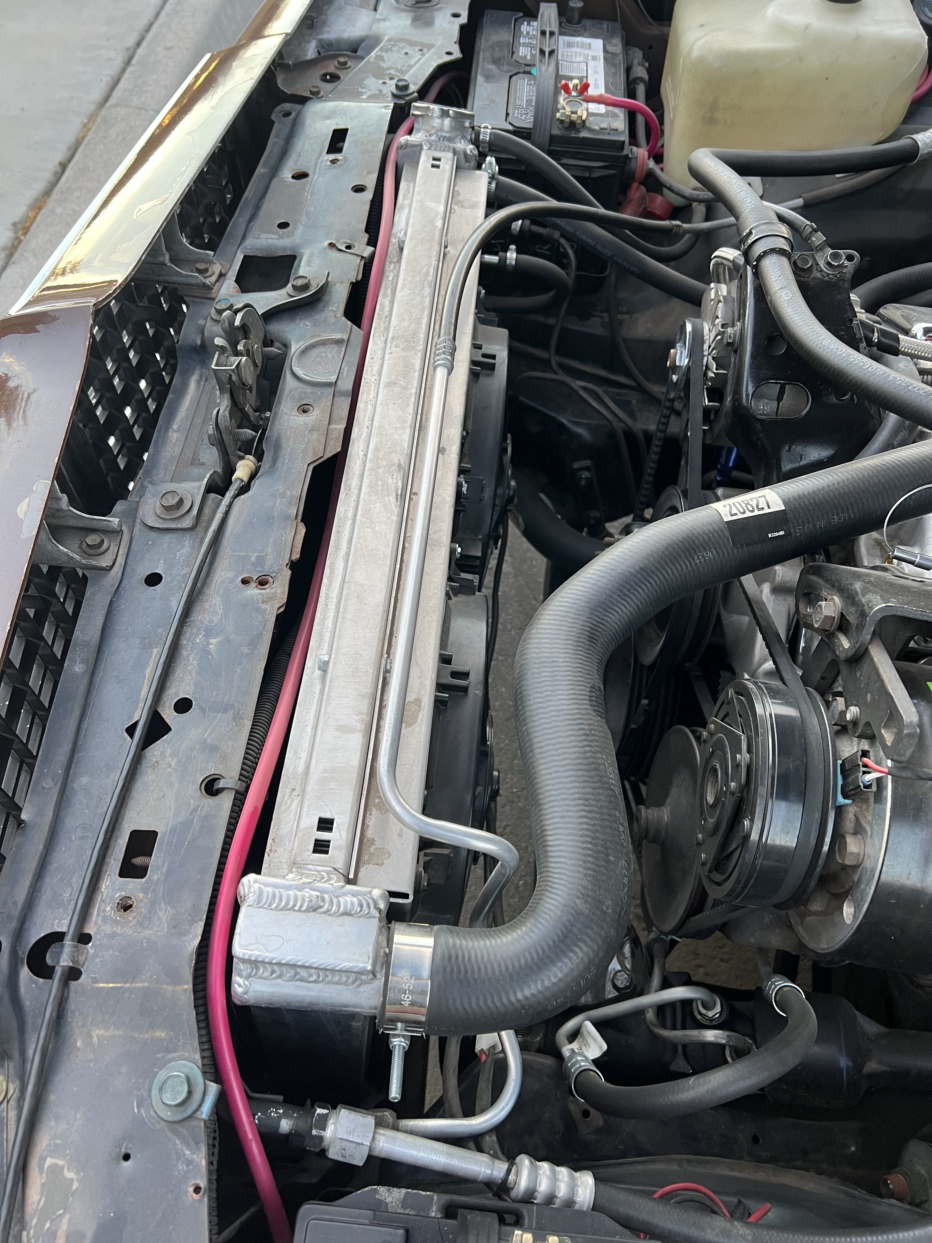

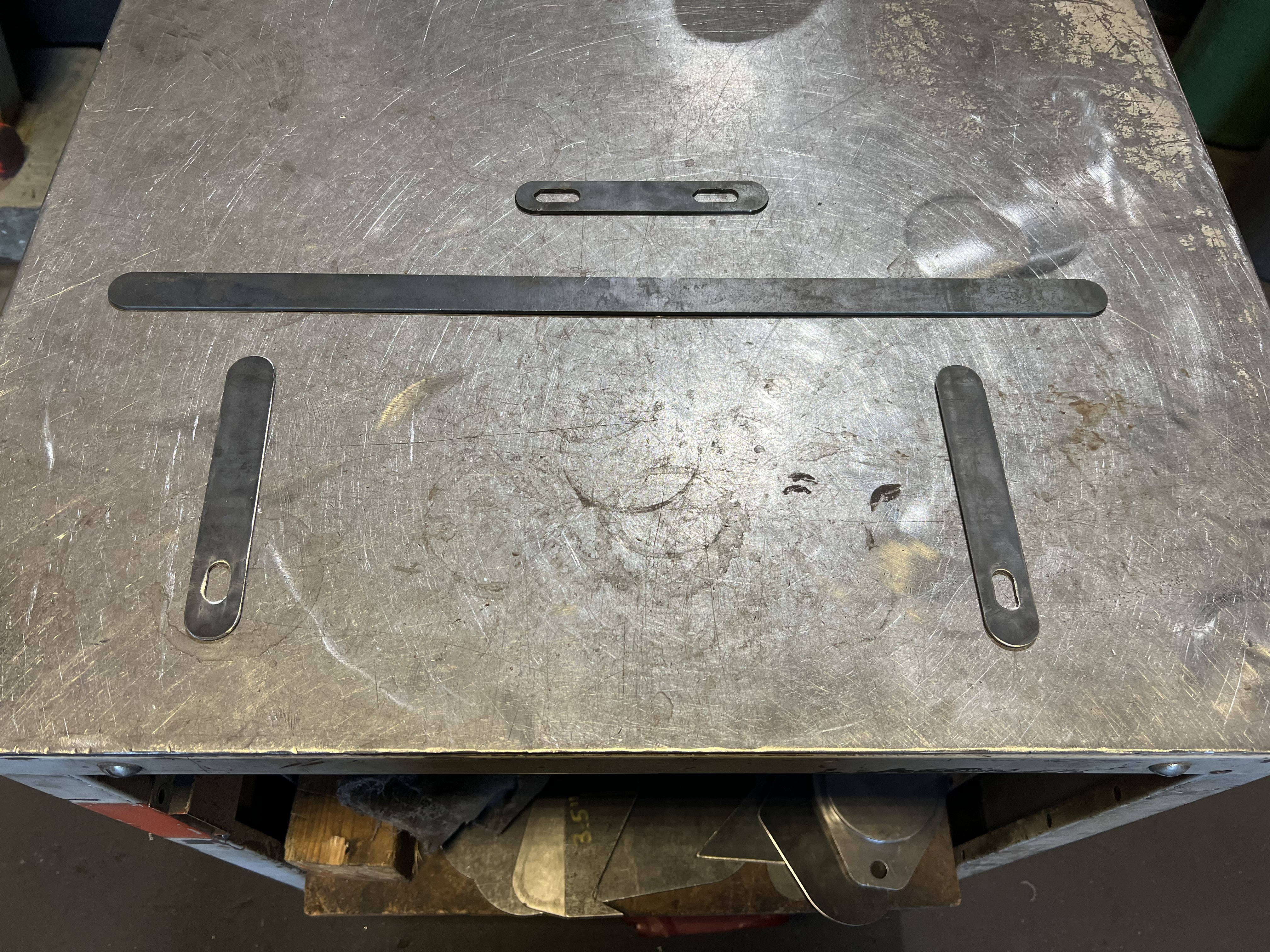

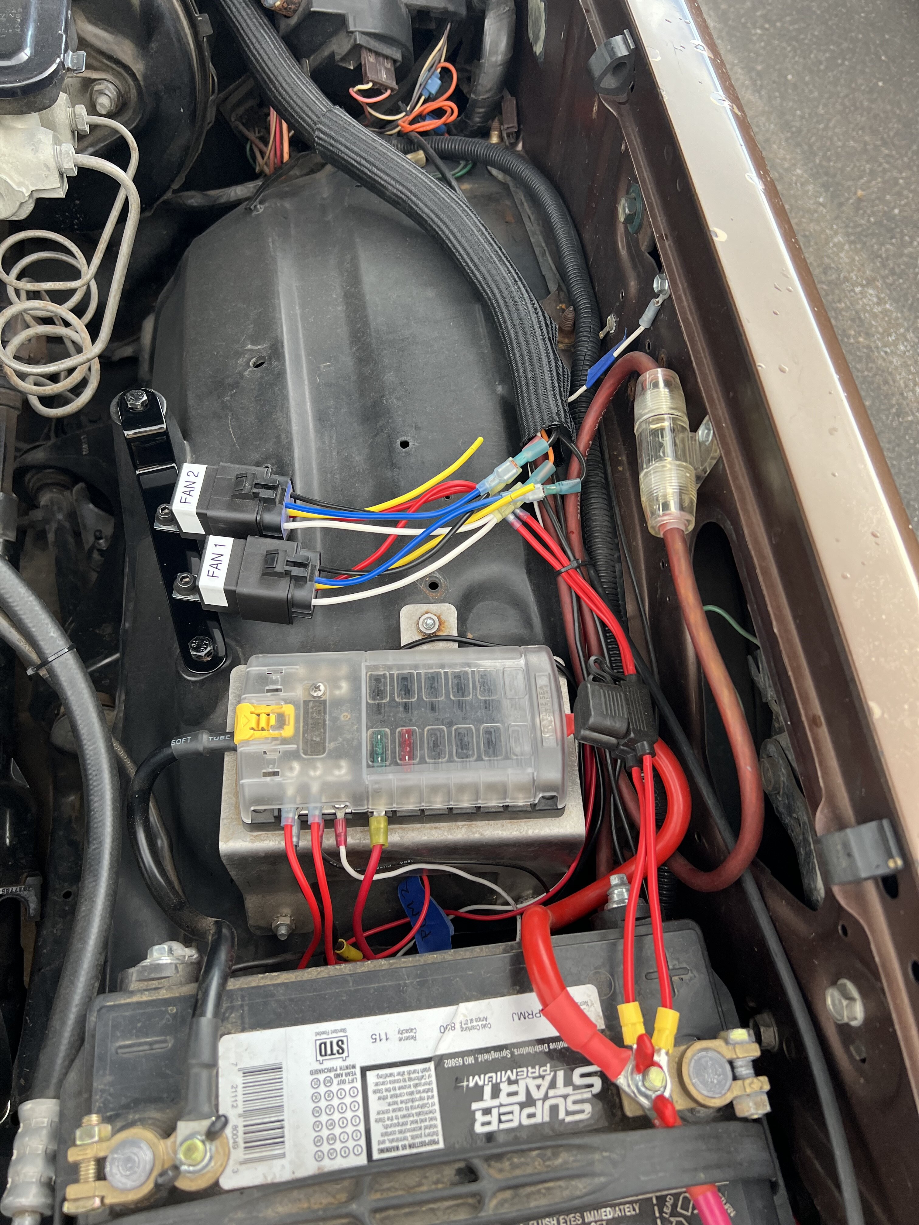

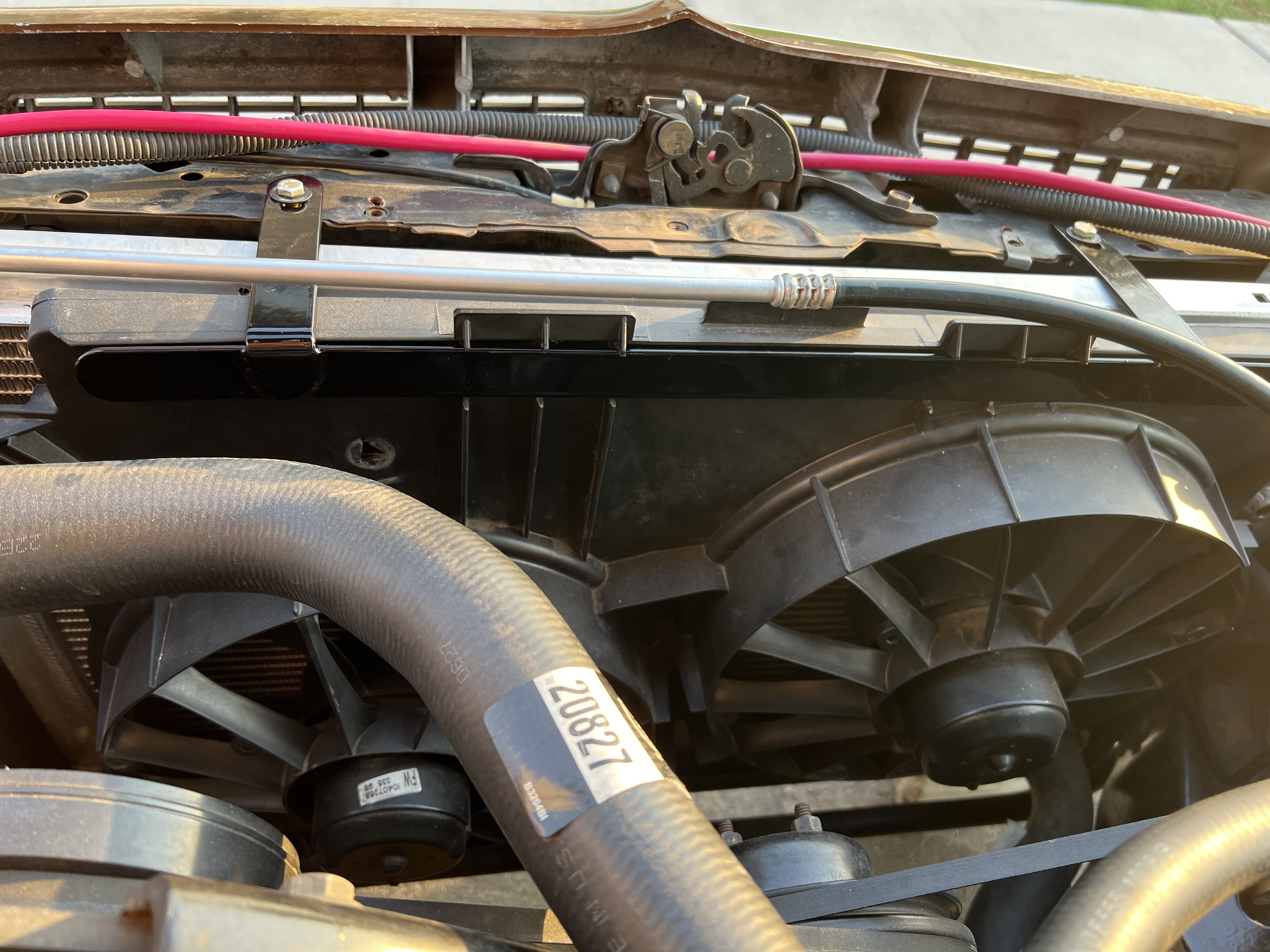

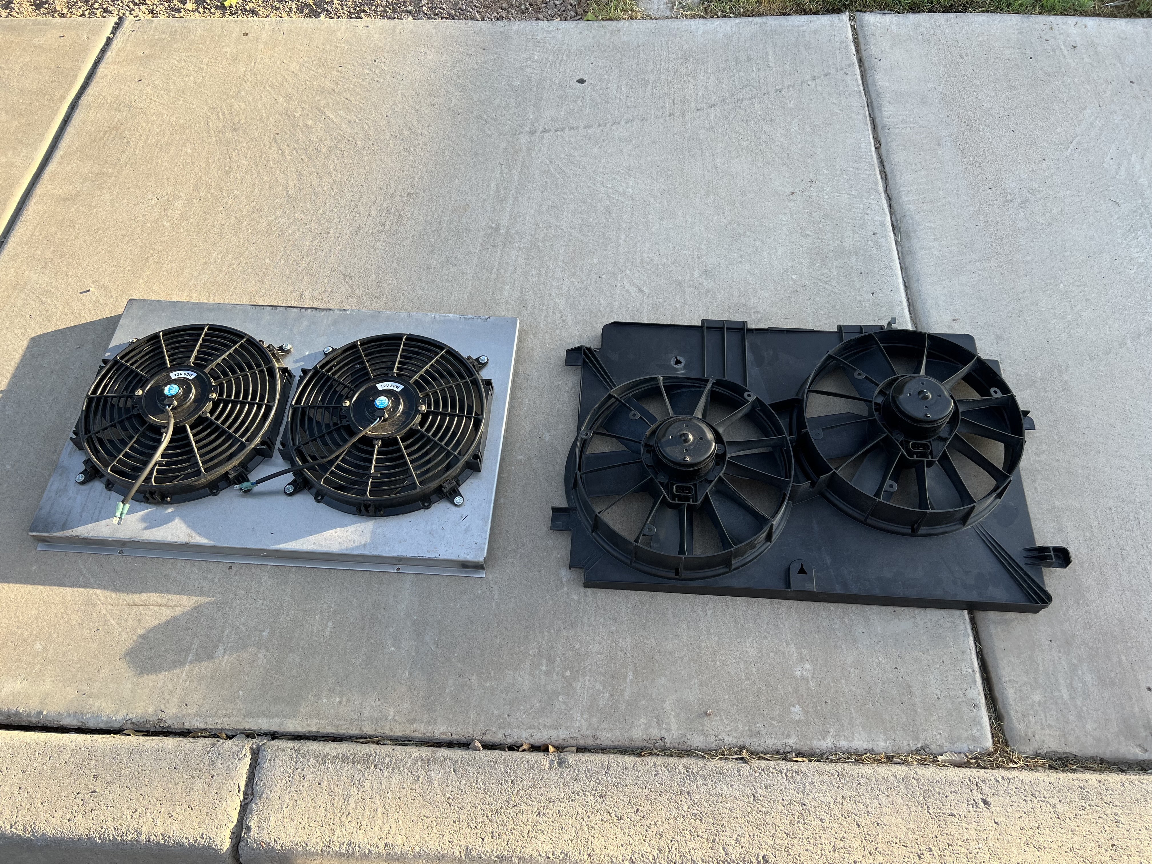

Swapped my electric fans for a set of LS1 fans. They are pulling more air than my old ones. I had to make some brackets for the mounts and made a bracket to mount the relays. Brackets are cut on the plasma table, bent in the press, welded and powder coated. I just need to finish putting the wire wrap on.

interesting battery setup you got there, using both sets of terminals. what's hooked up?
Main battery is for the car. 2nd battery is for the amp, power seats, electric fans and any other BS stuff. I want to add under dash lights as well as some additional lights in the trunk and under the hood. Just something I've always wanted to do.
