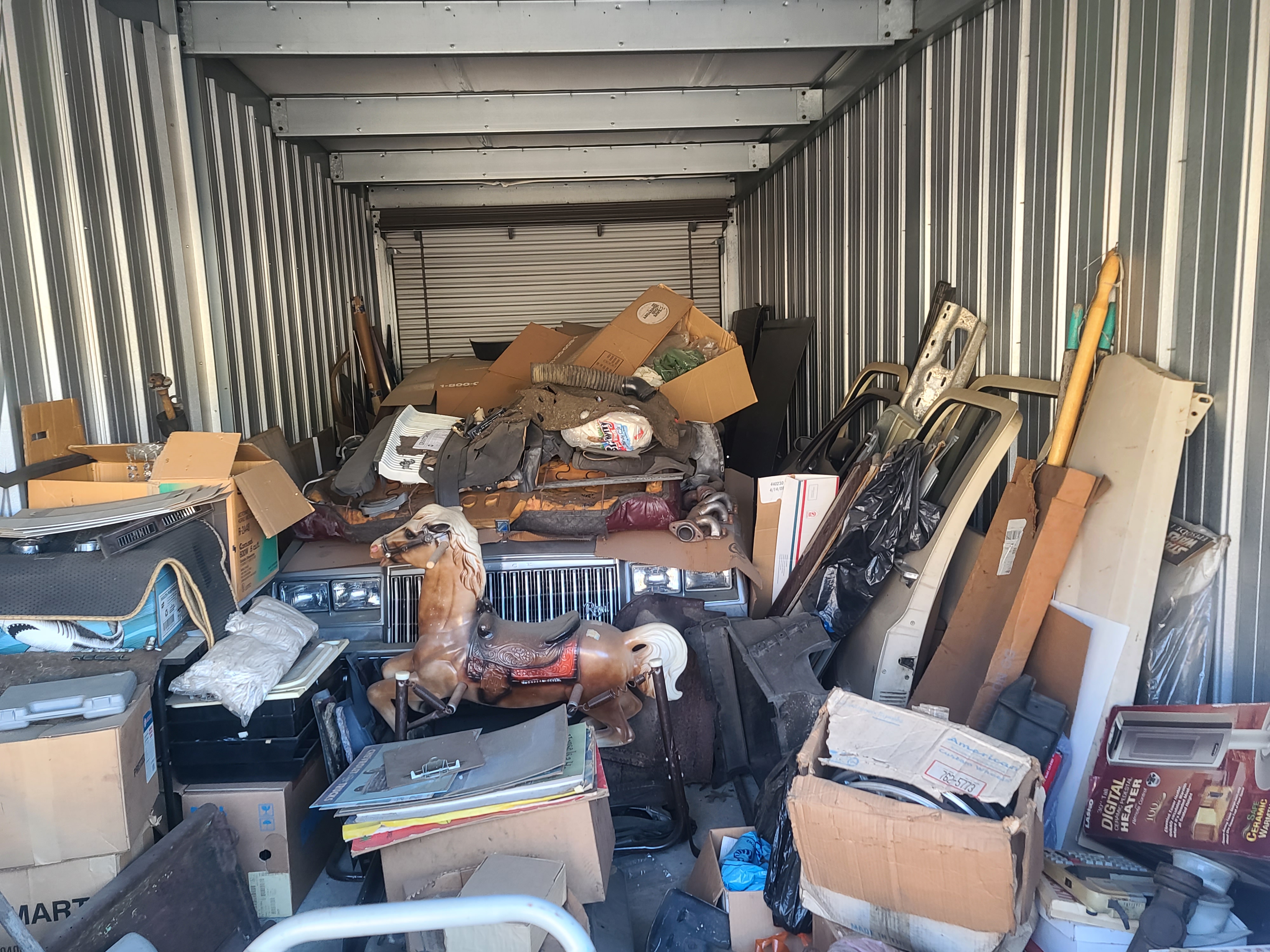

I opened a door for the first time since 1999.
Something here has 30-something thousand miles on it and saw its first daylight in over 25 years... well, at least a few square inches of it did anyways.
Looks like you need more crap in there.

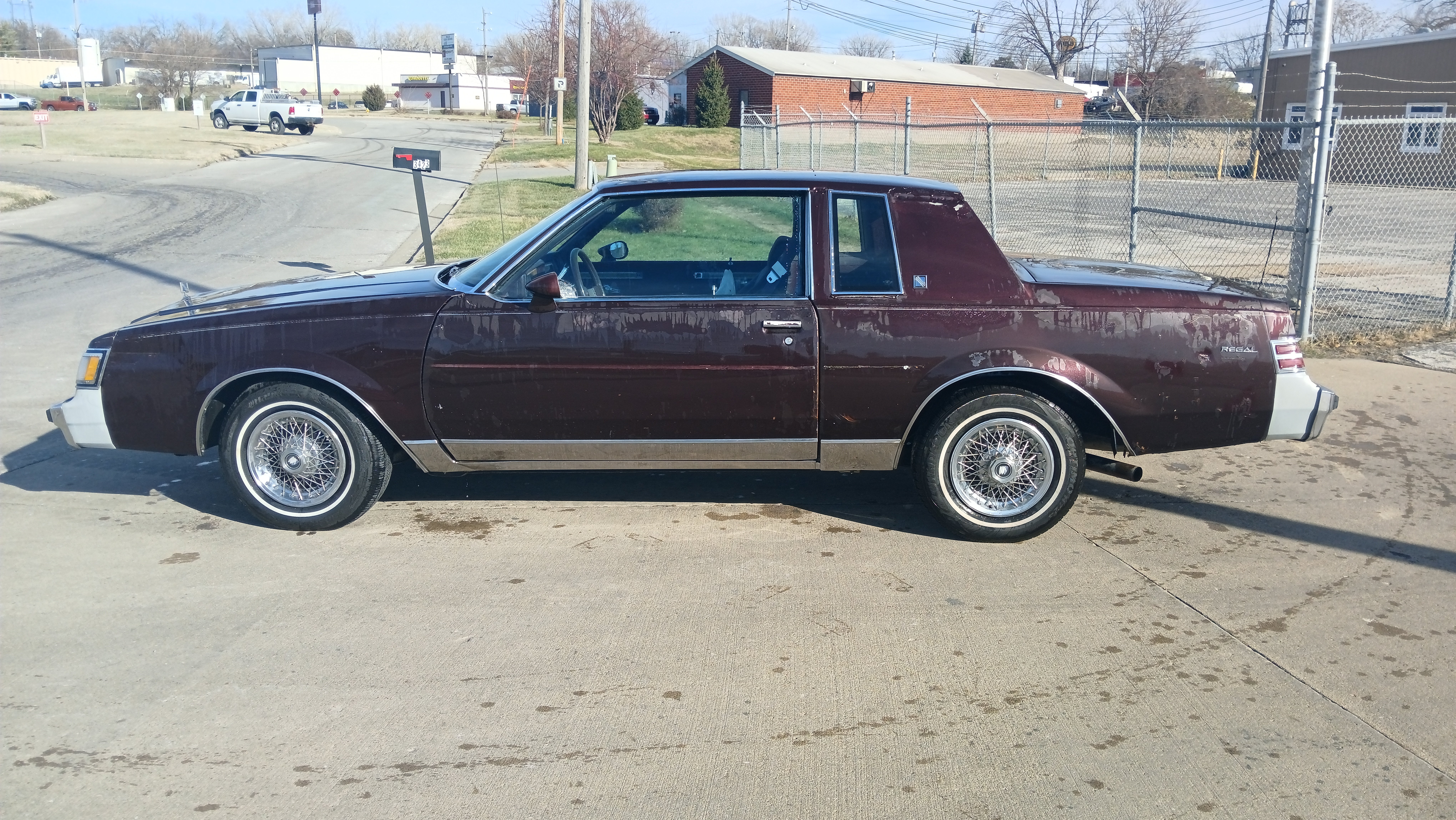

Washed it. I have a coolant consumption problem. I haven't pulled the plugs yet, but it doesn't smoke, coolant isn't oily, transmission isn't watery, oil isn't milky, it doesn't leave puddles, heater core I just replaced and isn't leaking, idk what's going on.
Perplexing indeed.
Perplexing indeed.
When was the last time the intake manifold was checked? I had a similar scenario (coolant missing) but no tell-tale signs when investigating just like what you've done. When the engine seized & I had to tear it down to rebuild I was looking for that smoking gun thinking head gasket. But what I found was intake gasket/s that were failing @ the coolant passages (BBC). Apparently water was siphoning off @ a slow enough rate that nothing stood out visually.
The intake is the only other thing I could think of. It's my daily right now so it's not too concerning but once winter hits i might pull the intake and check it out. Its an old casting TA intake from 1993, and for all I know could be warped.

I seem to recall that there used to be a dye you could pour directly into the radiator. After that you drove around for long enough that the coolant would get warm and the t-stat would open. When you came back to the garage and shut the engine down, you could then use a UV light to examine the engine to see if there were any places where a failing gasket was allowing coolant to escape.
Sounds like a plan
