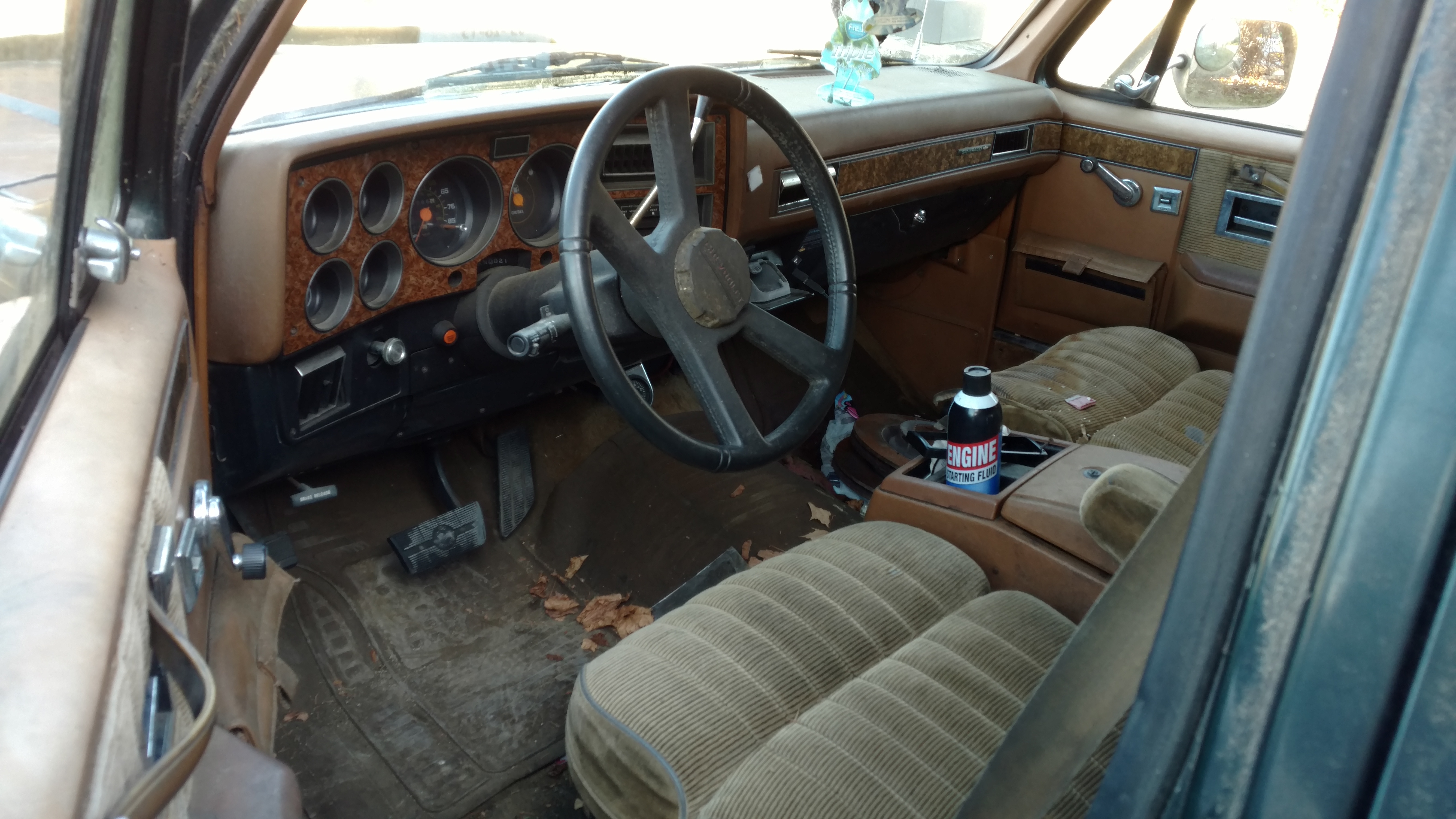

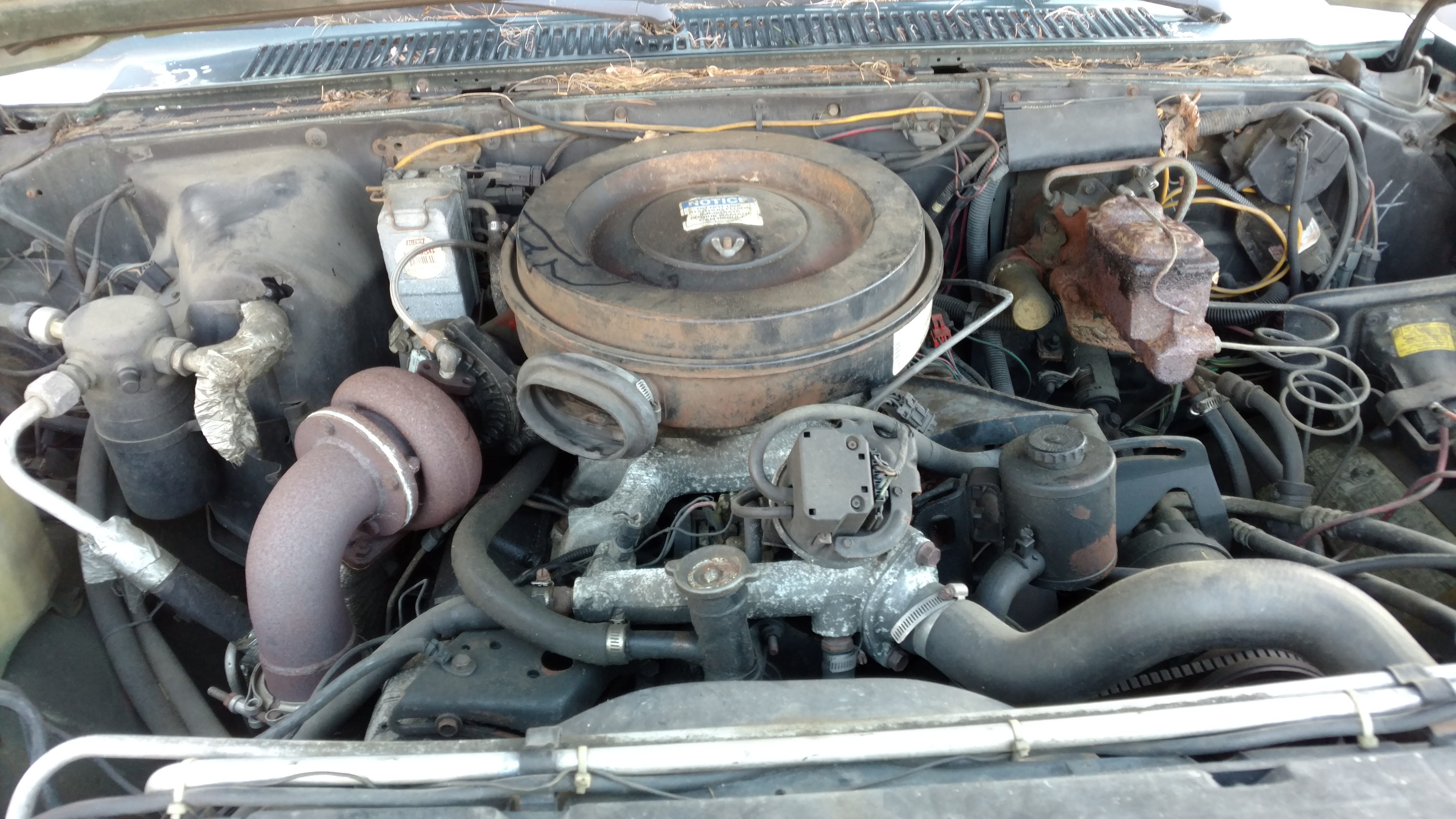

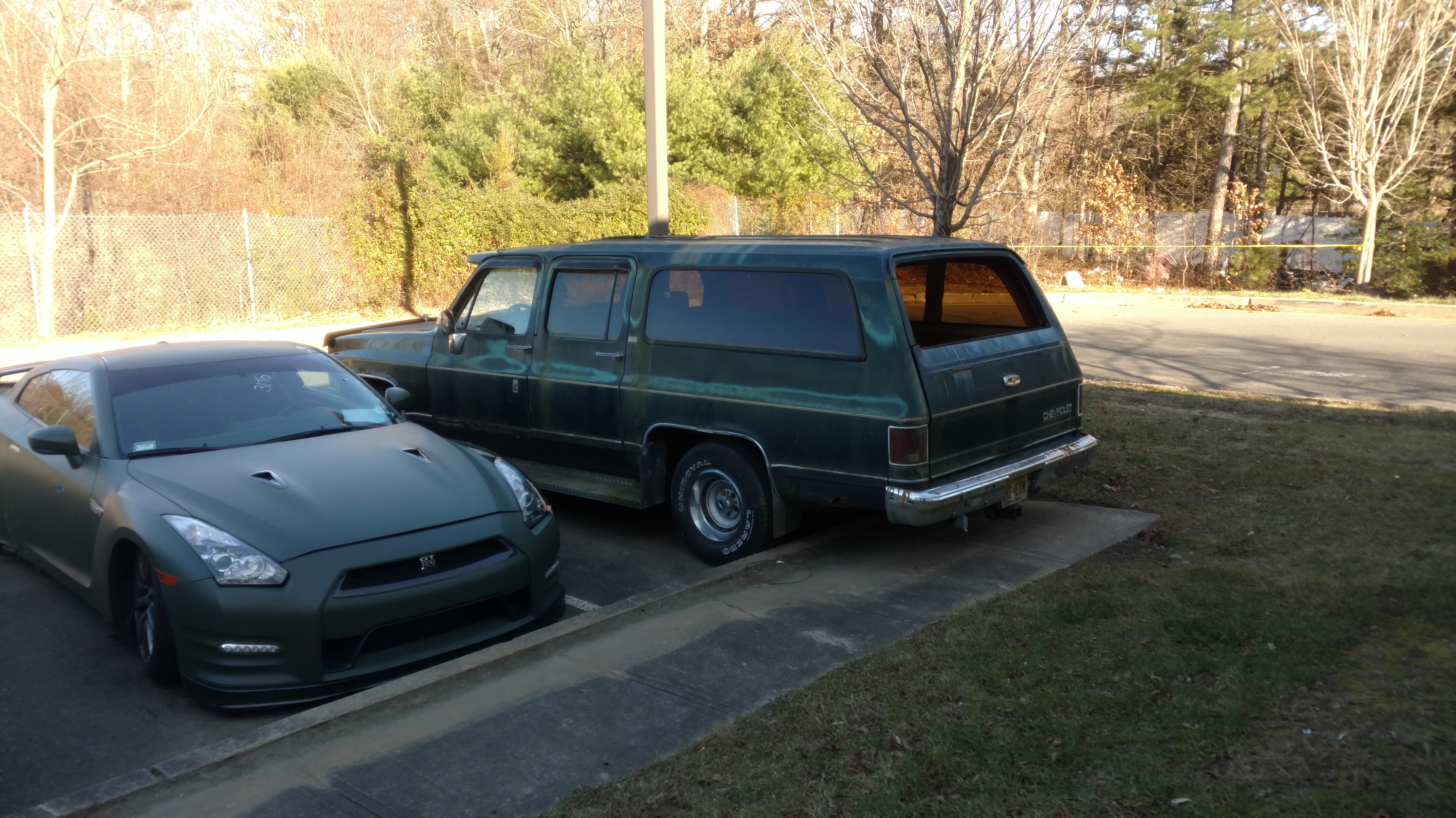

Ice cold and not plugged in she kicked off with only 2 shots of ether. My boss was driving it and I followed him back to the shop. It smoked a little but it was cold and hasn't run in years. Today going in to assess the truck who knows it may have its own thread tonight. What do you think?
View attachment 130034View attachment 130034

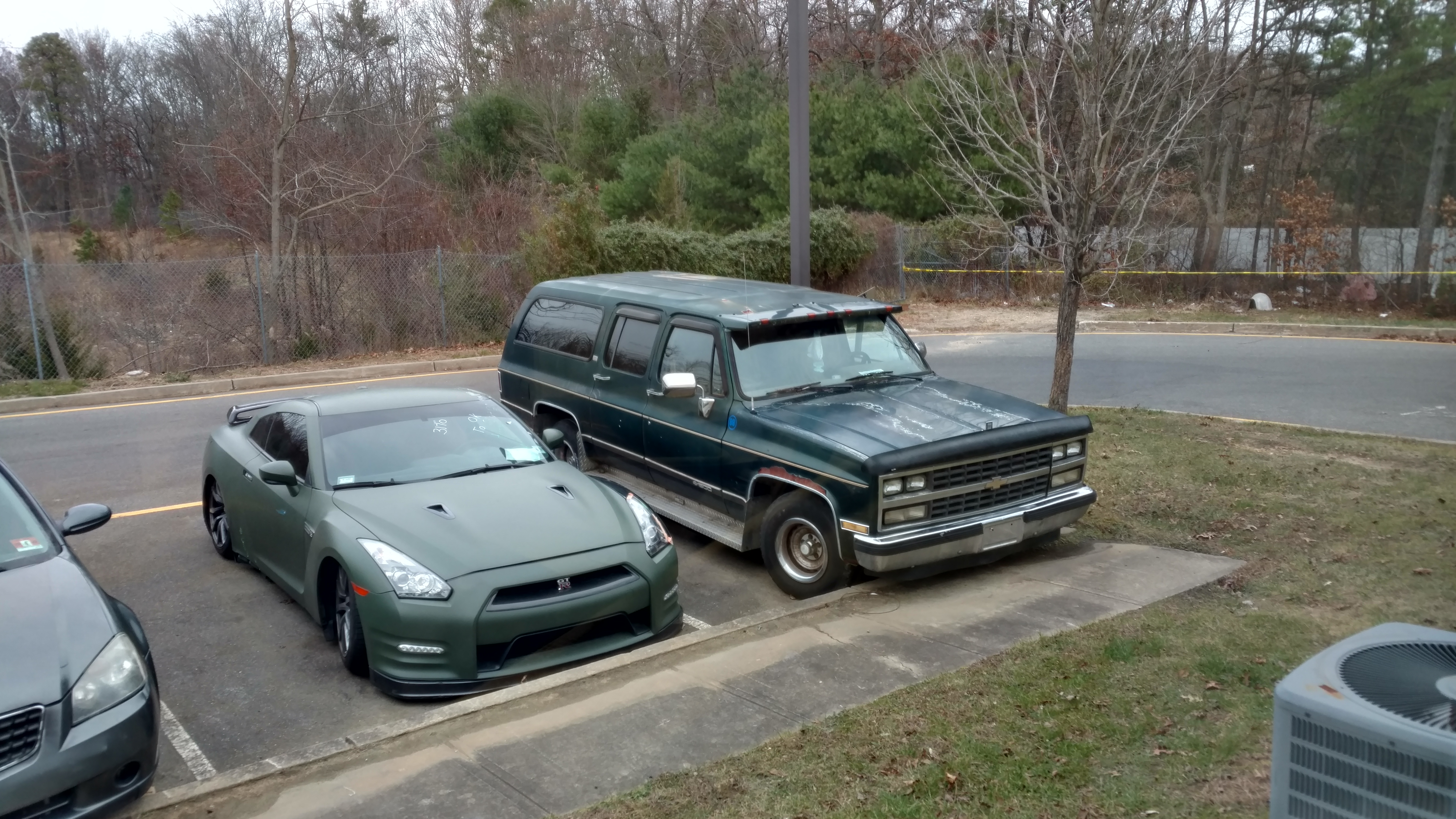

It's so awesome the GTR is trying to get a snuggle in. Man I love those old square body burbans.

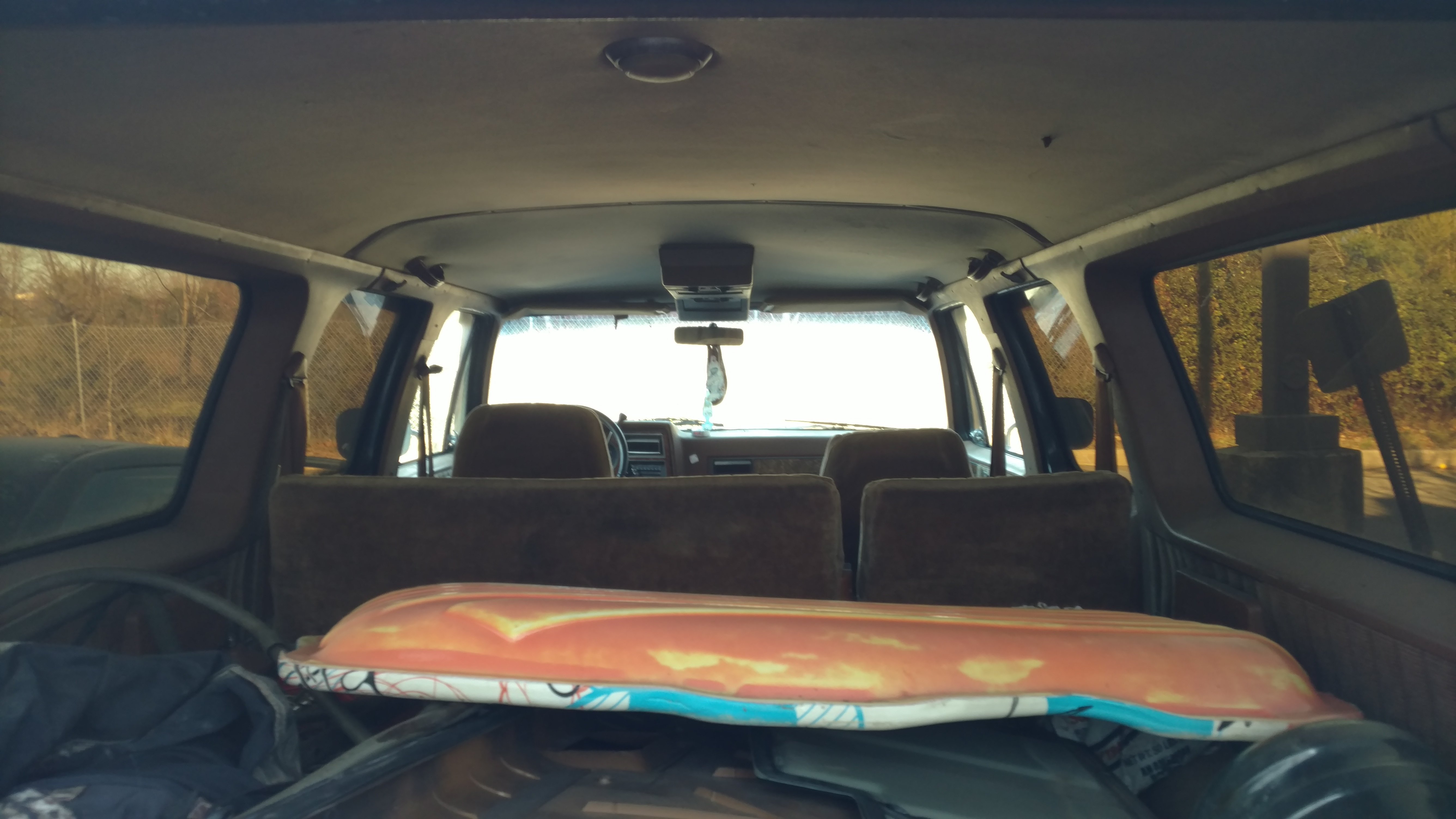

Well i think it's a keeper. I got it in the shop today and looked it over real good. Filled a garbage can with garbage and put all my bosses crap in the back of it.
Found and installed the air cleaner.
Put air in all 4 tires the right rear was flat and off the bead. Then I turned my attention to the open back window. I got the gate apart so I could get it open and found that it needs the rollers for the regulator and the steel track that's supposed to be attached to the glass was off laying in the bottom of the gate. The drivers side run chanel is mutilated and rotted in half. I'm going to see if I can finde a used gate for parts but for now I'm going to just get it to stay closed so I glued the steel strip back on the glass with window urethane and left it in the shop to dry with some rachet straps on it
It's going to need 4 tires and some TLC but I think it will be worth doing. I also think it needs a non G build thread but I'm not shore what to call it? Message me with some ideas
