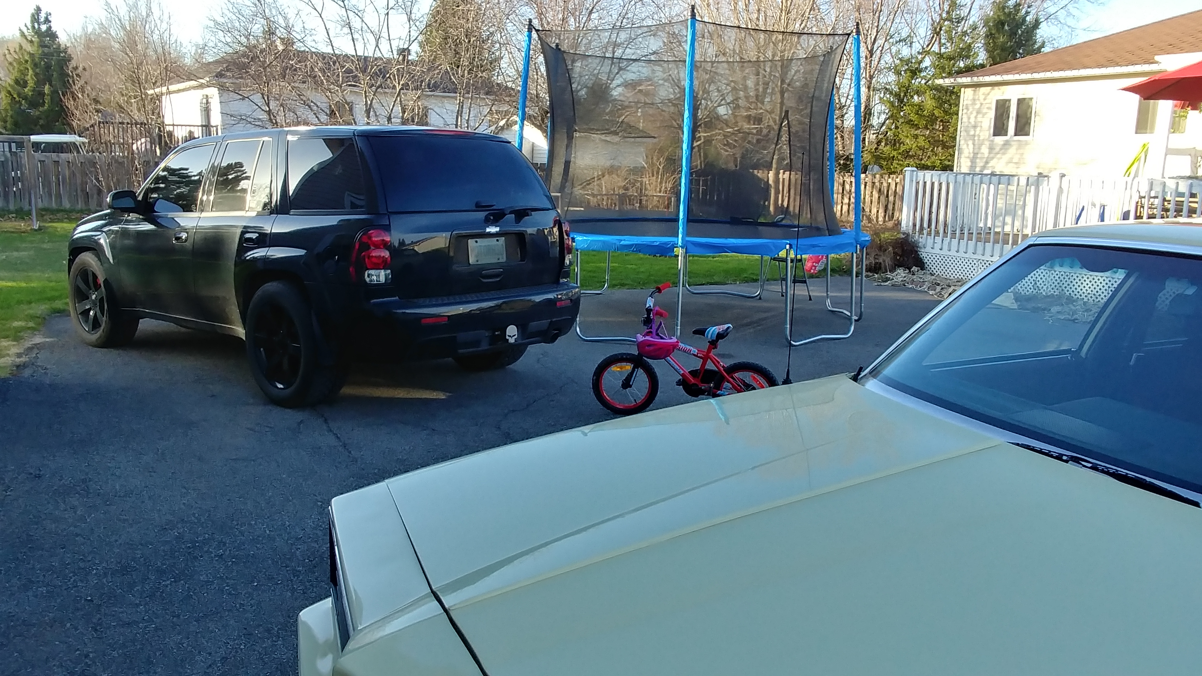

Built a trampoline. Instructions said it was a three person job - all I had was one man. I have dubbed it: Thunderdome.

Decent, I built one like that a few years back by myself. I recall the instructions saying something similar as well. Lacing the net was an absolute thrill!
Yep we have one too. I take ours apart every fall and put it back together in the spring. Lacing the net is the worst part.
