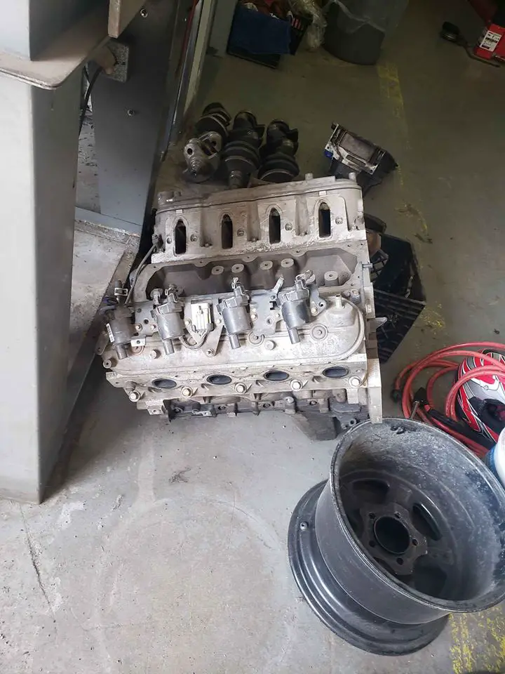

I did just come across this which is a bit of a hike:
I have a very nice late modle aluminum 5.3 with 799 heads it has piston and rods and all bearings including mains wich are still like new! Needed the crankshaft so it does not have crank! Its super low mile motor as u can tell by pics its all still clean! I also have several aluminum 5.7l ls blocks and 1 of them is ls6 block in good condition we went all 6.0l so no need for them. Also have other ls parts such as forged flat top pistons and some rods and other odd end parts.

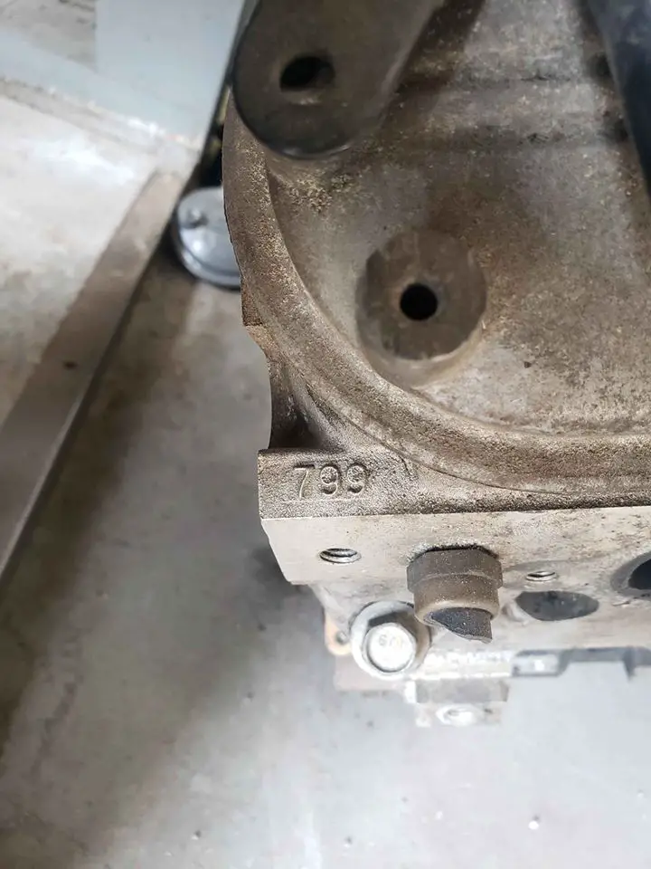

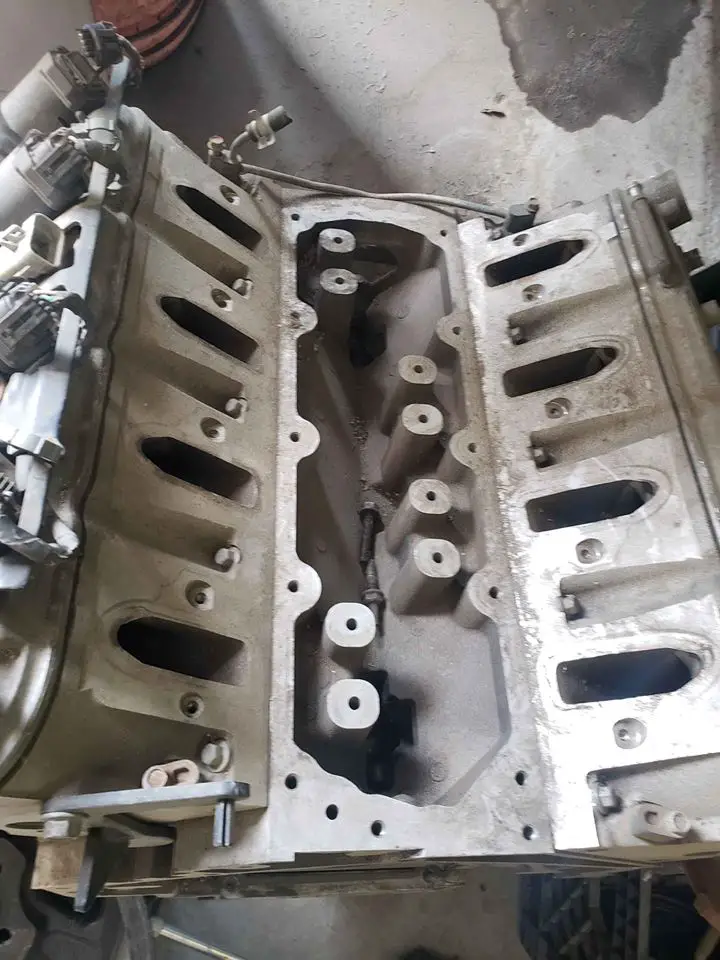

View attachment 154481View attachment 154482View attachment 154483View attachment 154484
That thing looks like a nightmare to get right. Robbed of key parts and no longer sealed; and full of debris. Run away!
