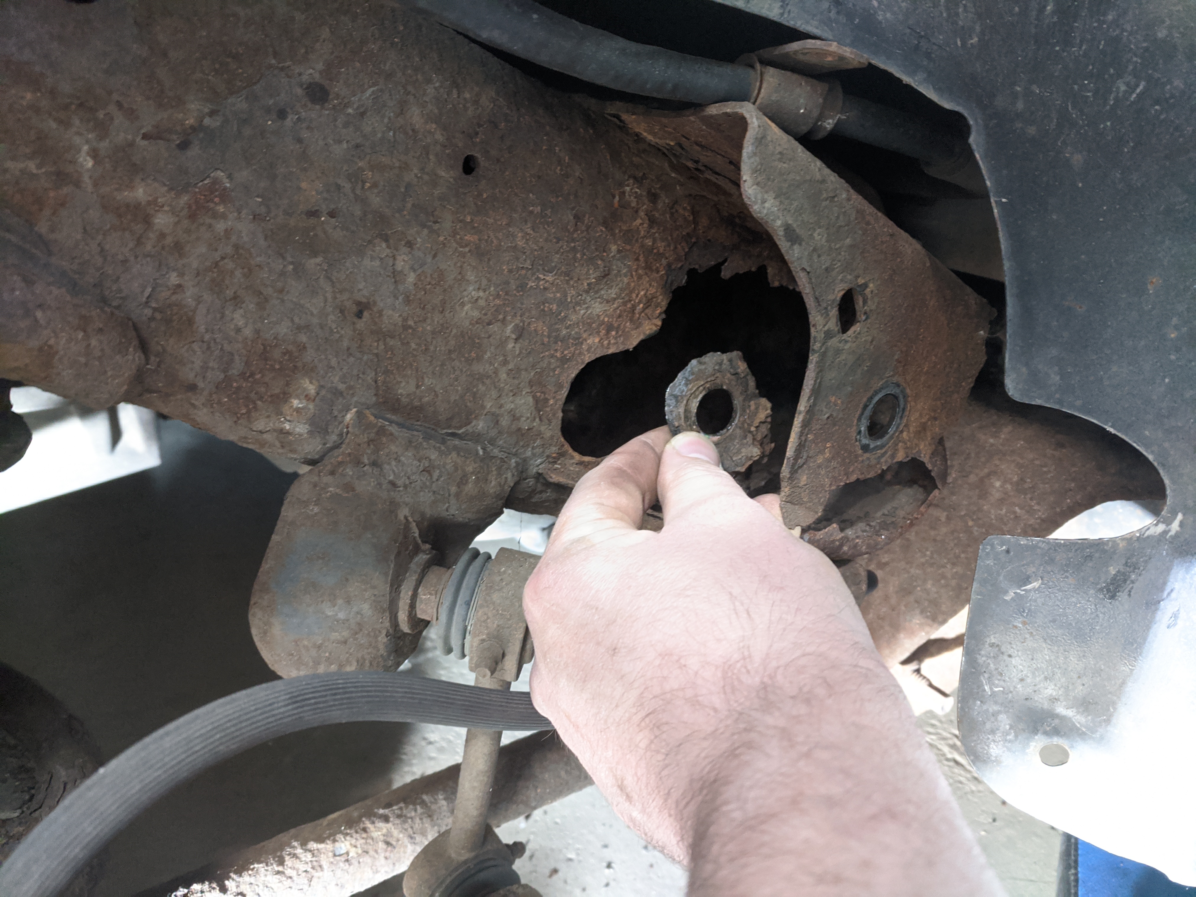

Likey going to be doing some trailer hauling with the Rainier this winter and it sounds nice to have more than 75% of the control arms attached to the frame so I decided to get the passenger side hole in the frame filled and build the uca mount back in.
I did the drivers side in may and procrastinated on the passenger side.
What was left of the inside of the frame
Hacked the outside piece off too since it had a big crack through the center

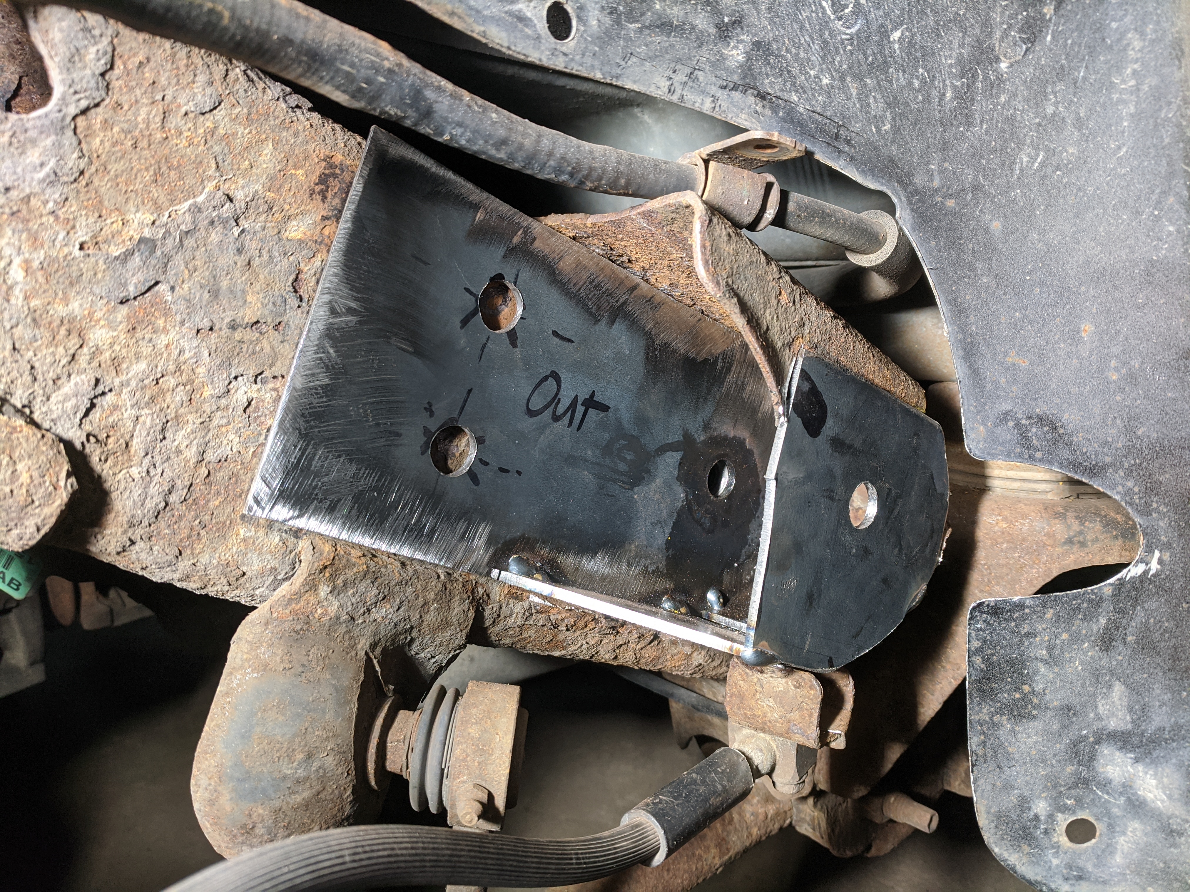

Sawed a patch panel and tacked
Zzzt zzzt
I at least feel safe hauling a car again.
Some nice looking welds especially considering the rusty metal you were welding to.
Thanks!
I have to give some credit to the welder. It's a Lincoln MP210 and has a good amount of control and has a nice display with a suggested auto settings so it's easy to get right the first time. I'm too cheap to have bought it (it's technically on multi year loan from Dad but he has 4 other welders and he doesn't need a 5th) but after using it I would buy one over a hobart with less adjustability for sure.
Flap wheel and a hot welder helps a lot!
Zzzt zzzt

Yeah, I noticed that that spot was soft last November when I noticed one of my control arms had broken. I didn't have 220V in the garage at the time or a heater so I waited until spring to fix the drivers side (which had the broken arm). I booger welded the arm as a quick fix. I poked at it wit the screwdriver and it literally just crumbled to nothing.
From what I could tell sand had fallen in the the bottom U shape of the mount, got wet, and never dried. It basically rotted at a horizontal line on the outside in line with the top of the U shape and the inside rotted out from stuff being packed in between the control arm and the frame. I never noticed it until it got this bad.

This is the drivers side last may before I fixed it. The passenger side was worse.
