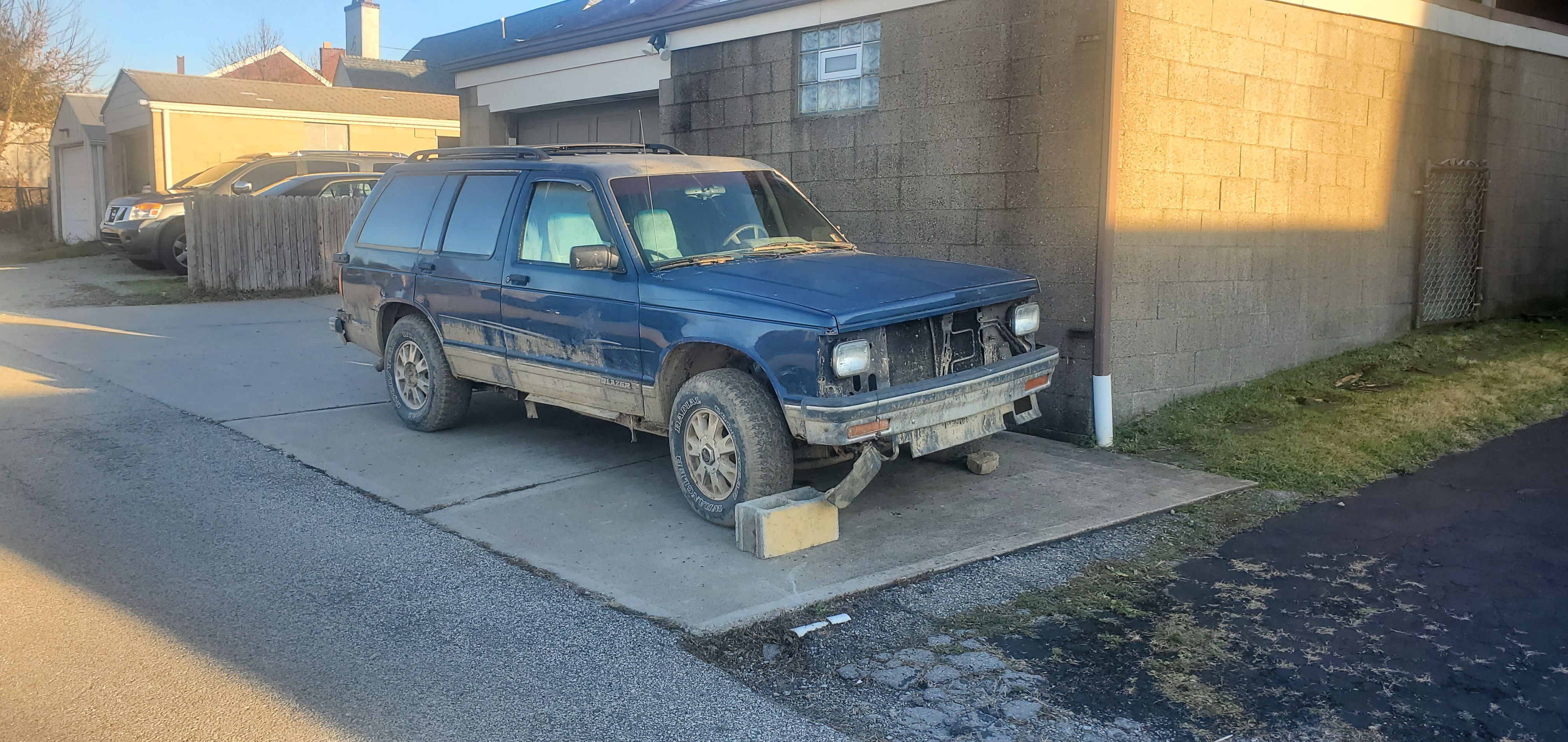

Finally got the parts truck delivered, maybe that means one of these days I'll start working on the blazer
I've been looking half arse-idly for a box early 2dr blazer/jimmy. They don't exist anymore. They are all wasted. Even the curvy 2nd gen versions, all destroyed.
There's a few, only reason I know is after I got mine a buddy has been looking. There were 2 nice ones in PA, my buddy sent an offer on the one that must have been too low so the guy wouldn't reply back. But if you go into the groups on Facebook there is a good bit of decent ones listed just they don't have them anywhere else
