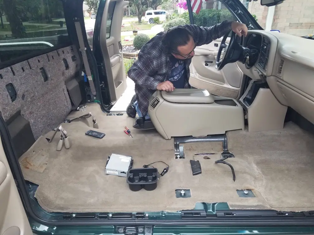

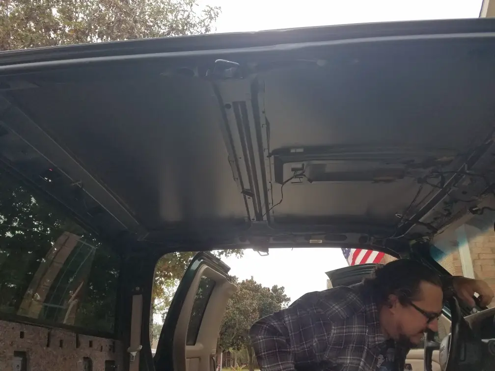

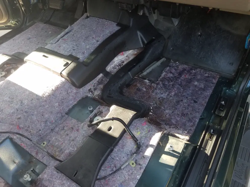

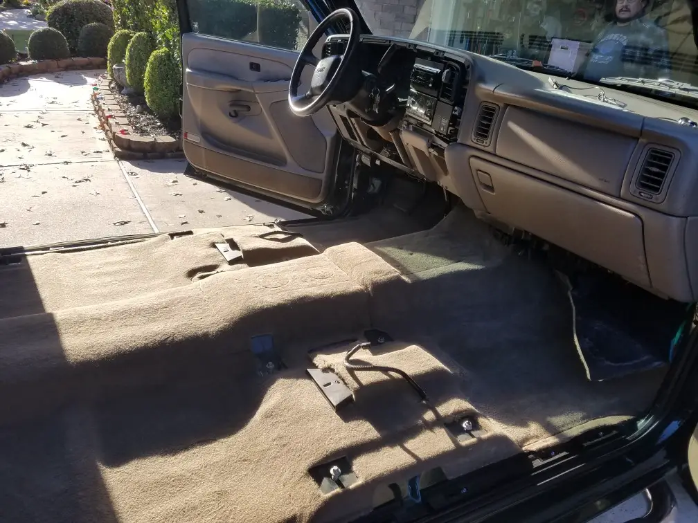

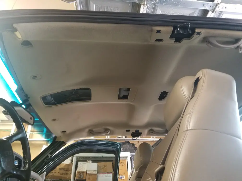

It rained here for a little more than three days straight, Thursday, Friday, Saturday, on into Sunday morning. Saturday evening my brother discovered water on the driver's side door panel of his 02 Sierra Extended Cab. Both sunvisors were wet. The front portion of the headliner was wet. The front floorboards on both sides were wet.

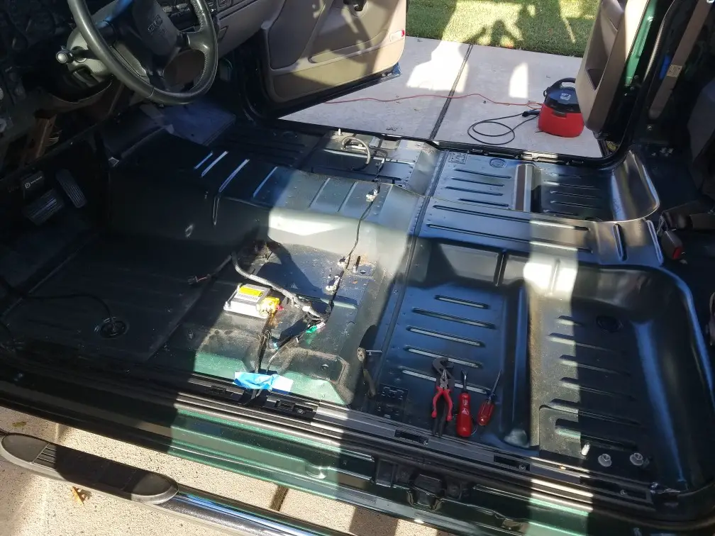

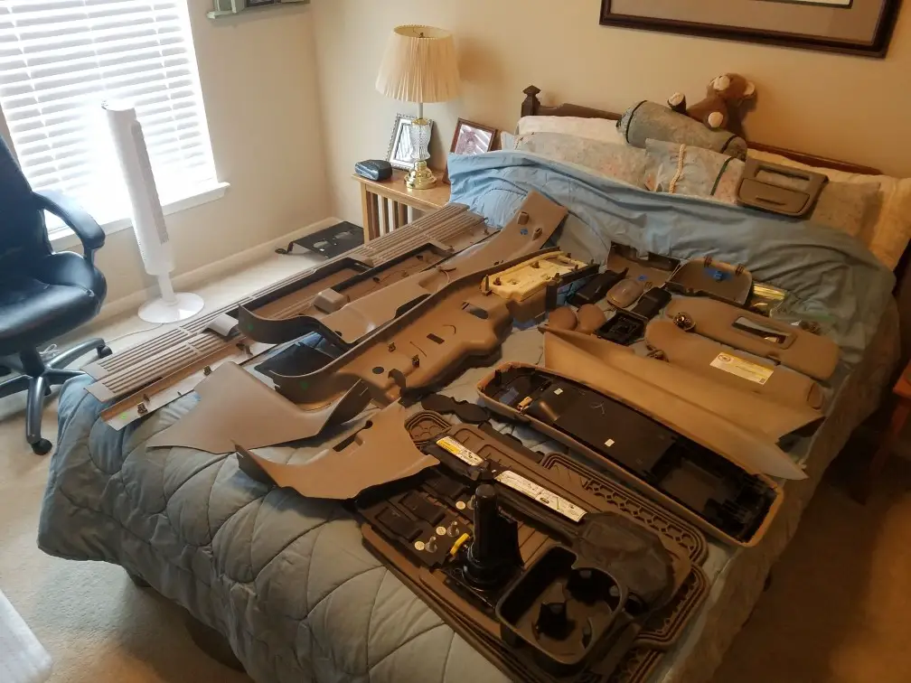

Sunday morning we pulled it in the garage, to get out of the rain and started investigating. We ended up working on it all day Sunday. We pulled the headliner, seats, console, carpet, jute padding etc. It came apart pretty nice. I only broke one tab on one trim panel and we glued it back together.

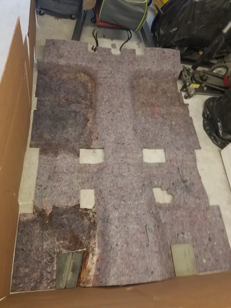

The passenger front and rear floorboards were soaked. The driver's side wasn't that wet, though I did find moisture behind the A-Pillar trim and the kick panel over there. I found the same on the passenger side. All I can figure is the windshield is leaking and has suddenly gotten worse. The truck was in the driveway pulled in front first, so the front of the truck was higher than the rear. That side of the driveway slopes to the passenger side.

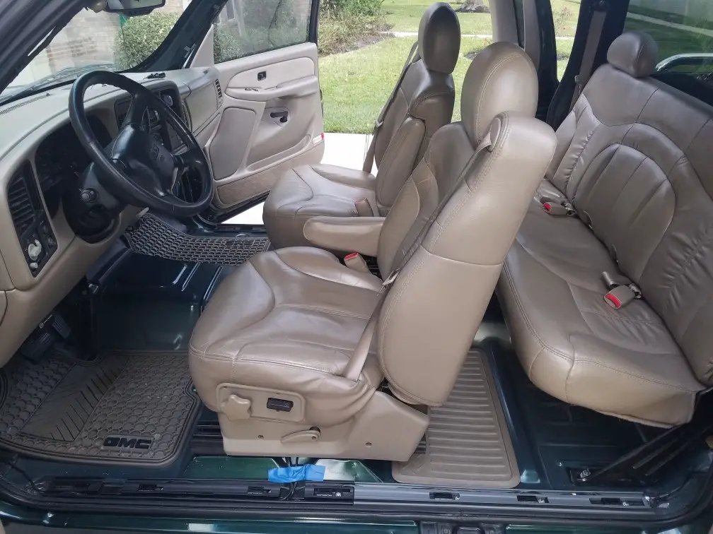

We put the seats back in it so it is usable for the time being. We ordered new carpet and are trying to figure out who we'll get to do the headliner for us. We also ordered a box of the Eastwood X-Mat (their version of Dynamat).
We caught this in time. The floor pans are spotless. The truck didn't stink. I think we saved the jute padding. The next step is to take the hose to it and try to pinpoint the location of the leak. Here's some pics of our day....

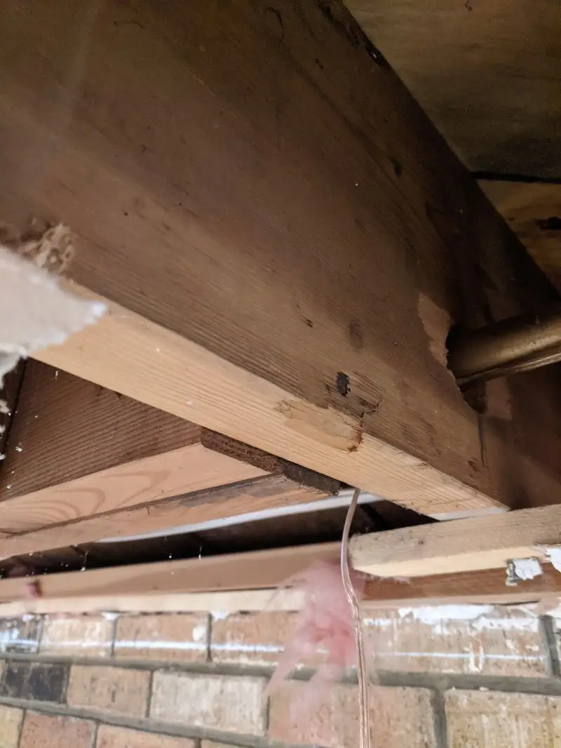

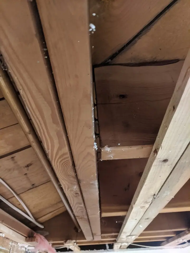

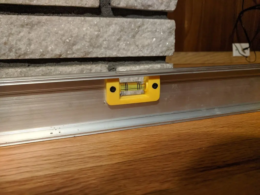

The house has a big quartz mantle for the fireplace upstairs and it's causing the floor to sag. Knew it when we bought the house and it's likely not structural but needs to be fixed. Simply not enough reinforcement in the floor for a thousand+ pound load.
Family member of my Wife is a contractor who is layed off for the winter so we are having him consult for our fix.
The issue
Unfinishing the basement. Only 2 joists going to the sill and 3 are tee'd into them so it's a lot of load over 60+ years.
Part of the issue
Sagging joists
So main plan is to jack the sagging joists back into flush and install some steel hangers and add more hardware. From there, determine how to sister the main 2x8's with something. (LVL, just another 2x8?) I guess thats where hiring the family contractor friend comes in.
I think a good amount of the issue can be solved by just fixing the nailed joints that have separated over the years.

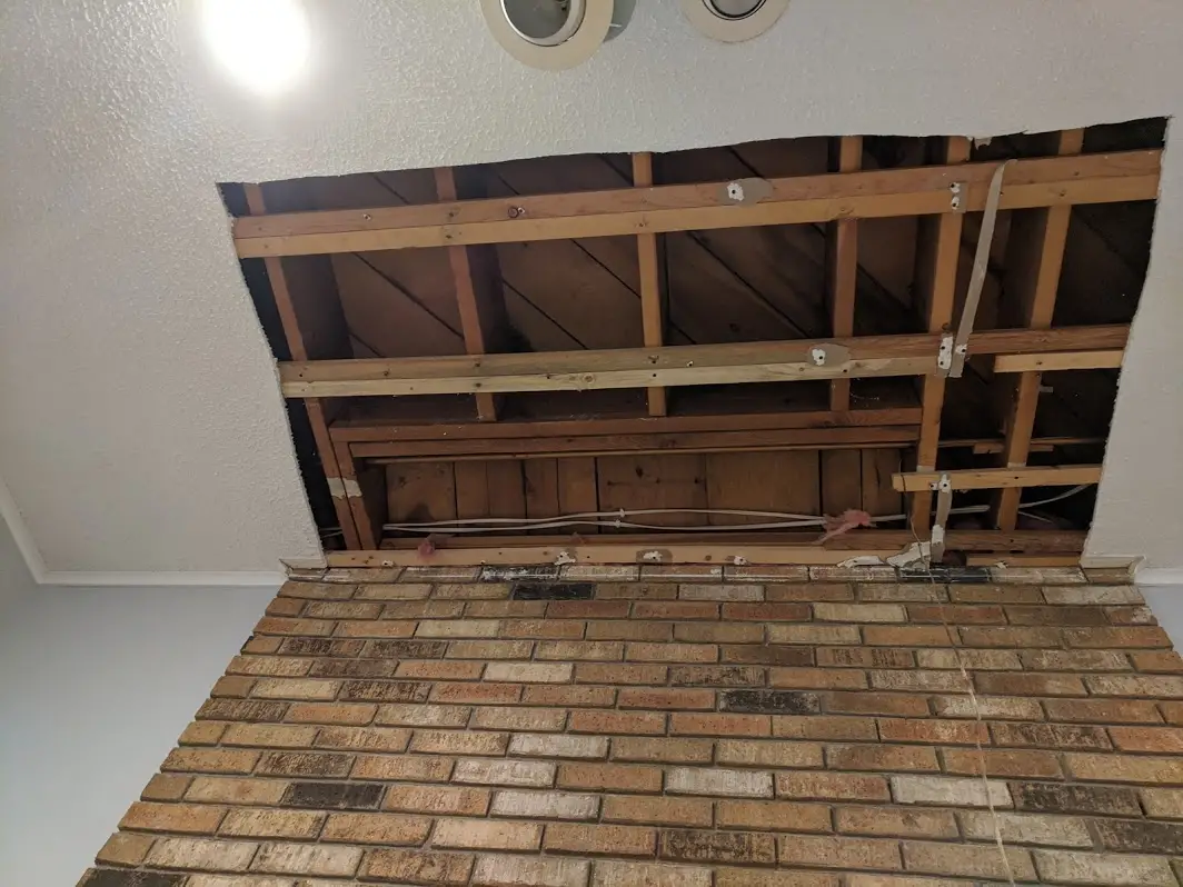

And so it begins.
The issue
Part of the issue
Sagging joists
I think a good amount of the isasue can be solved by just fixing the nailed joints that have separated over the years.
What are the plans for the basement room? Depending on the room dimensions, a full/partial wall shelving unit with TV screen mounted on that nice brick work? Some support under the corners will help, but it would be a shame to cover that brickwork.
Reactions: MalibuDavyou5
The plans for the basement room is to leave it as is. The kicker is that that brickwork is the basement fireplace and putting posts in front of it voids the point. The basement fireplace shares the same chimney as the upstairs one, they are stacked over/under each other. Unfortunately both are out of operation and need the flues replaced. Thats down the road ($$$). Plan to put a gas insert in the bottom since hauling firewood downstairs is a pain.
Almost have to brace it and hide it under the ceiling otherwise it looks dumb. Maybe string an LVL the other way and put a post on each end but again, ish.
