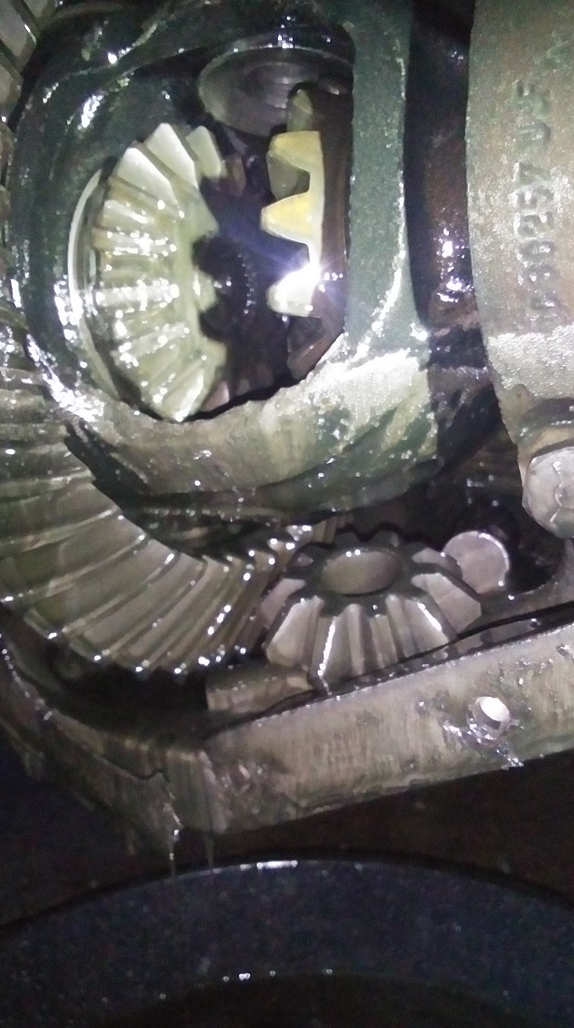

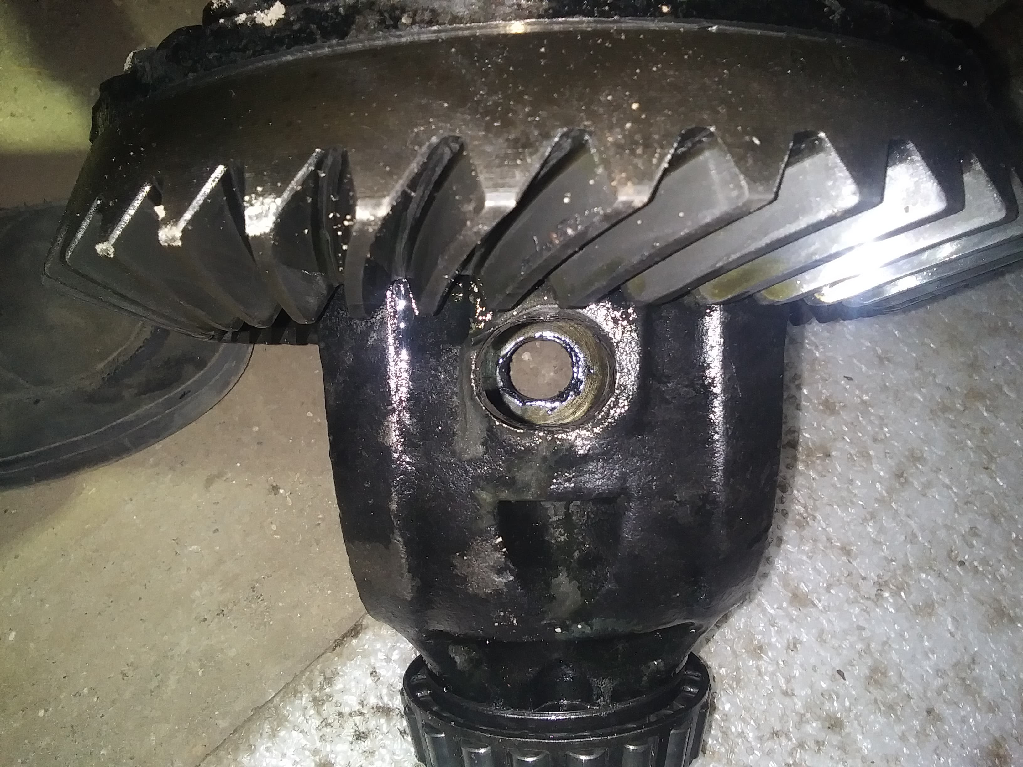

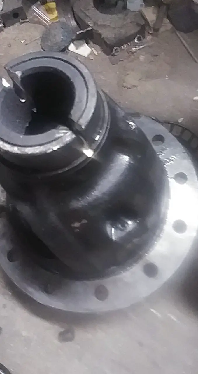

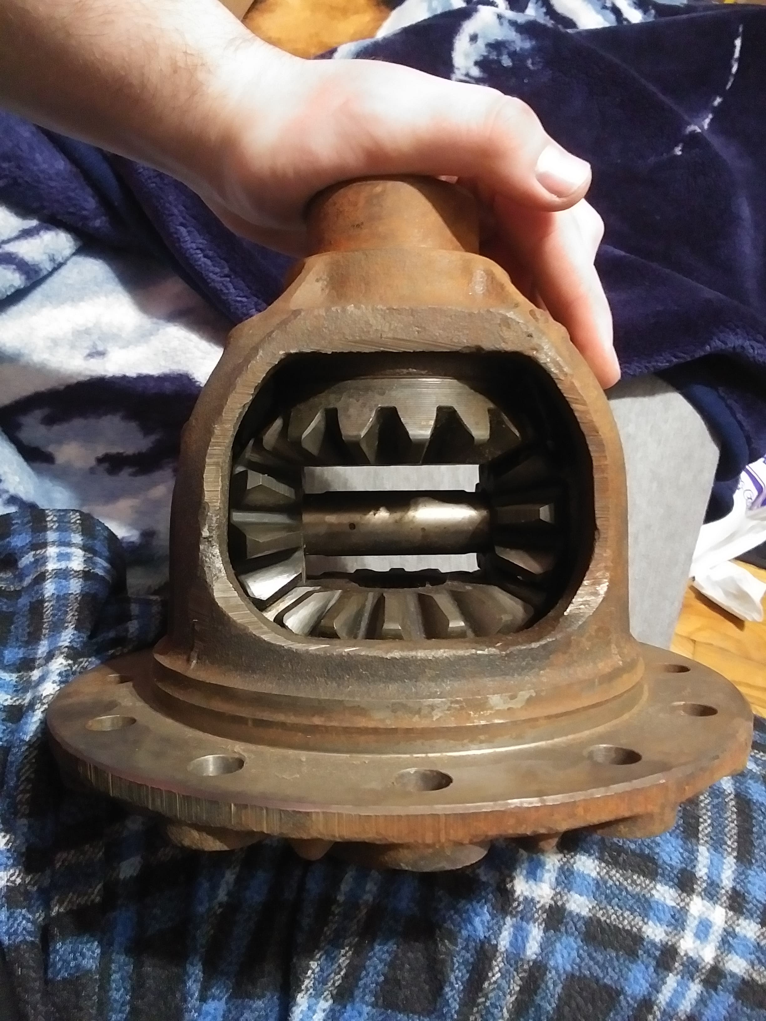

Summit ****ed up and only sent me one carrier bearing, so I had to order one from oreillys. of course they lost the part so I had to go to another oreillys to get the 2nd bearing. got that one and the ring gear off. I didn't have a tool to remove the old carrier bearings, so being that the old carrier was trash anyway, out came the angle grinder to get the old shims off.

got it buttoned up at 3am after officer newman left me a nice note. think it's either the dumbasses working on the sh*t shack next door to this big *ss split foyer they built across the street, or the jackasses within that reported my truck being parked outside my house for two weeks. at risk of it being towed, i had to jam to get it together. New axle flange seals, diff cover gasket, knocked the plug loose with a 9/16 head bolt and a pipe wrench, and carrier all installed in a very cold few hours.
I drove the truck around and besides a shingle nail in my pass rear tire (thanks construction douches), it seems to be ok. 3 quarts of fluid is all it took, I read dana 60/61 take 4 or 5. Might need to top it off later. No weird noises, clunks, or fires. Yet.
In the future, if you just cut into the race then smack the cut spot with a wide chisel it'll shatter in two.
