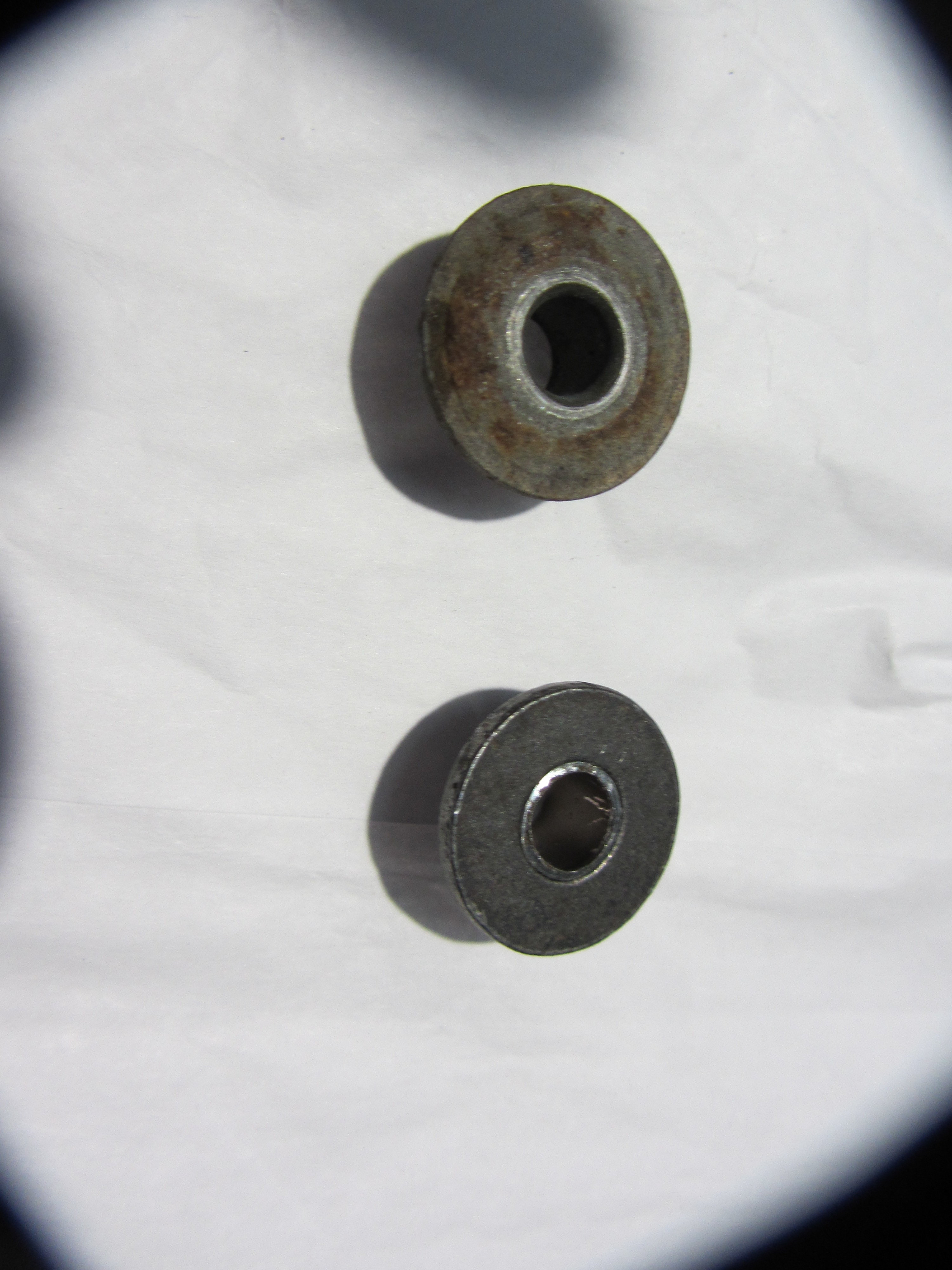

I tested again today and no oil. I removed both of the push rods and they are clean with perfect holes. So are both of the rockers. This is getting old. So what I did was to swap the entire rocker/pushrods/pivots/bolts assembly from that cylinder to the one next to it and vise-versa. Now they all flow oil just fine. Why? I don't know but I feel a lot better. Today I went to put the valve cover back on. The engine kit came with new grommets for the spacers. It turn out one spacer is missing. And of course they are obsolete and unobtainable. So I made one. The spacer is nothing more than a short piece of 3/8" tubing pressed into a washer. I took some 3/8" fuel line, cut off a piece, and pressed it into a washer with my bench vice. EZPZ. The grommet fits it perfectly. Then it got dark and really cold so tomorrow is another day. View attachment 132956View attachment 132957
