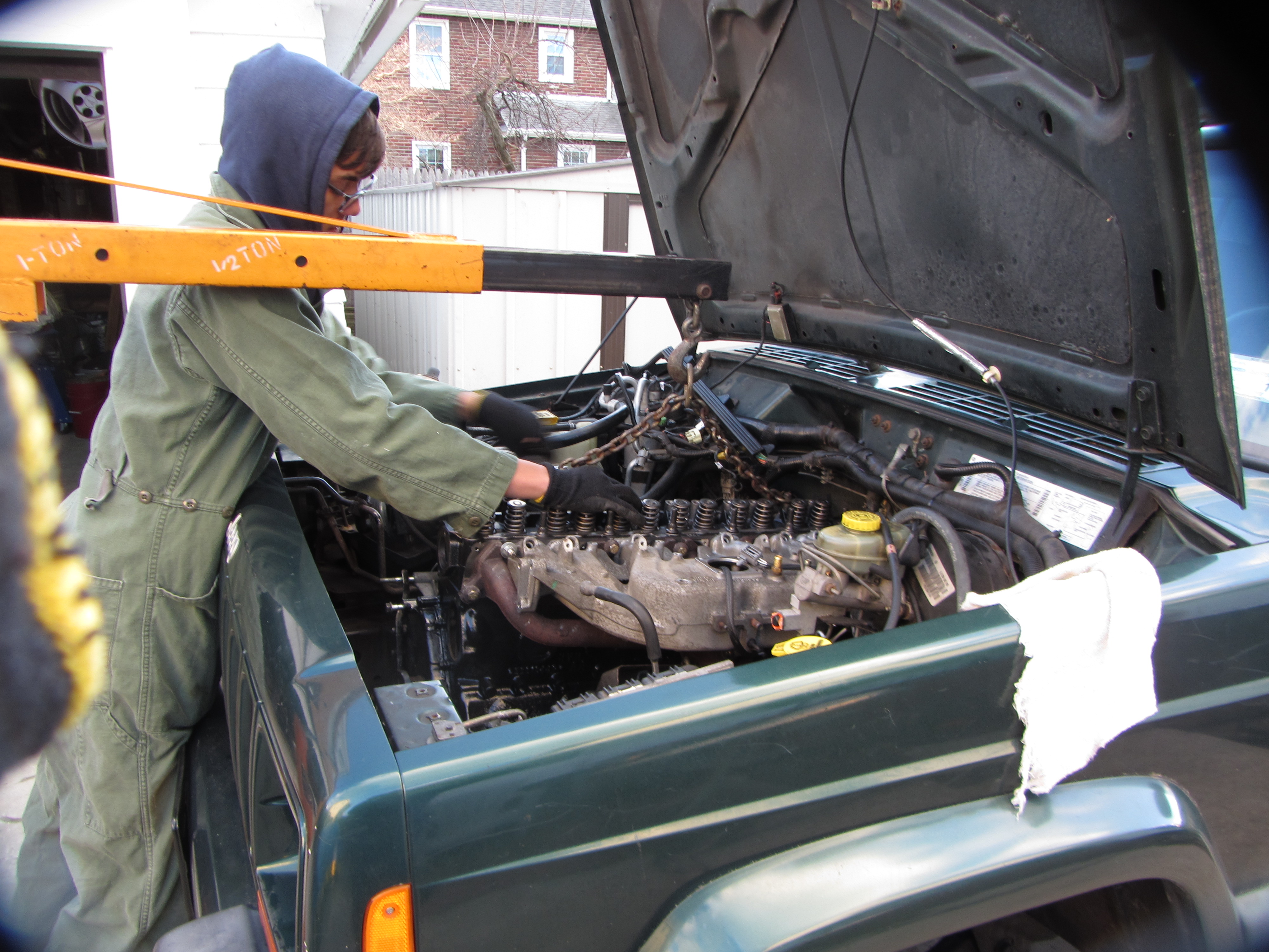

Well after banging my head against the wall I decided to go with the FSM which does not say to oil the bolts. I made sure the threads were chased and clean. I put Permatex 52914 on the #11 bolt. We assembled the intake/exhaust to the head first and left the head pipe loose so it can be swung if needed.I put the two manifold O2 sensors on as they are so buried under there. The two lowers I removed because they were going to get smooshed going in. I think I can get them on later- not as bad as the uppers. I had my Grandson help me get the head on and torqued down. He had no idea what getting 110 ft lbs tight was like! Good learning experience. That #14 bolt at the back is one tough mother. My big torque wrench is 1/2" drive so you need a deep 12 point 1/2" drive 1/2" socket. I sure didn't have one on hand. I think I made 100 trips to the stores on this job. I also wanted to use stainless steel for the manifold/head pipe bolts. Turns out they are M10 x 1.50 and not available anywhere locally. I re-used the old bolts for now. View attachment 132810View attachment 132811
