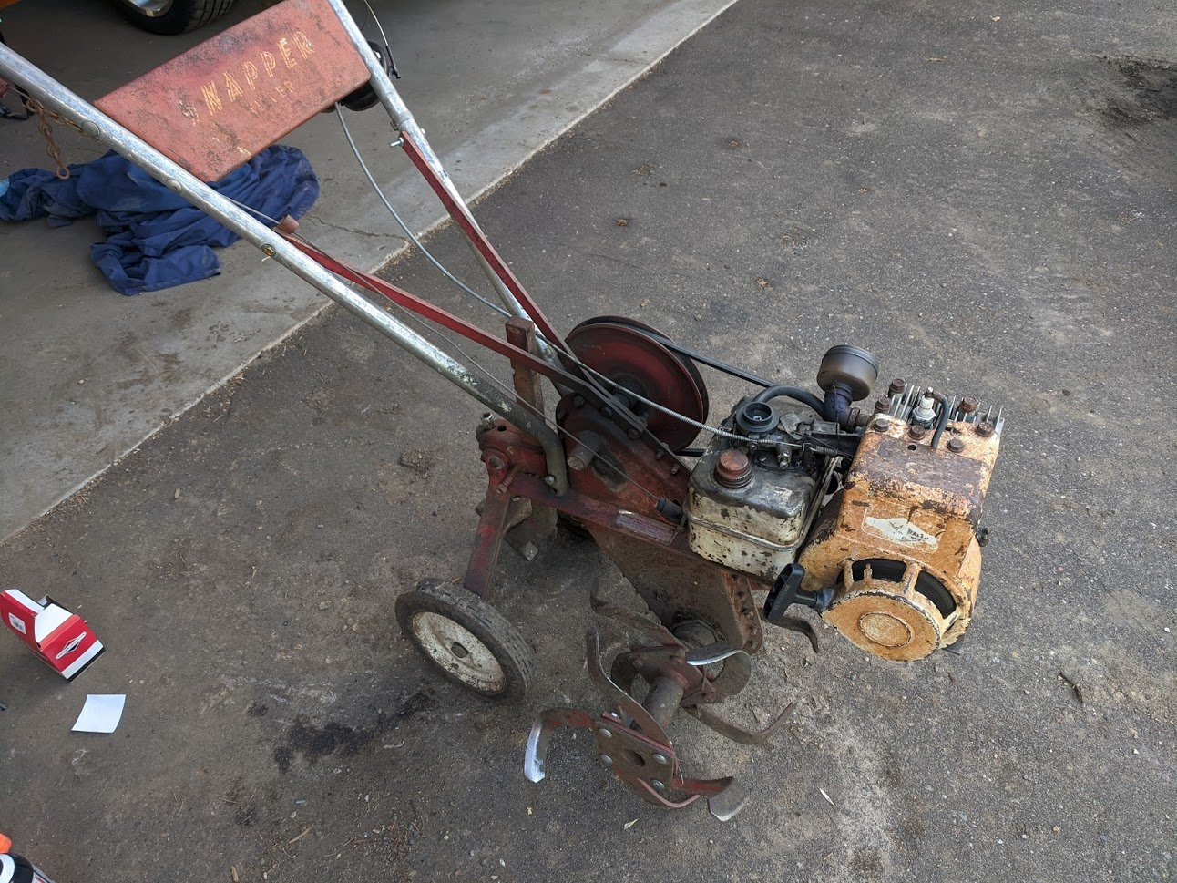

Became a small engine mechanic.

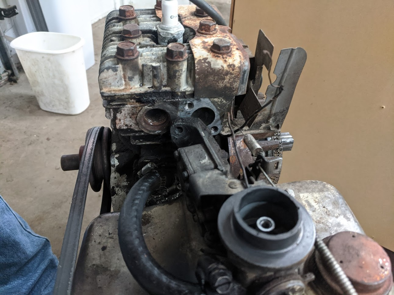

Decided to put a muffler on the wife's family heirloom tiller. The old muffler had fallen off a decade ago probably and although it ran, it was WAY loud. Heat & Beat on the old 1/2" NPT nipple that was in the head out after clamping on it with the vice grips.
Found a muffler from the local small engine shop and of course it hit so I had to build a "header" from some black pipe.
Of course the pull cord clutch had been flaking out so as soon as I reinstalled it after putting the muffler on, it locked up after starting and wound the cord backwards. Then I couldn't get it started, and it was backfiring. I looked online and it means it probably sheared the flywheel key so I ran back to the small engine shop, grabbed a new clutch and key, put it on, and got it started finally.

Wow- a sideshaft Briggs and Stratton. NICE! When I was a kid we would bolt those to a bicycle, rig a pulley on the rear wheel, and run a fanbelt. Home built motorbike! Lemme see if I can find a picture. This is my chopper phase around 1967. I always got away when the cops chased me! FAST little bugger. Most guys used a washing machine pulley which was the same size as the rear wheel. Me I used a VW bug crankshaft pulley so I could top-end everyone.
I didn't imagine there would be interest in a 50 year old piece of worn out lawn equipment but I guess this IS the G body forum so I can't be surprised.
The guy at the small engine shop I got parts from asked what it was on and I said a 50 year old snapper tiller. He asked what the model number was and I was like, ummm, 5hp. He said give me a minute and dug up all the parts I needed, I was pretty impressed. I'm going back again if I need more parts.
He actually had most of the parts in stock but they were all in pretty old boxes. I paid $6 for a muffler, $1.90 for a carb gasket and $27 for the clutch rewinder so they were surprisingly cheap.
