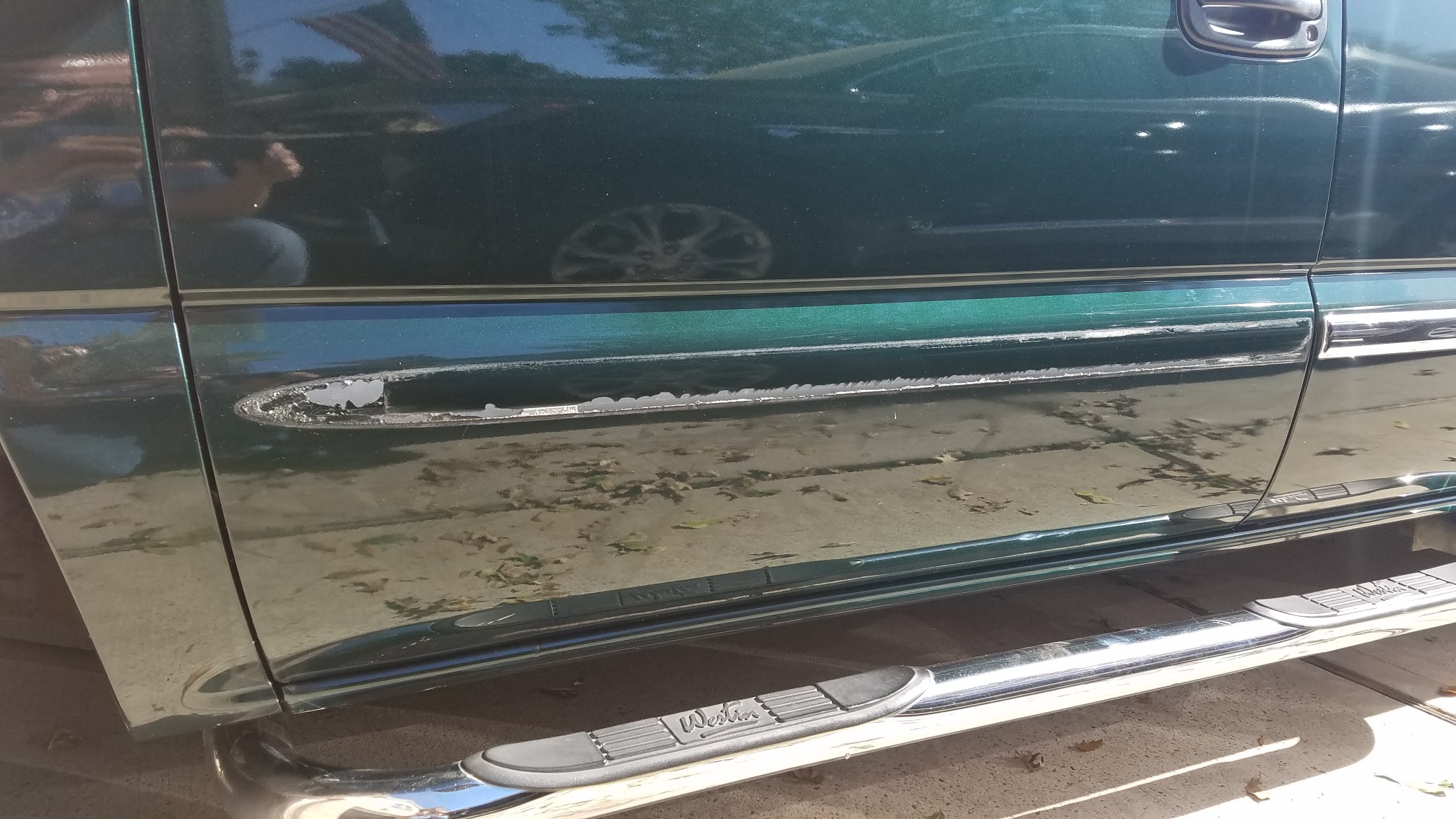

The chrome spears on the front doors on my brother's truck have been bubbled up for a long time....

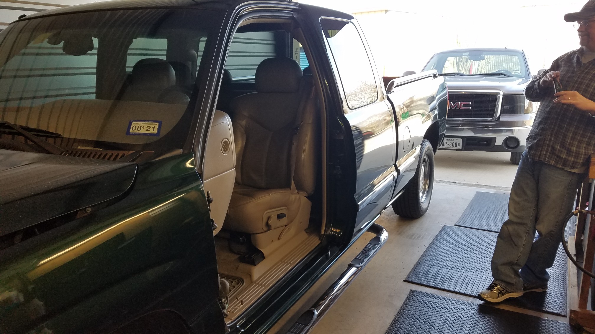

This truck is in very nice shape. He has no plans to replace it so we are always looking to improve it. I found a pair of NOS spears. Yesterday morning I thought replacing the spears would be an easy, rewarding project. I didn't want the spears sitting around for 18 months. Boy was I wrong. We pulled the spear on the Driver's side door. We used dental floss to cut the old tape. The results were calamitous. A bunch of paint lifted.....
I've never had this happen before. The paint had failed under the spear. It woul just flake off with your finger nail. We spent about an hour cleaning off the old tape with adhesive remover, thinking we'd just cover this up with the new spear. Neither of us were really happy with that idea.

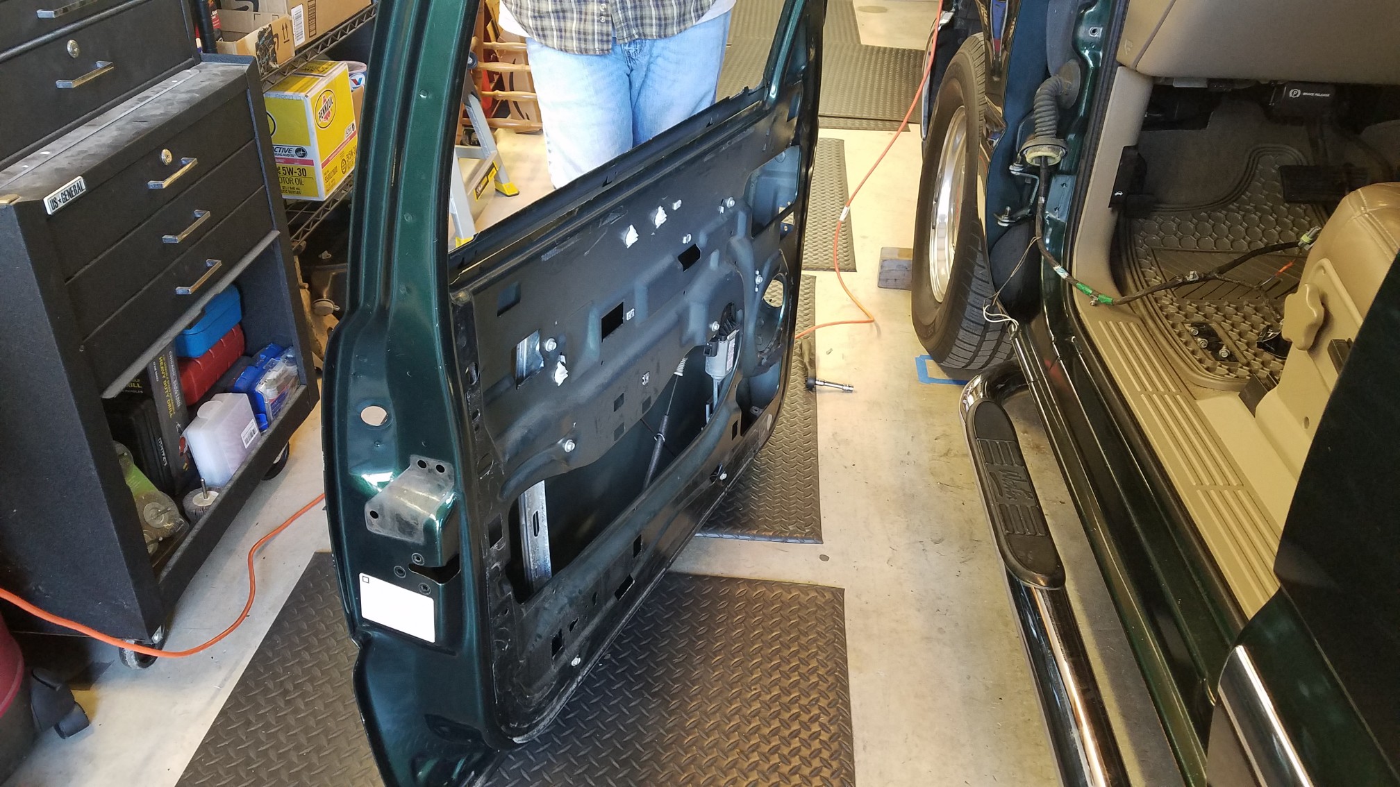

We ended up putting the truck in my storage, gutting the door, pulling it off the truck and taking it to the painter....
We put the truck on the battery tender and covered the cab with the car cover for the Roadmaster. The top of the door above the window had some clear issues so this will work out well. The painter is a collision painter at his day job so this is his specialty. He's going to blend the base in and reclear the door.
This is a little extreme but it's fixing it right. We're supposed to have the door back next weekend. That was not how I thought we'd spend our Saturday.

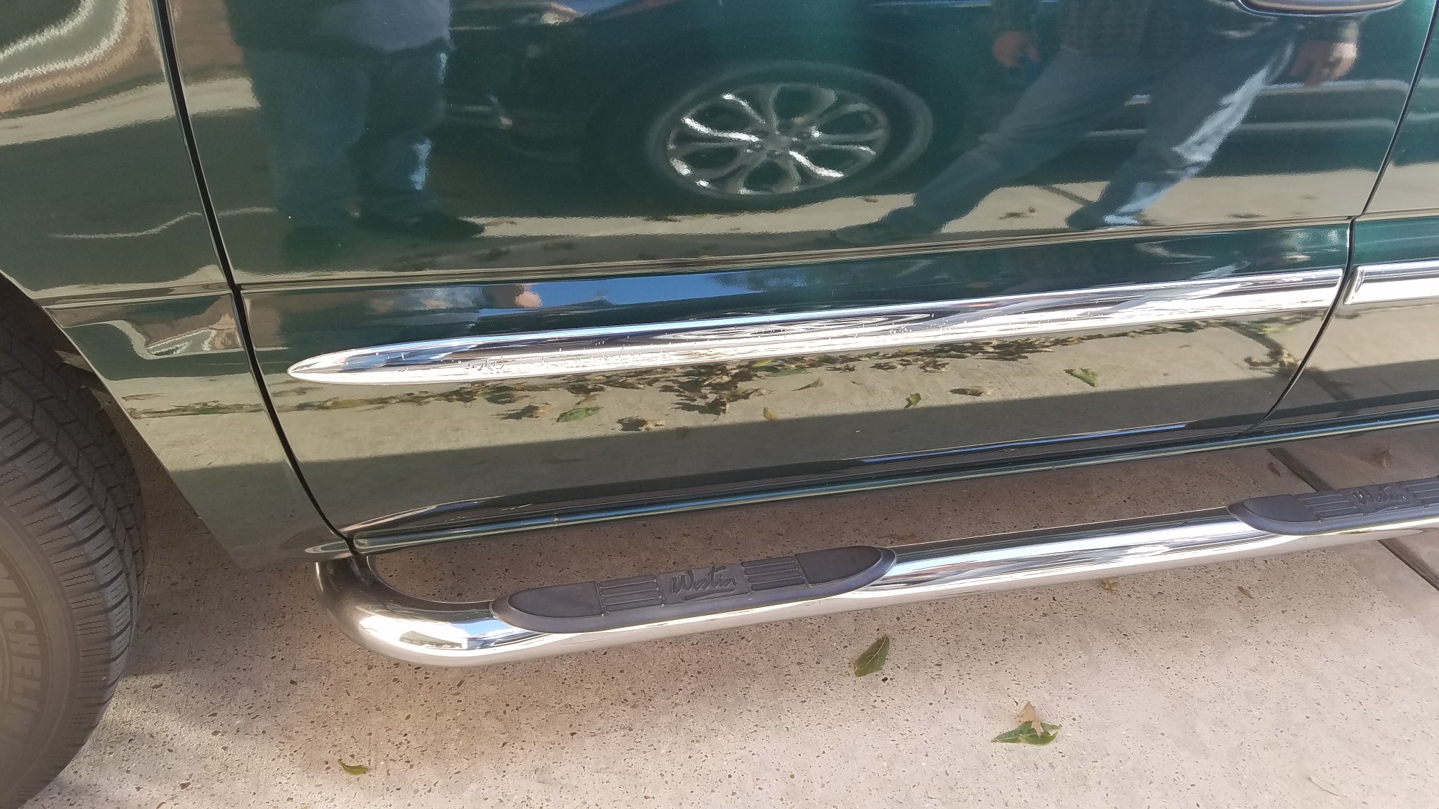

Sean and I finished up getting his truck back together yesterday. We got the door back from the painter last Sunday. We hung it on the truck, got the wiring harness fished back in and routed, got the window run channel and window back in it. The window was very slow going up and I found it to be quite unacceptable. We had replaced the motor several years ago and Sean said it was always slow. I didn't remember it that way but he knows the truck better, obviously. We broke off about 5:30 that day and I ordered parts.
Yesterday we started with putting in a new genuine GM outside window sweep/belt line molding. Then we replaced the entire window motor/regulator assembly. Sean put new 3M body molding tape on the Ventshade and got it installed. We had cleaned inside the window run channel as much as possible. After the Ventshade was installed, I wiped down the rest of the channel with some silicon spray on a microfiber. The window goes up and down quickly now. I would say it is like the truck was new.
We also did some heat gun work on the mirror where the triangle base mounts to the door. The top point was sticking out. We would heat the area up, Sean would apply a little pressure to the area, and then I'd cool it with compressed air. It worked great.
The painter just DA'd the area under the spear and then blended in some base. He cleared the entire outside of the door. It still has some small rock chips (under clear now), small door dings, etc. but now the failing clear above the window is fixed and with him just blending the base in the trouble area where the spear was, the door still matches the fender and the rear door. Except for the clear being new, you can't tell there's been paint work on the door. The painter is a collision guy at his day job so a repair like this is his bread and butter. He did a great job.
We're going to let the paint cure for about a month before we put the new spear on.
All better.......
All better.......
