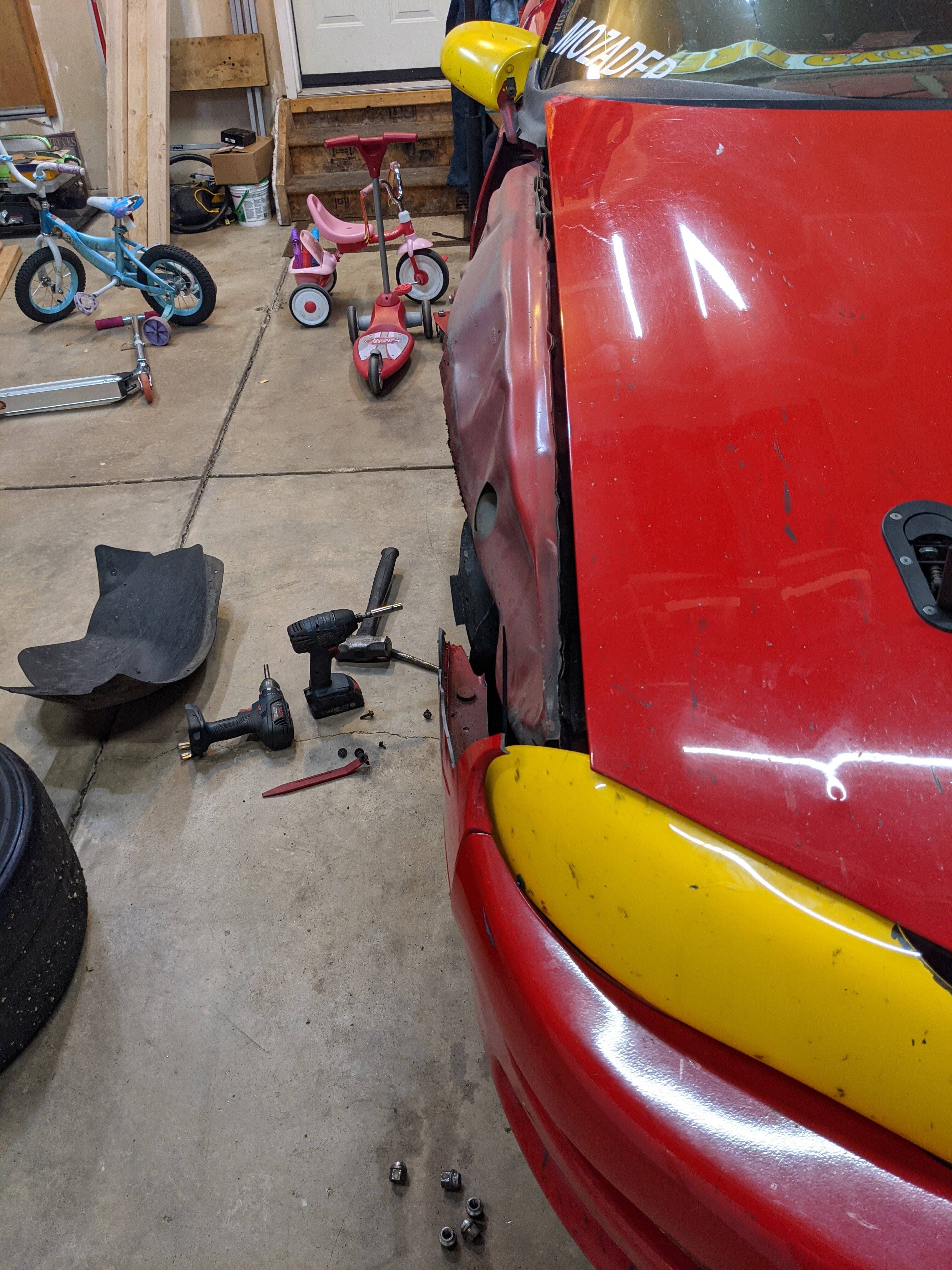

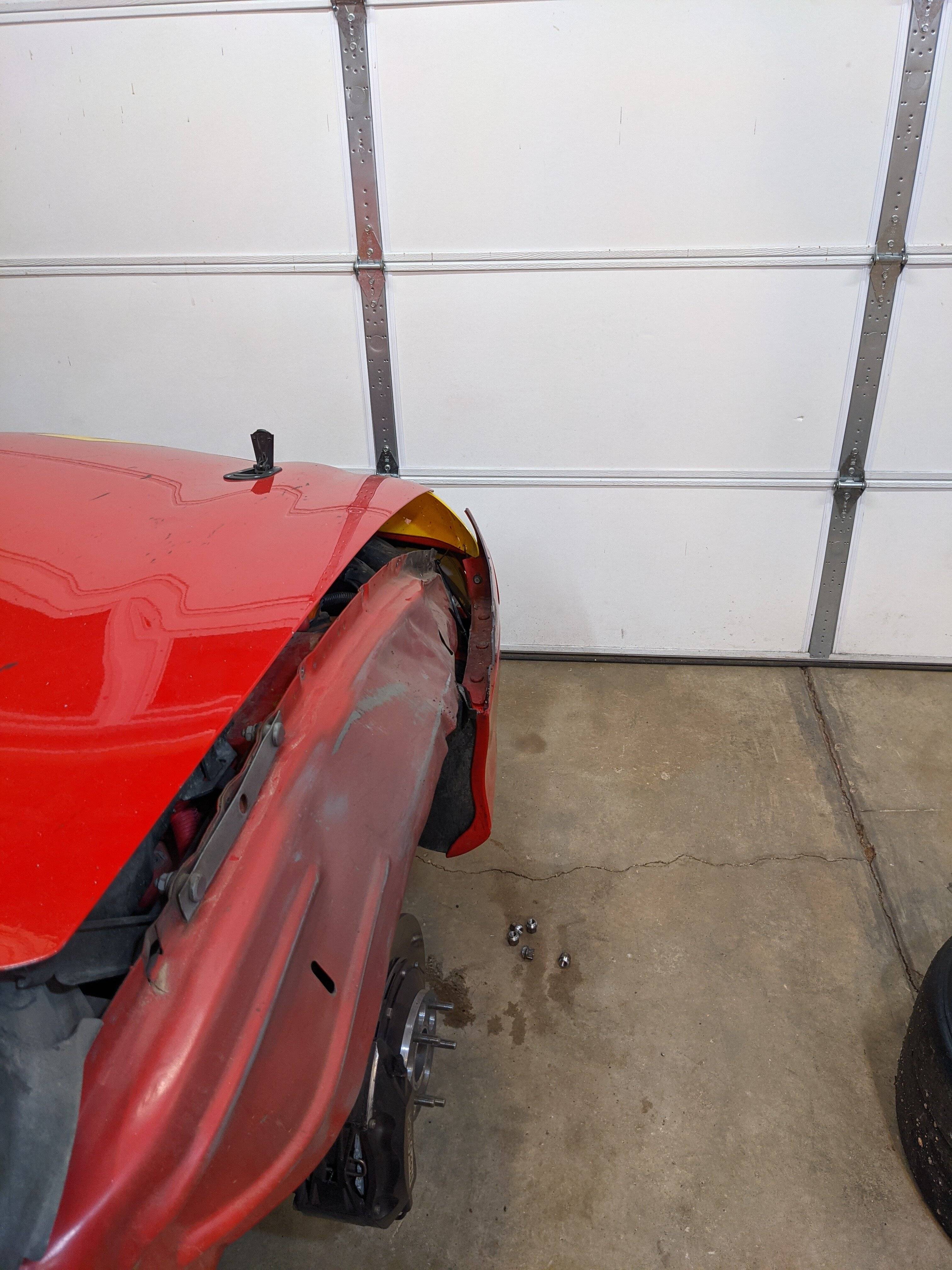

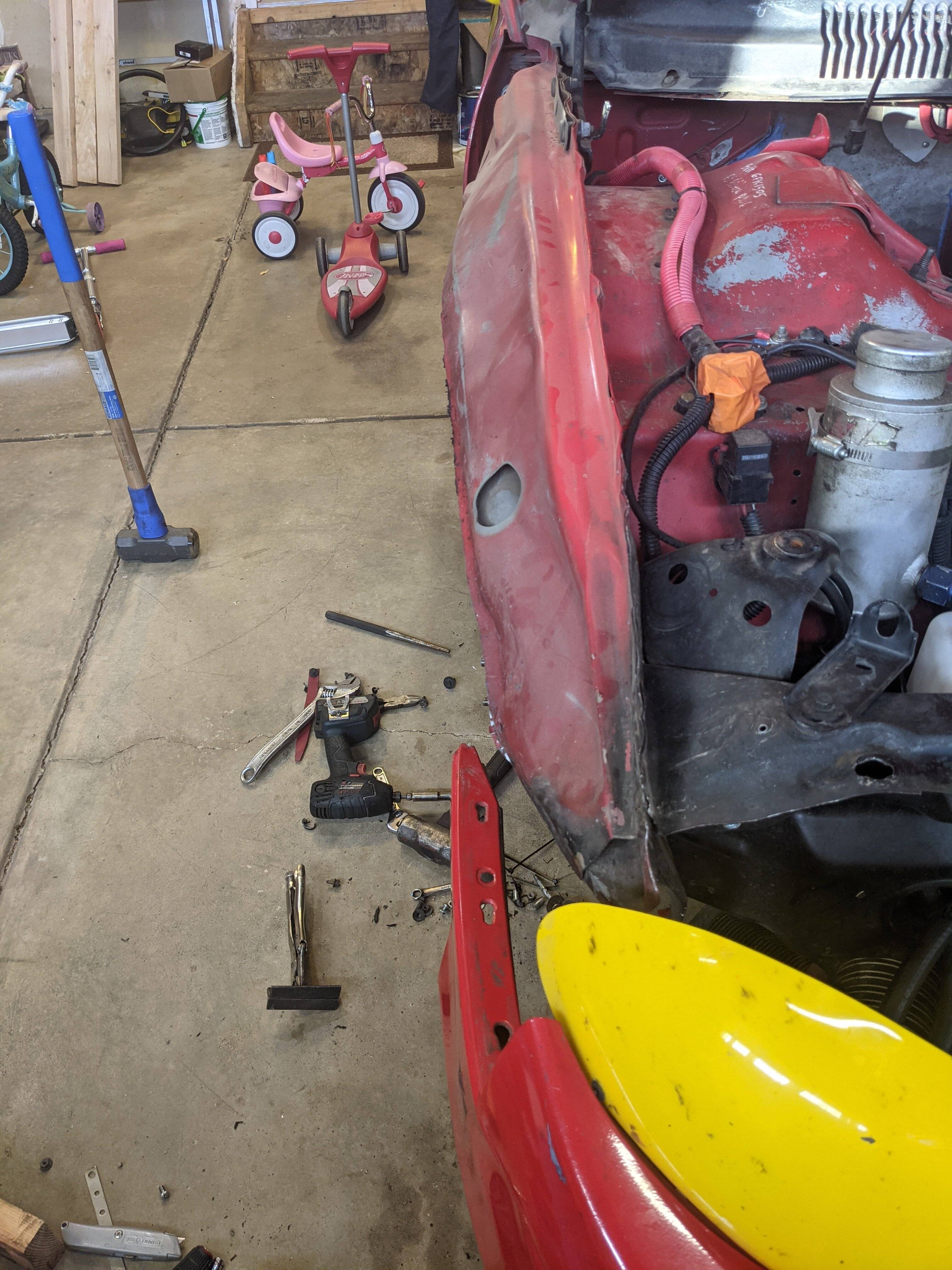

Aaaaand here's what I'm working with.
Looks to me like my eyeball 1/8" shift at the core support is pretty close to accurate. If I want to have a clean conscience with this thing I NEED to take it to a frame rack. This side has pre-existing damage and the ride height side to side has always been off. I suspect the right shock tower is hiked up higher on this side. Miraculously the corner weights shake out excellent so on the other hand maybe I should leave it alone?

I'd go full retard on the Camaro if it didn't drive perfectly fine after that hit. I went and biffed the metal back out to an easy 90%.
Good enough for government work. Time to hang a fender on it. Next is a copy/paste from my dually thread. The idea was to beef up the upper overload leaf pack initially, but then the truck decided to tear itself apart. Stuff got weird.

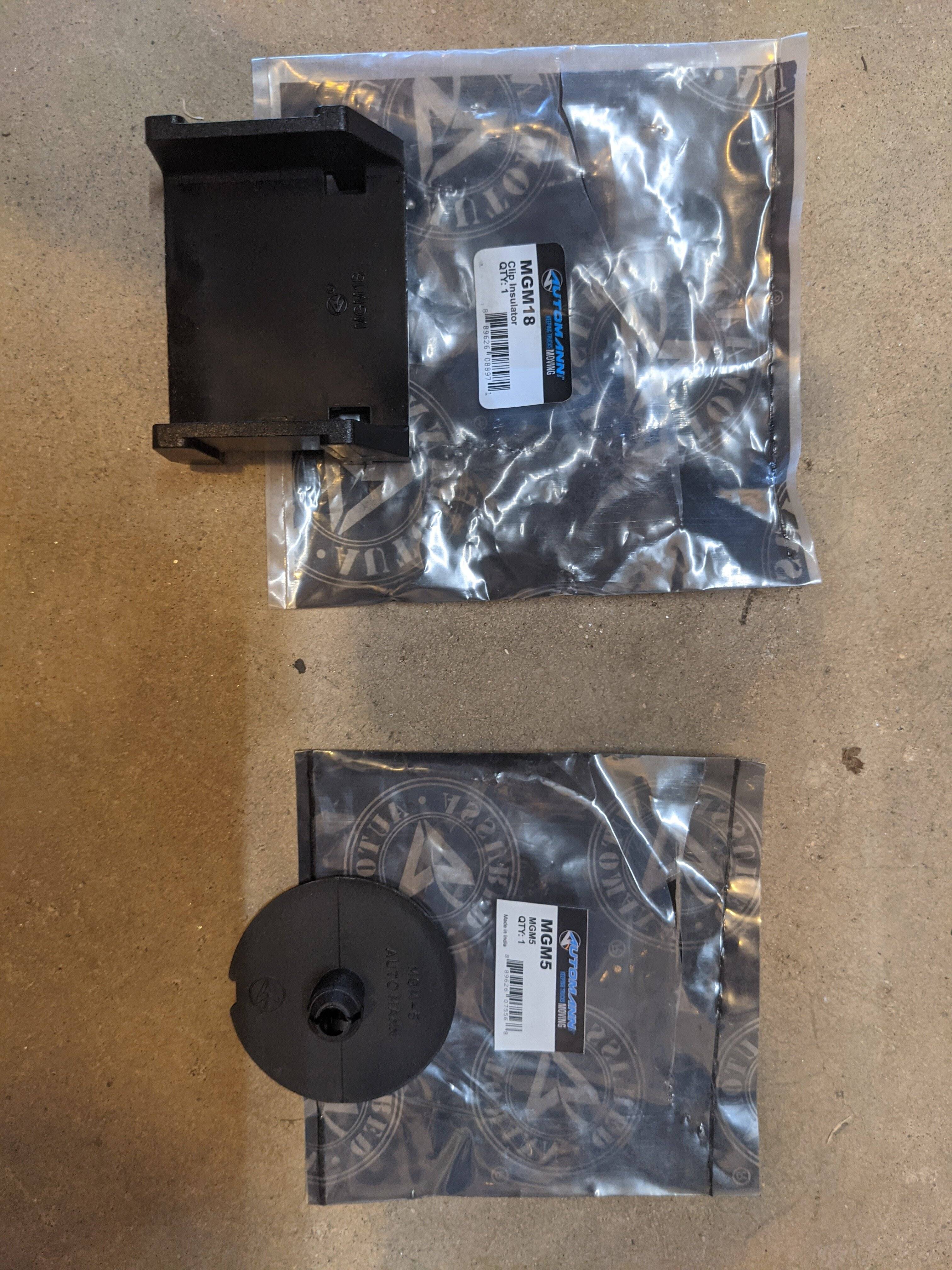

I got those leaf spring pads in.
I didn't have to break it to get it in. I think these are shorter than stock.

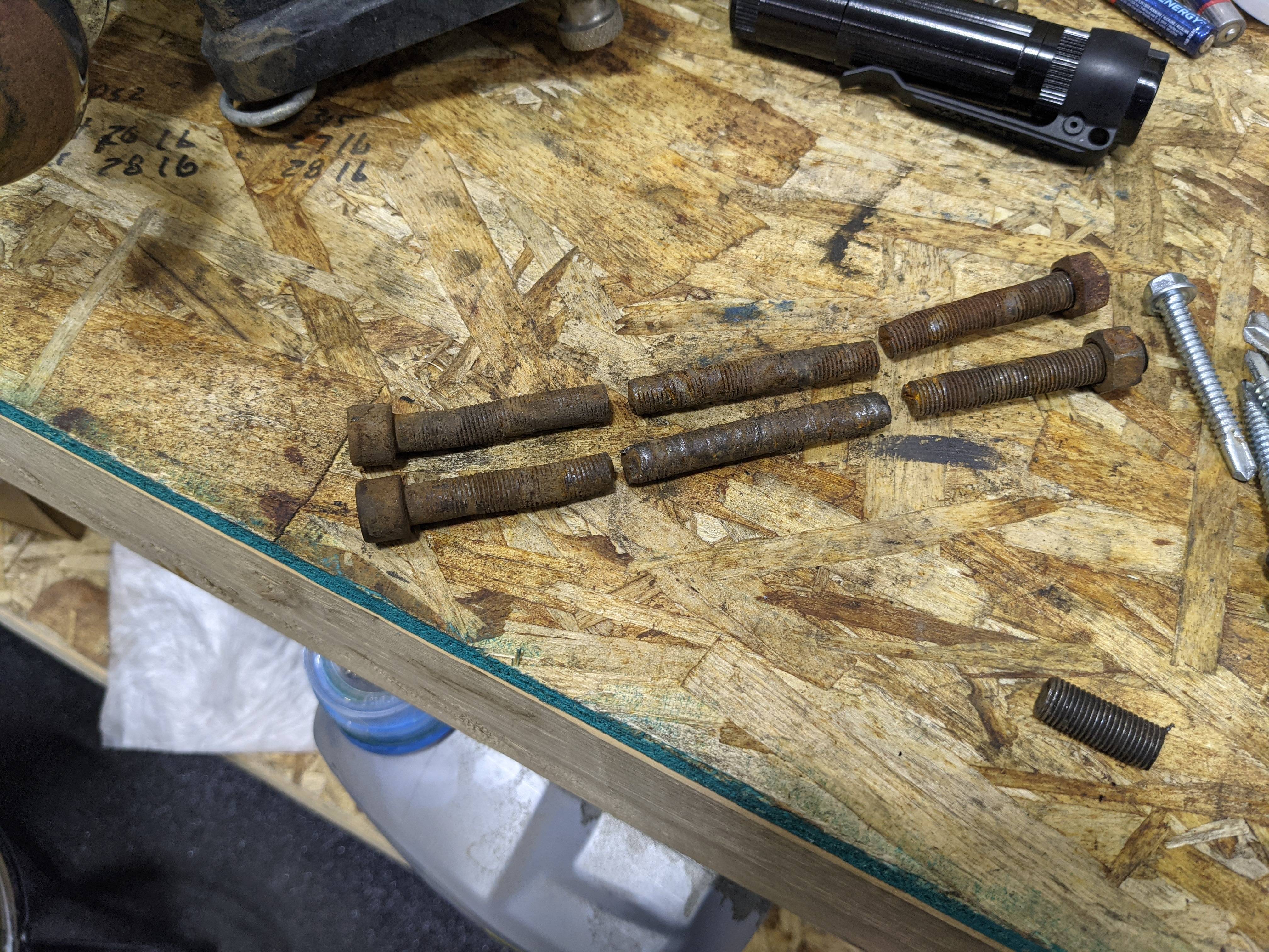

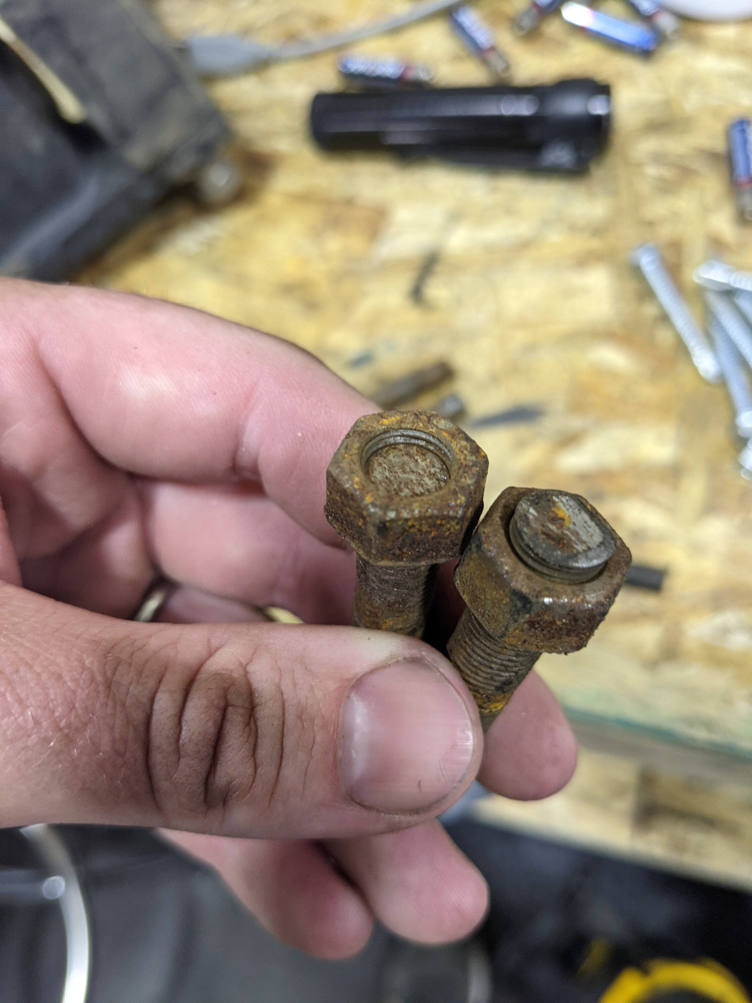

And it turns out BOTH leaf spring center pin bolts had snapped.
Looks like the one even started backing out.
