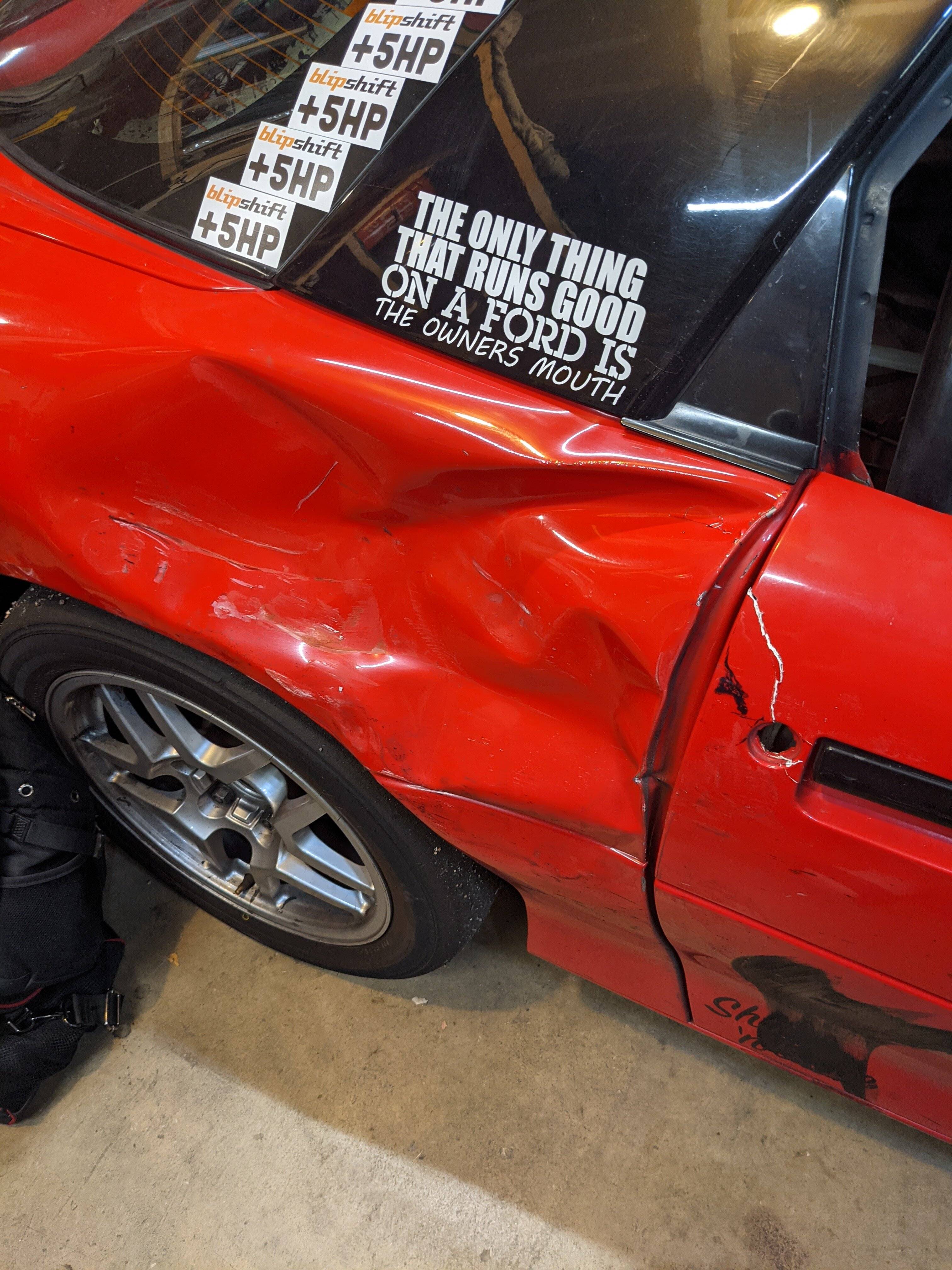

I kinda sorta fvck3d up pretty bad at my first race event of the season.
The Red Bull box covers 1 bit of my indiscretion.
It looks like I pushed the front of the car over, I'll know more when I yank that fender. Rear quarter got some too.
This takes me outside of my comfort zone. I'm not looking forward to dealing with it. My first thought is get a stud gun and pull the leading edge forward. Over the winter I could cut the majority of the panel out, flange a replacent, and zap it in. Again, well outside my comfort zone.
Damn. Sorry to see your car banged up like that at the beginning of the season. I think you need a donor skin. Flange it in there. Very strong. Good luck with the repair. Glad to hear about the positive progress on the brakes!

Borderline structural, and not aero affected = SEND IT!

I have black quarters on the wall and red quarters attached to a donor shell so I'm not exactly caught with my pants down here. I think a trip to the frame rack this winter is prudent.

Send is definitely the approach when the season is underway. My intent is something just half-assed enough to get me by until winter when I can perform a slightly less halfassed repair that at least makes it look halfway straight. Likely will involve rattle can base/clear from a real paint shop and the clear would be the 2 part type.

Half assed you say? Why not crimp a lip onto the edge of a piece of aluminum flashing, then use a good adhesive to glue it on? Thin enough to bend to the original contours of the surrounding metal, strong enough not to wind deform, can place a couple rivets inside the door jamb for added security, and will very quick and easy fix. Just a little glazing/spot putty at the edge to blend to original quarter.
Chain it strategically to a stump, then back up.
Been thinking about chaining it to nothing, locking a truck in 4lo, and seeing about moving the front end back over.

You bring up a good point in that the replacement bit may well correct what's left of the car.
