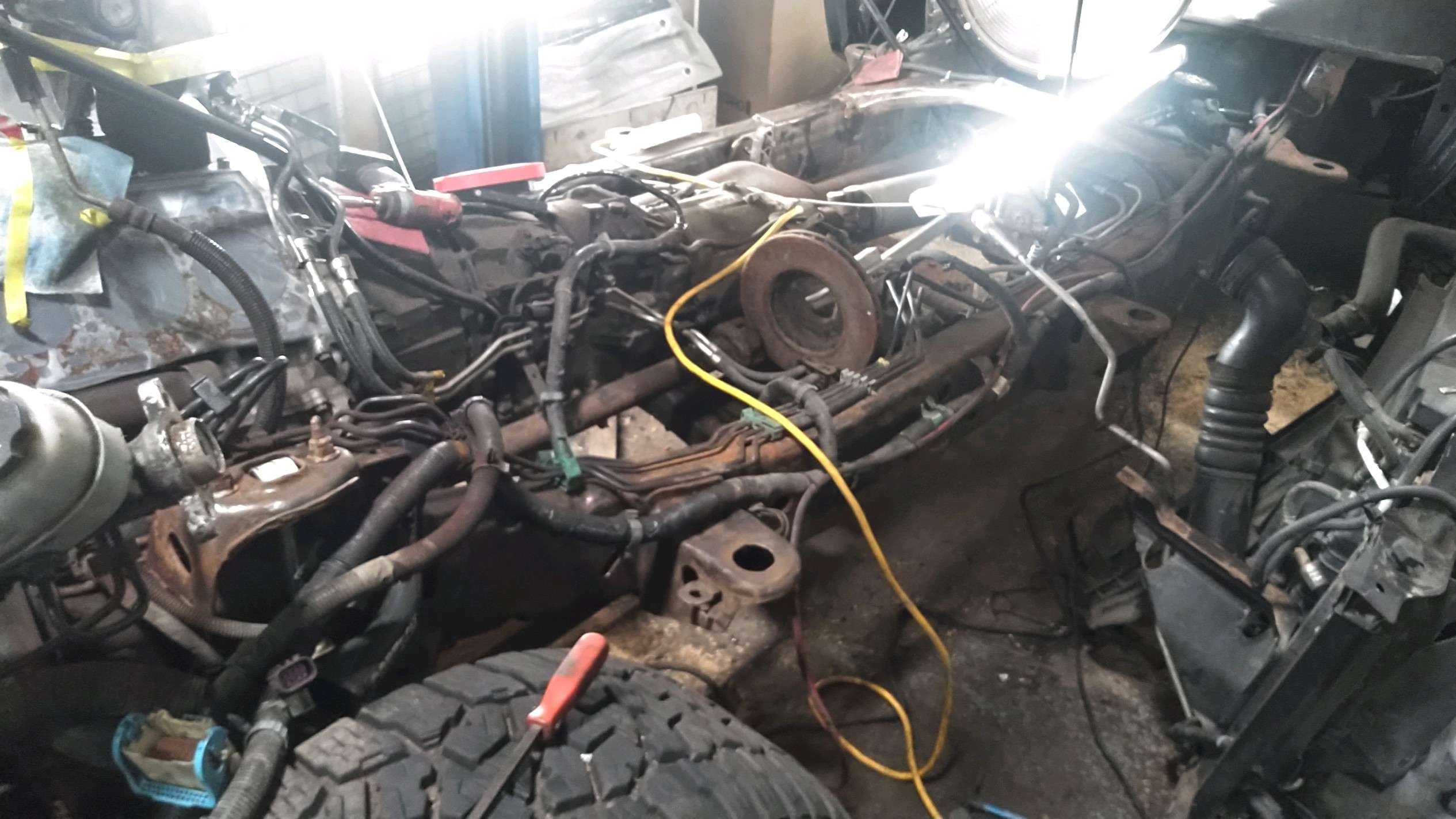

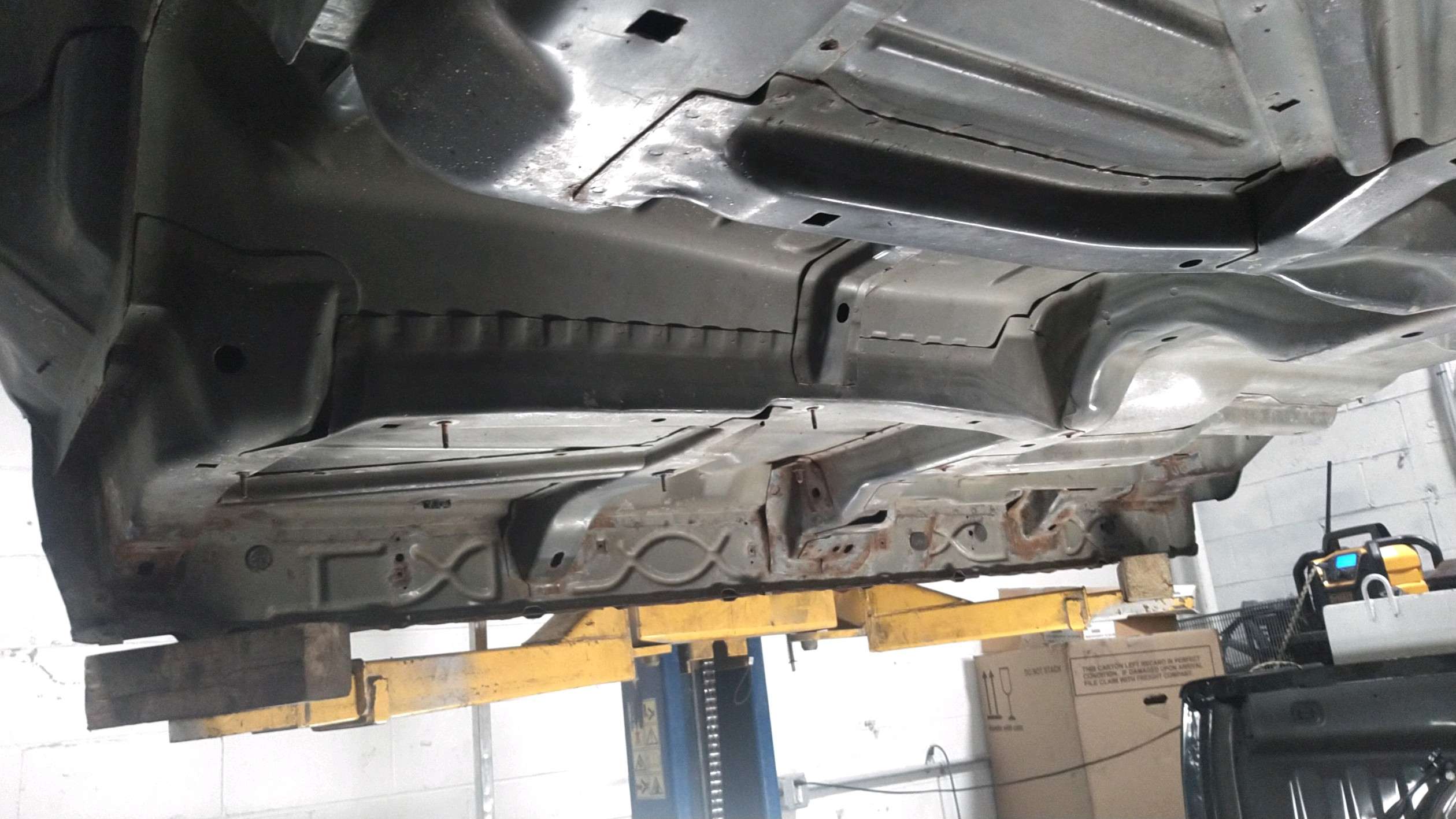

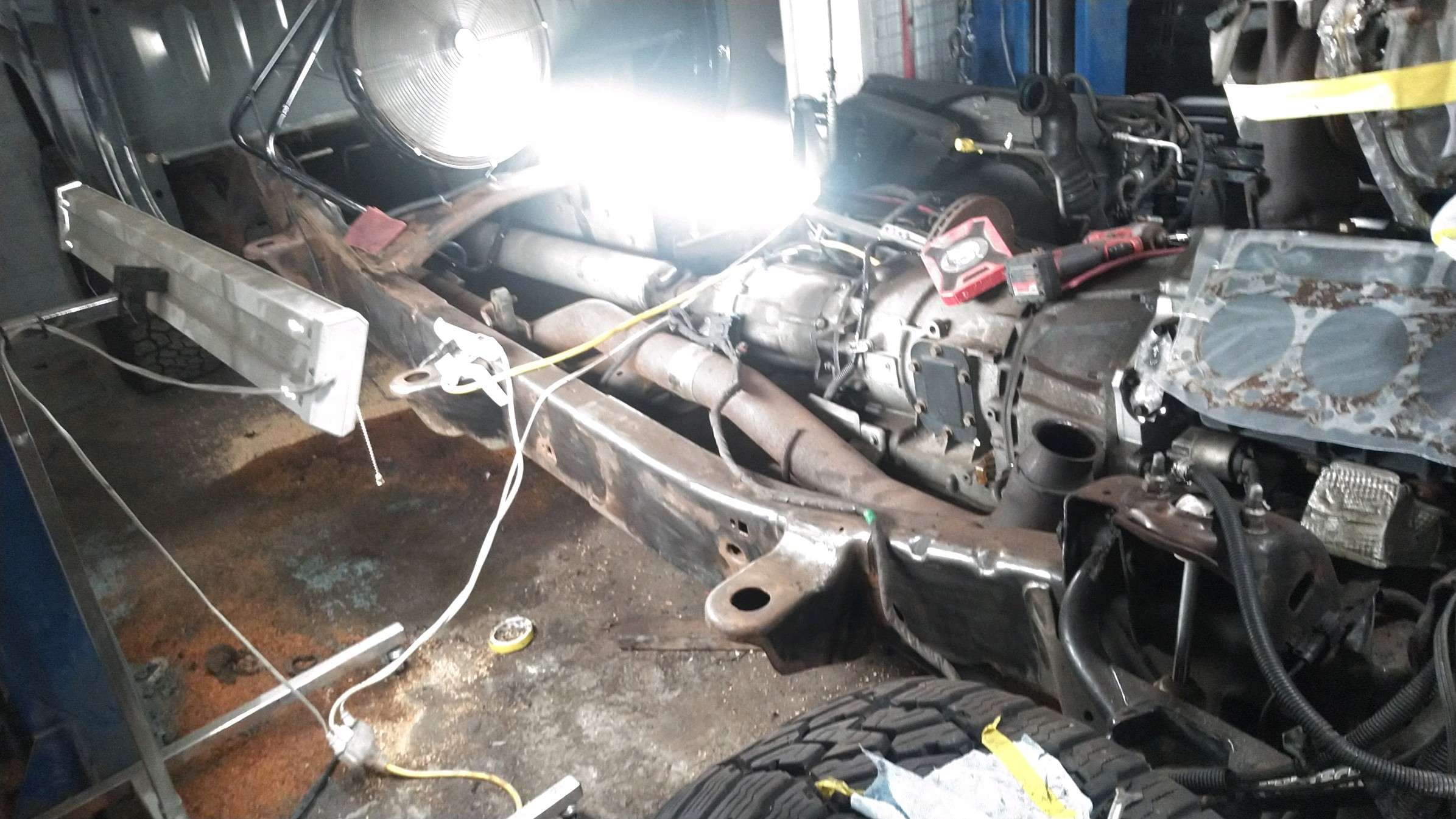

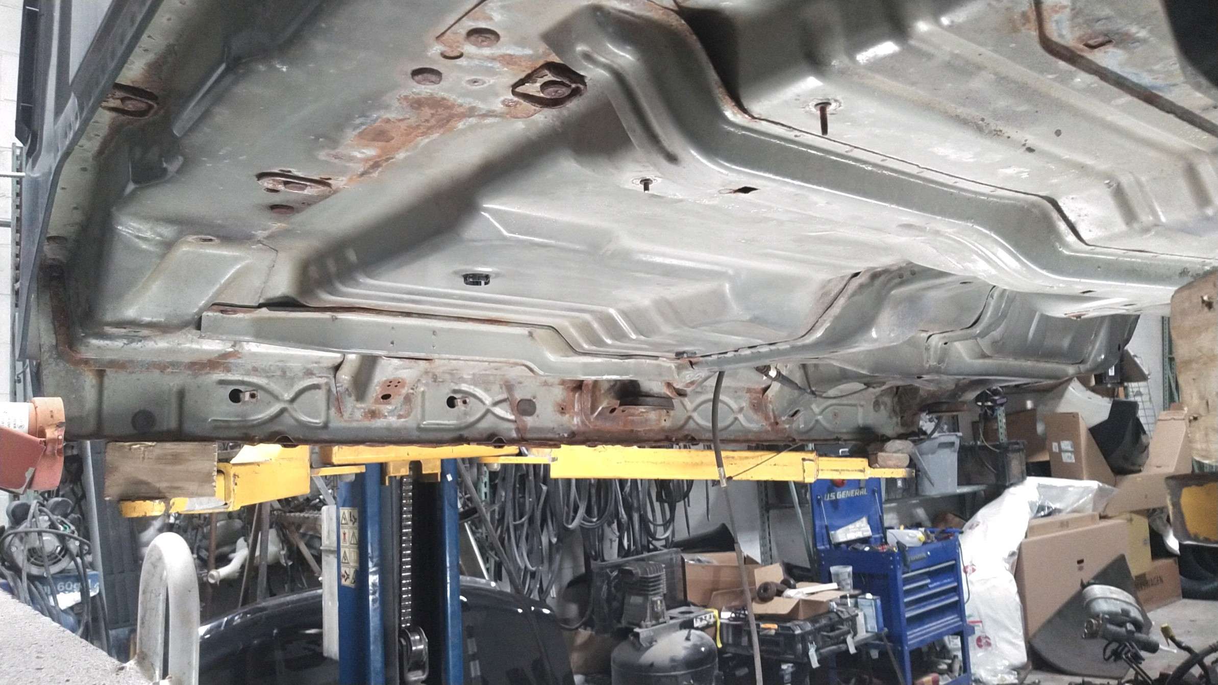

Truck update. I'll have my heads by the weekend. Tonight Leo picked rust with a welding hammer while I wire wheeled all the bad spots. Then he scuffed the bottom of the cab while I wire wheeled the frame and beat off scale. I'm not going to crazy I'm not pulling off all the lines and harnesses simply because I'm to deep in this thing as it is. I'm just making it better not restoring it. So the bottom of the cab is ready for Rust-Oleum rust inhibitor and I have about 3ft of the driver's rail and some of the cross members. So hopefully tomorrow after work I'll get all the rust treated and get it painted black.View attachment 203983View attachment 203984View attachment 203985View attachment 203986View attachment 203987View attachment 203988
It's definitely going to need a left rocker soon but it's not going to get done now. I'm just spending way to much money to start doing the body now.

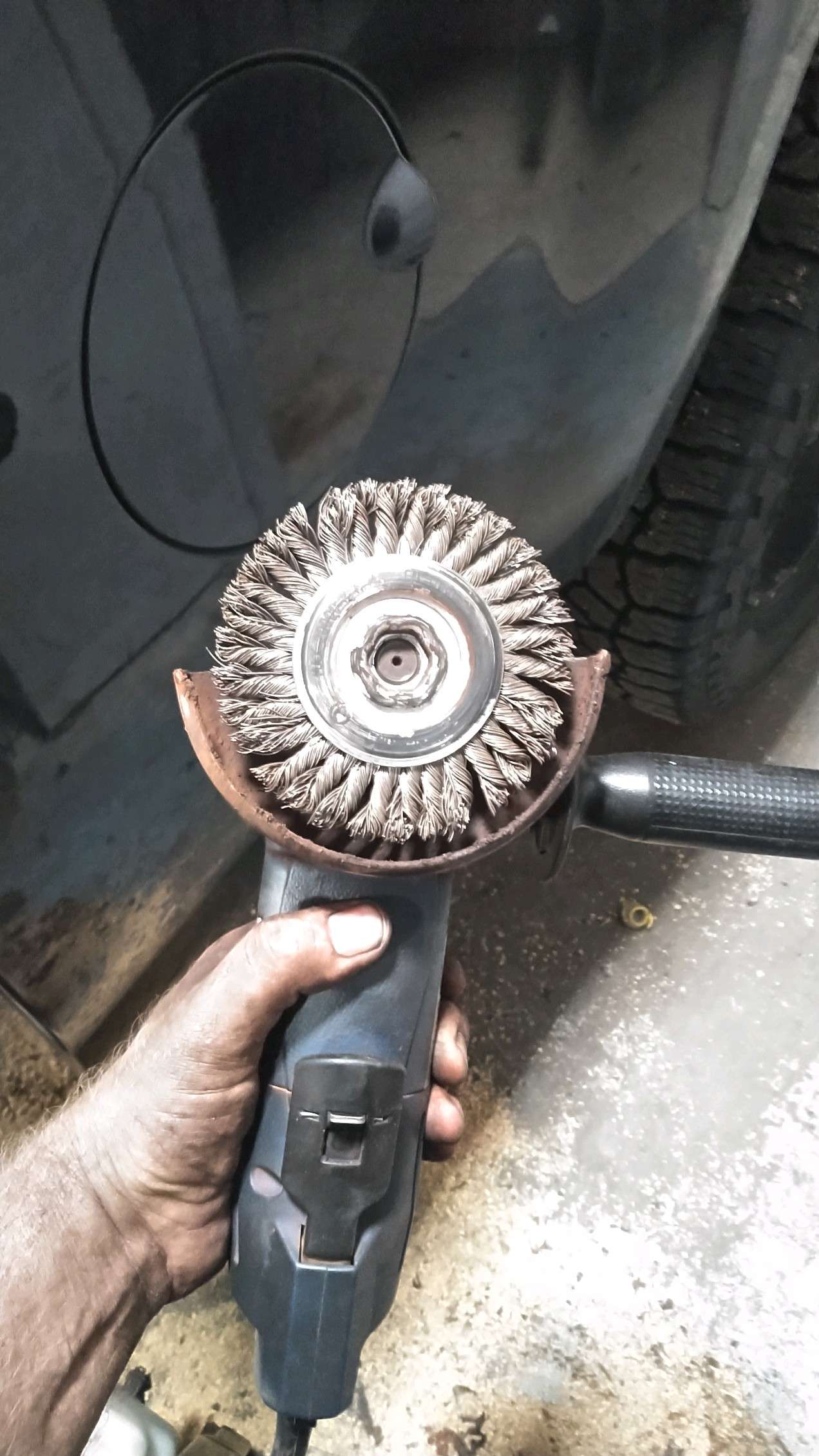

So these were my weapons of choice this eveningView attachment 203989View attachment 203990
The cup didn't work as well as the knotted wheel and there was only 1 small casualty. When I was doing the right rail in the back by the bed the wire wheel caught an edge on one of the frame brackets and ripped out of my hand.View attachment 203991
