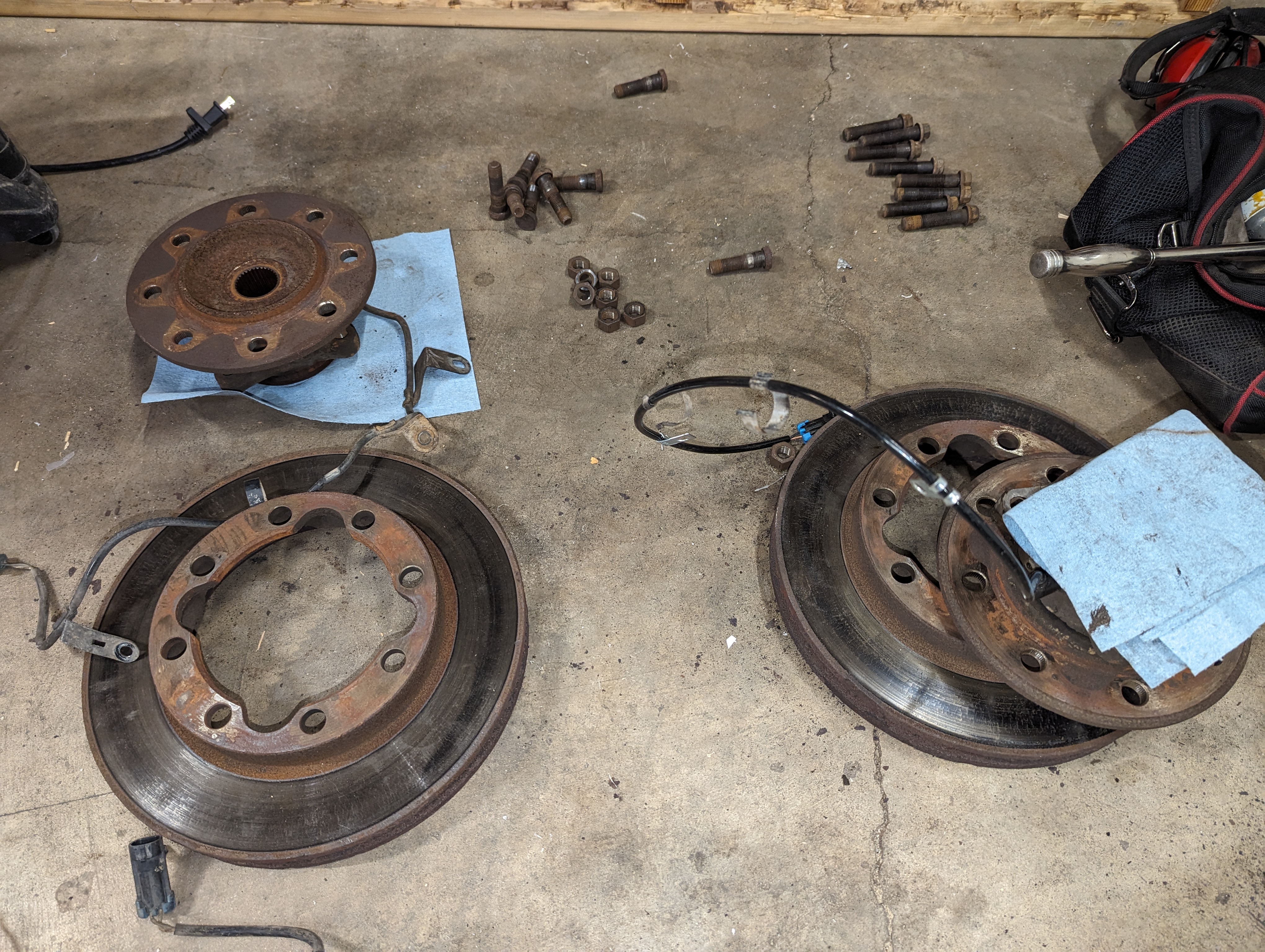

Yesterday I cracked into the front brakes on my dually. The steering wheel would shake when the brakes got hot, but no jumpy pedal. New one on me but OK. Fvckin GM in their infinite wisdom decided to take a simple job to the next level.
So after beating the ever living snausages out of these things I got them out at the hangar and brought the sub assemblies home to further break them down.

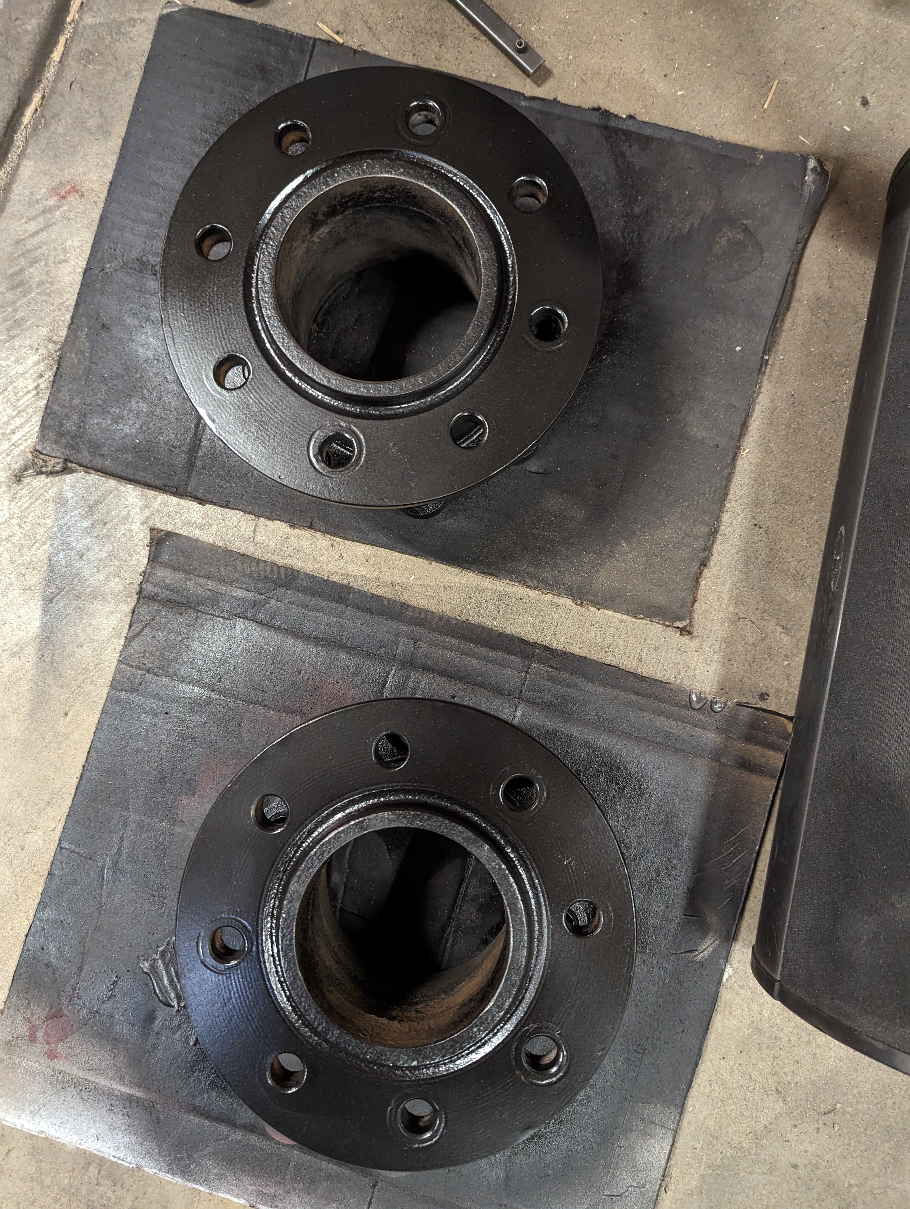

Not too shabby for a 97. After cleaning and painting the hub faces and wire wheeling the studs I got this.
Now that's more like it. Next up was the hub extender dealios.

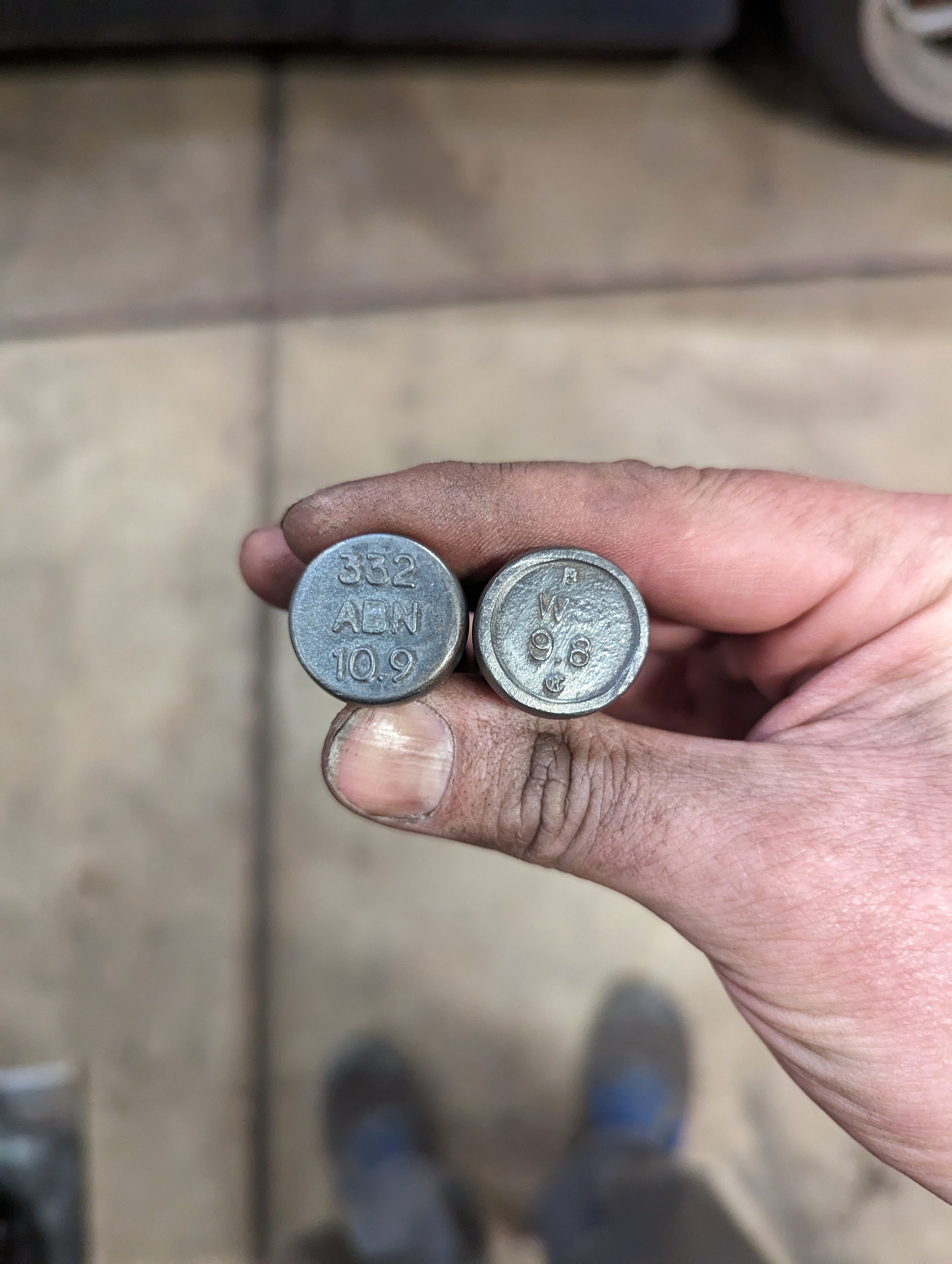

They cleaned up just fine too. I still have to knock those studs back in too, but while cleaning them up I noticed this.
I had 9 of the 9.8 and 7 of the 10.9. 3 in 1 wheel, 4 in the other. The 10.9 cleaned up better, so I'm led to believe that the 9.8 was factory. I won't be able to reinstall until Wednesday as the truck lives 20 minutes away.
Use the 10.9's if you can as they are the stronger of the two grades. Originally metric fasteners came in 8.8, about equal to grade 2, then 9.8, around a grade 5, and finally 10.9 which is supposed to correspond with grade 8.
The thing to appreciate here is that the cross is not precise in terms of rated strength. The other thing to bear in mind is that the harder the capscrew gets the more prone it is to snap rather than bend. You do get a higher torque tolerance value but the trade off for that is a loss of ductility. The last point is that, being wheel studs, the shown rating might be nominal and not honestly reflect the actual strength of the fastener. Given what wheel studs have to do for a living, strong is good, broken is not.
