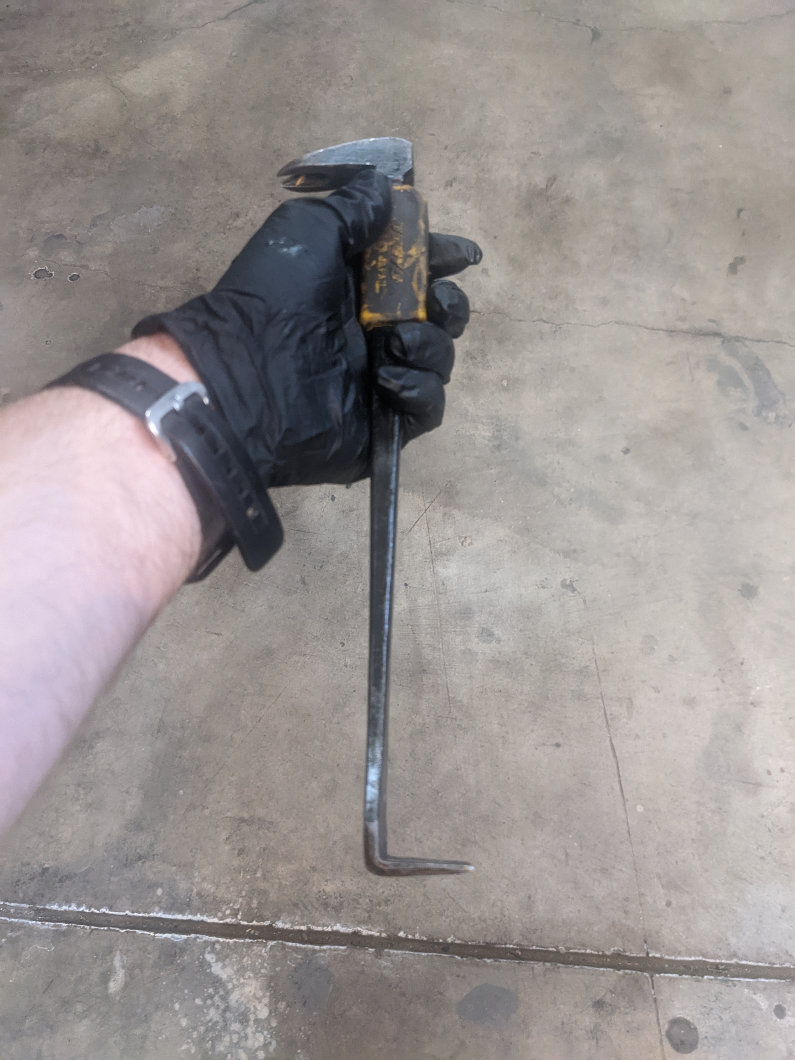

That 5/6 driven gear may need a puller to remove. So far I've gotten by with this and a heat gun.
View attachment 238536View attachment 238537
I'm able to get at it from both sides.
