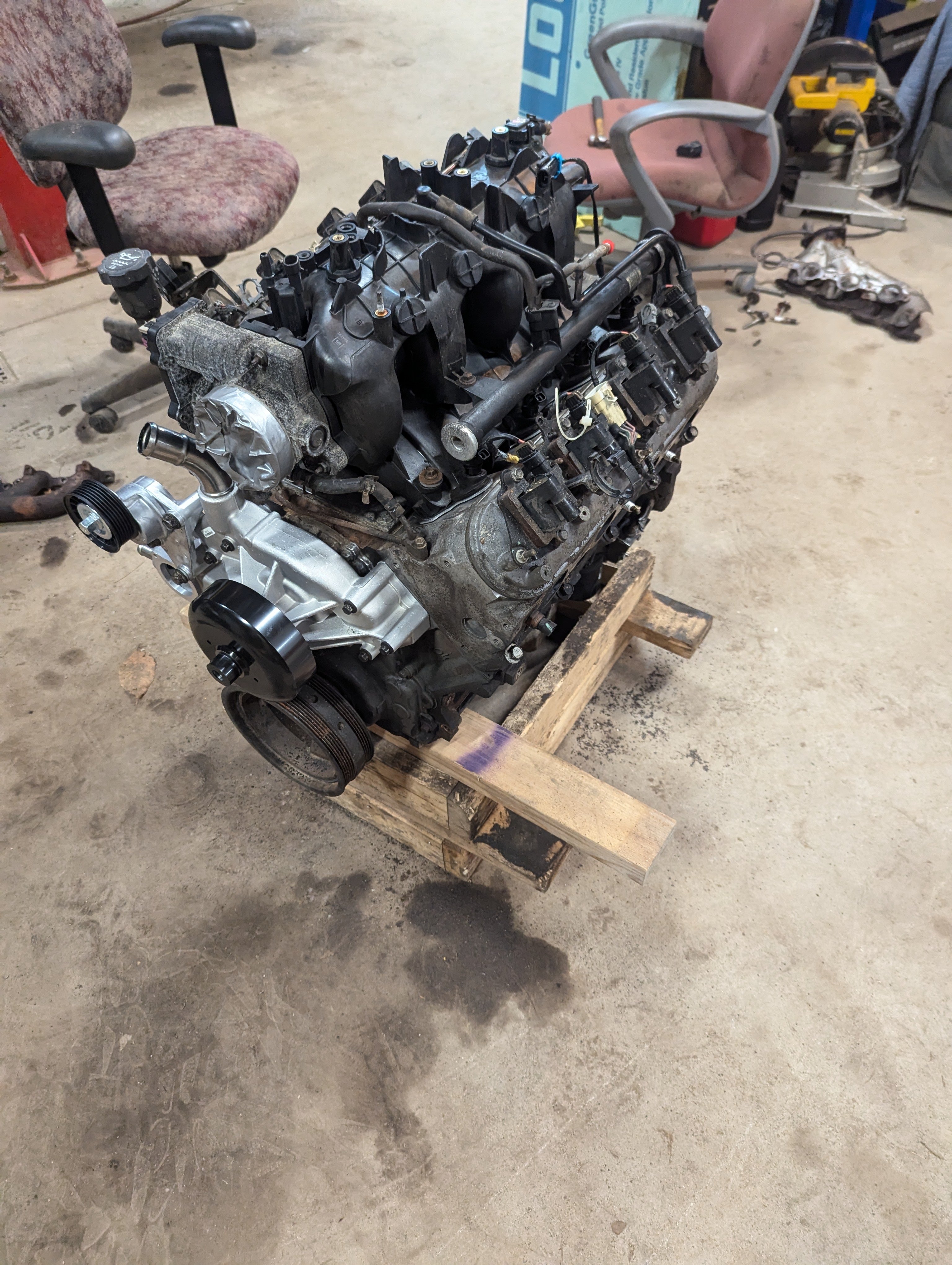

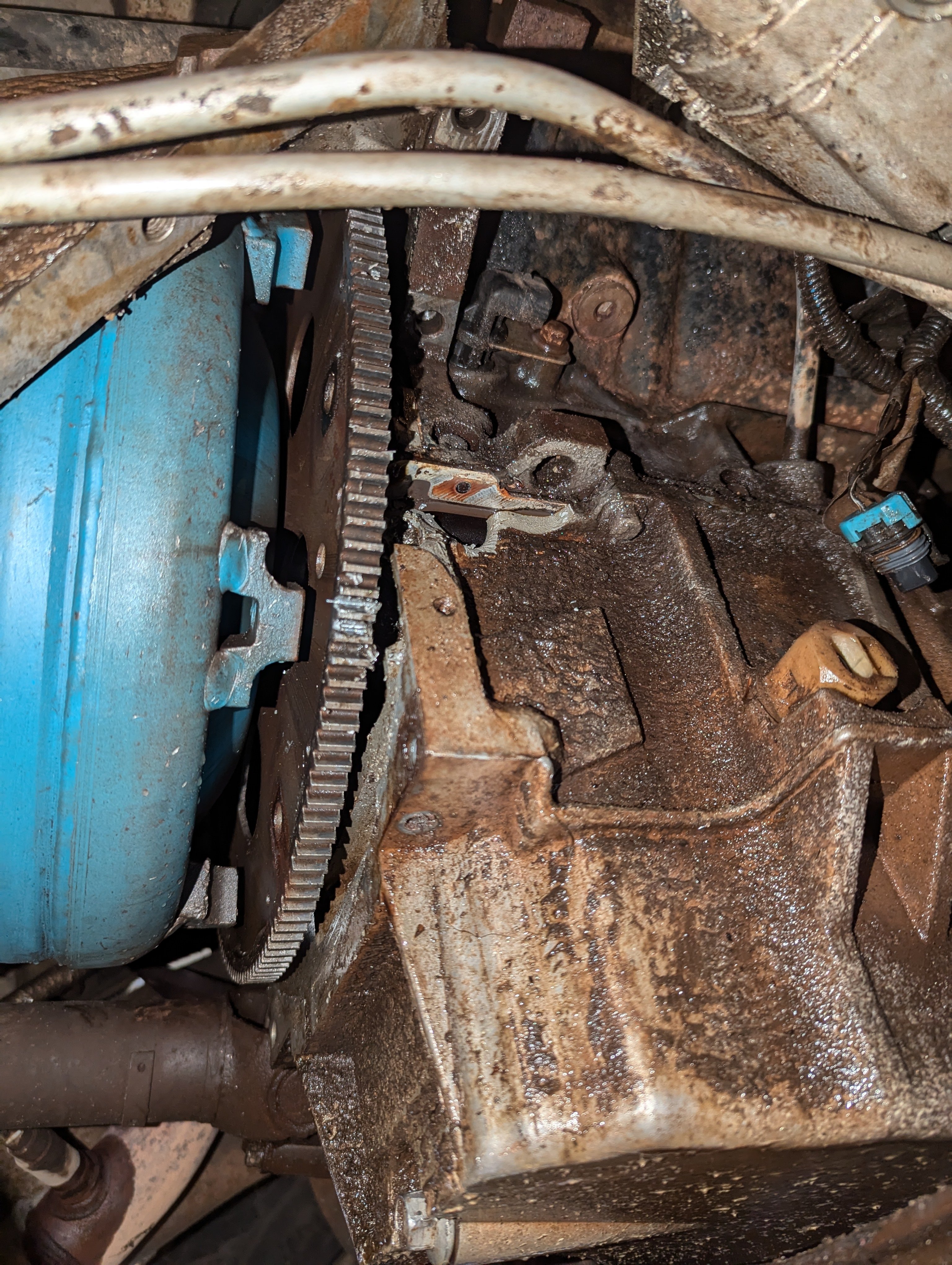

Set about yesterday to prep this LQ4.
To replace this LQ4.
Symptoms? It made a weird sound, Uncle shut it down, and it locked up and wouldn't restart. Plus it had a hole in the side of the block they said. Well oil pan, close enough. So I started taking it apart topside, moved down under, and when I got to the torque converter bolts there weren't any! OK, there were 2. Whoever rebuilt the trans didn't torque the bolts, 4 snapped off and got beat to death between the flexplate and the block/oil pan and ended up busting the corner off of the pan. Well F me, we're this close to yanking the engine, the replacement is lower mileage, all cleaned up with new parts, so we'll press and he can sell the LQ4 for a bit more than the core charge. Maybe to me, I've long wanted one to stick the 2.8L Kenne Bell onto.
Yesterday sucked, wasted a lot of time pretending to be a machinist. But all exhaust fasteners ended up being functional and now we just need a pair of heat shields for the manifolds as the old ones were rotten. Got the engine bolted back in last night and after work today went out and got it running. Has a cylinder 5 and 8 misfire. We swapped plugs (new) around, wires, coils, and the problem stayed put. Tried a compression check and a good cylinder came in lower than #5 so at this point we're leaning toward injectors. Dumped 2 cans of Seafoam in the tank and going to run it for now. You couldn't feel the misfire, but you could see the check engine light flashing. We narrowed it down with live data off a $350 scanner that seems pretty capable for the money. It sounds like I just won an LQ4 though so that's awesome. So long as we get these misfires licked.
