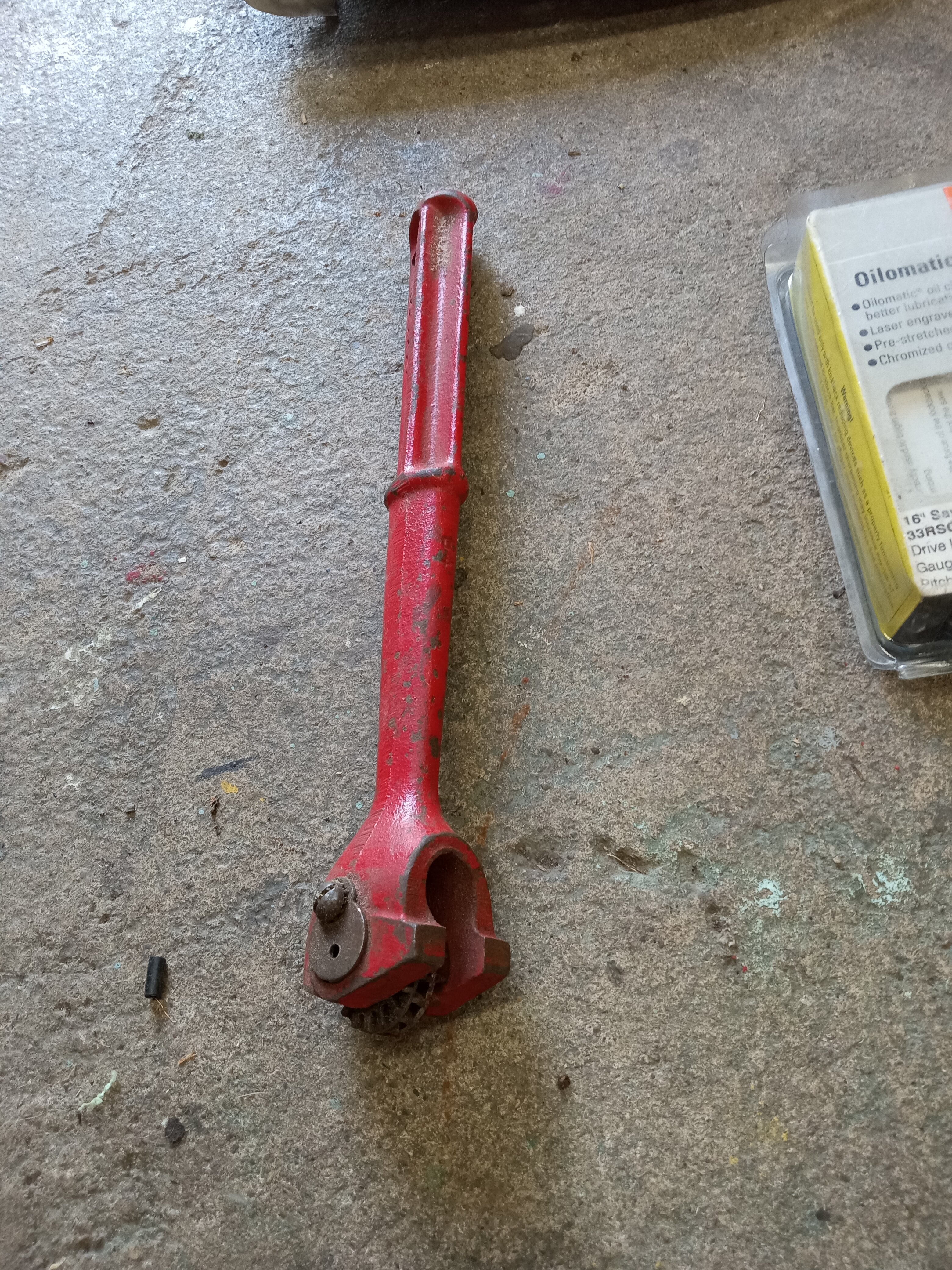

Anybody know what this tool is used for?

Neither Nor. It is the handle part of a grinding wheel dressing tool. The pocket is empty but the pin is still there so someone wore the cutting wheels out and never got around to scoring a replacement set. What it is used for is to true the face of a grinding wheel/stone so that when it is being used it takes material off the work being cleaned up evenly. The cutters ought to be available from any reliable hardware store or on line. Think they might be a Rigid part. As for the how of this; I have one hanging on a hook beside the shelf on which my grinder sits and it gets used fairly regularly to recut the grinding face on the wheel I am running. The cutting teeth are a wear item and do need to be replaced from time to time; about time for that to happen with mine, now that I think about it.
Almost looks like part of a chain binder, but I’m not sure.
The part inside is covered about 2/3's the way around.
I noticed this on the back of the head.
Someone else thought it might be used to true up the face of a grinding wheel.
That center part spins. Would probably spin that sucker apart if I put it against a grinding wheel.
